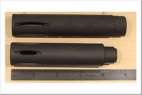

    Found this picture that shows the 4.5" and 5.5". The 4.5" being the genuine XM177 "moderator" and the 5.5" being commercial.

    That commercial one looks just over 5".
    Must be used on an 11.5" to avoid the tax man, then?

    Yeah, I don't know for sure however I did find that the XM177 "moderator" is actually classified as a suppressor and requiring registration and the "tax man"!
    That's true, even stated in the book, The Black Rifle, I think. That's why they had to stop shipping the little moderators out of country.
