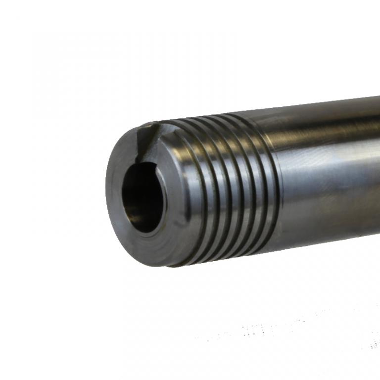

    . . .The barrels will be "short chambered" the same as the Kragicon barrels are. There is a raised collar of steel that is higher than the flat of the back of the breech around the chamber. . .
    The raised collar as described does appear visible in this Krag barrel image from Criterion's website -
    Maybe they should use a different term than "short-chambered" since the chamber is actually longer with the raised collar present than it would be after "reaming" some of it away. Perhaps "long-faced"?
