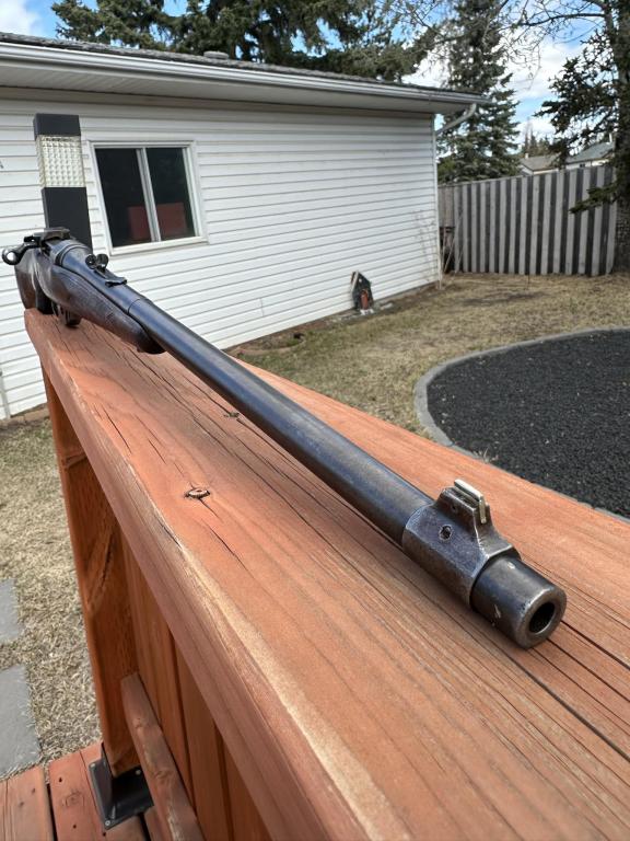

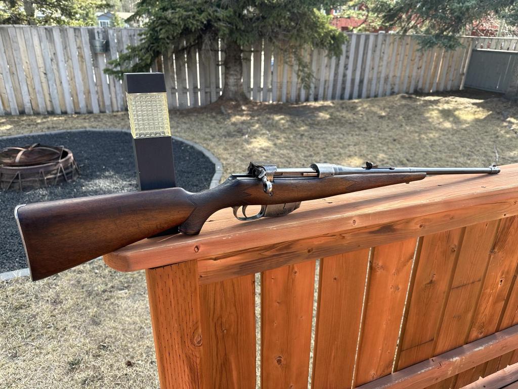

    Sounds good Alex. Something I did just notice is that neither of these has the DCP proofs as found on all of my other original factory sporters. They may be rebarelled, I'm honestly not 100 percent sure what's up with them. The 1905 has a barrel length of 21", the 1910 is 22". Neither has a factory applied serial number. But, that 1910 has definitely never had an express sight in that barrel channel, and that is 100% an E stock or custom ordered R stock with all the E features.
    Here's some photos. As noted, both rifles have had some bubba molestation. A lot of them here have been picked up due to unique features more than anything. If they stand out for some reason I'll usually take them in.
    Having photo hosting issues pls standby...
    Edit: I see the 1910 has the DCP proof on the reciever faintly. Nothing on the 1905 though.

    Couple of very interesting ones there Brandon.
    I`m not sure what the 1905 is, but it is definitely not an E. It looks a bit like a variation or maybe a prototype of the rare 1905-M 3rd type.
    This is the one that is only a drawing in the Ross Rifle Story. Dupuis thought it was just an experimental model as he had never seen one.
    There are a few around though as I acquired two, and have seen a few others. They do differ from yours, and all have a unique front sight only found on this type.
    Your front sight looks to be the same as a 1905-E, which could be correct or could have been changed when the barrel was shortened.
    They also have a rear hand guard and Harris platform. The rear sight and stock profile are the same as your rifle.
    I think that you pretty much have the M-10 figured out. It is either a R-10 with a special order late E style stock or an E ordered with R style rear sight.
    Is there anything stamped between .303 Ross and the receiver on the barrel?

    Oh….well then. Ha ha. That was not even remotely what I was expecting to hear about that 1905.
    It definitely is different. I’ve had probably 10-15 1905 actions and barrels split apart in the past. I thought I would try to replace that D&T’d receiver with a good one I have here, but it won’t work. It doesn’t index properly, it’s out about 30* to port side. I have never run into that before. It would make sense if it was some kind of prototype that where it ended up indexing was ok, but you wouldn’t expect that to leave the factory if it was a production rifle. There’s some restoring and fixing to be done with that one, but it’ll probably wind up with the receiver holes filled. The bore is fair and it should shoot well enough I’d think. Someone also welded the leaf down on the sight so that needs to be carefully addressed. I may rust blue it too. Or, I may just leave it exactly as is too.
    There is an R stamped on the 1910 between the 303 Ross and the receiver. It must be an R. Funny it has no serial applied but all the other Ross sporter stamps are present.
    The 1905 has none of the typical stamps. It has a circle P stamp on the LHS of the barrel where it should be but it’s double struck.
