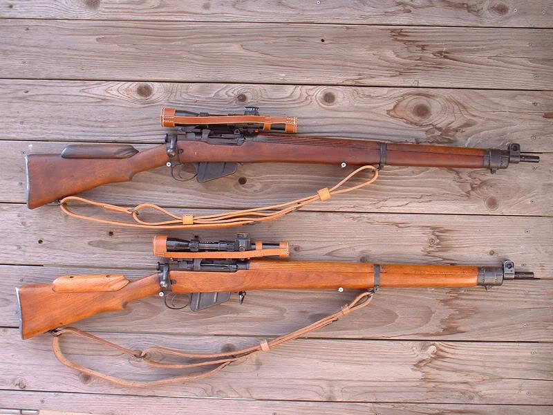

    12C top and 15C btm
    MJ, don't take this personally, but that's crap.

    Those two are very nice looking rifles. Are you happy to share there markings and location. Am particularly interested in any T stamps, S51 and scope numbers. Thanks
