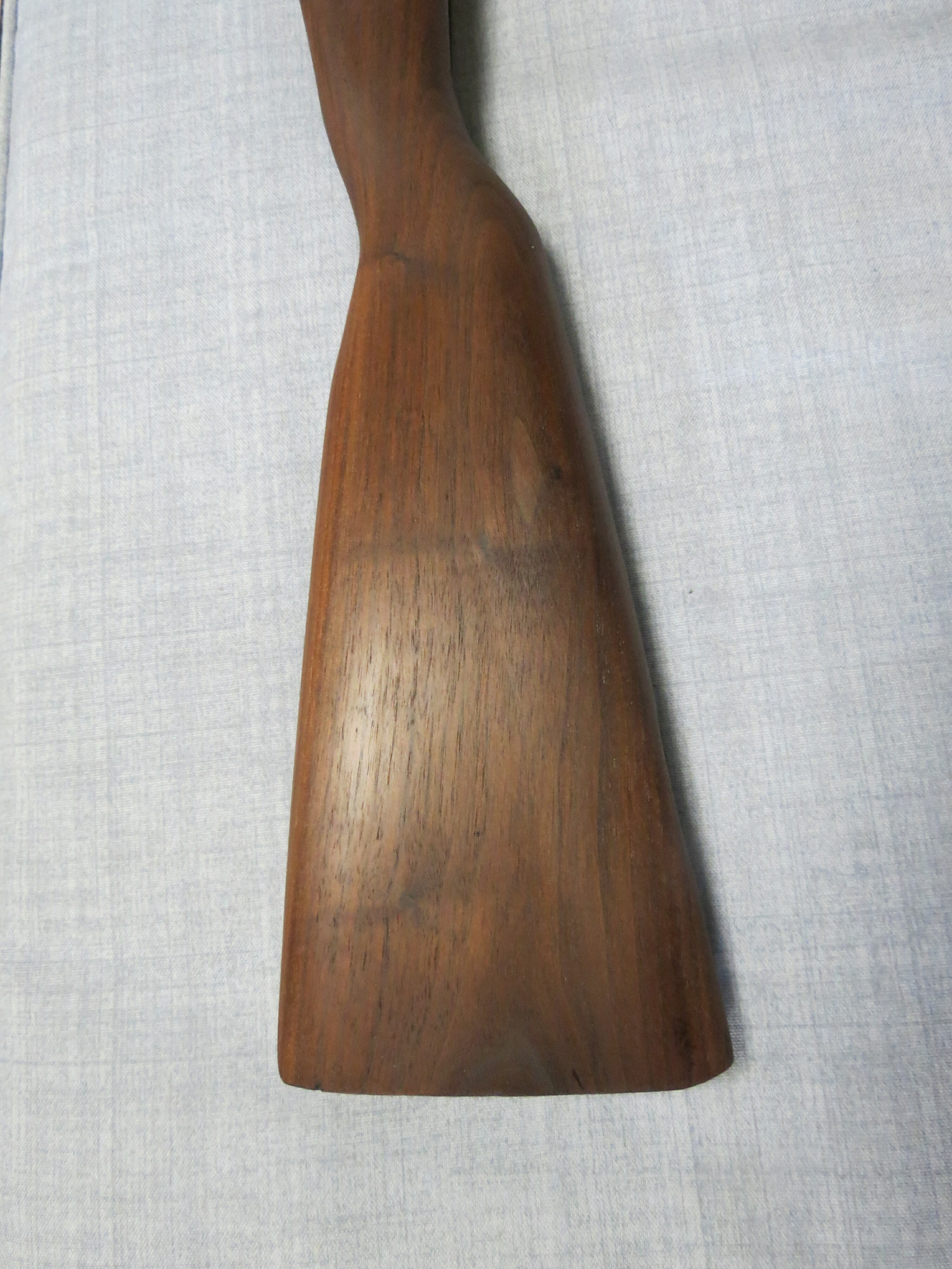

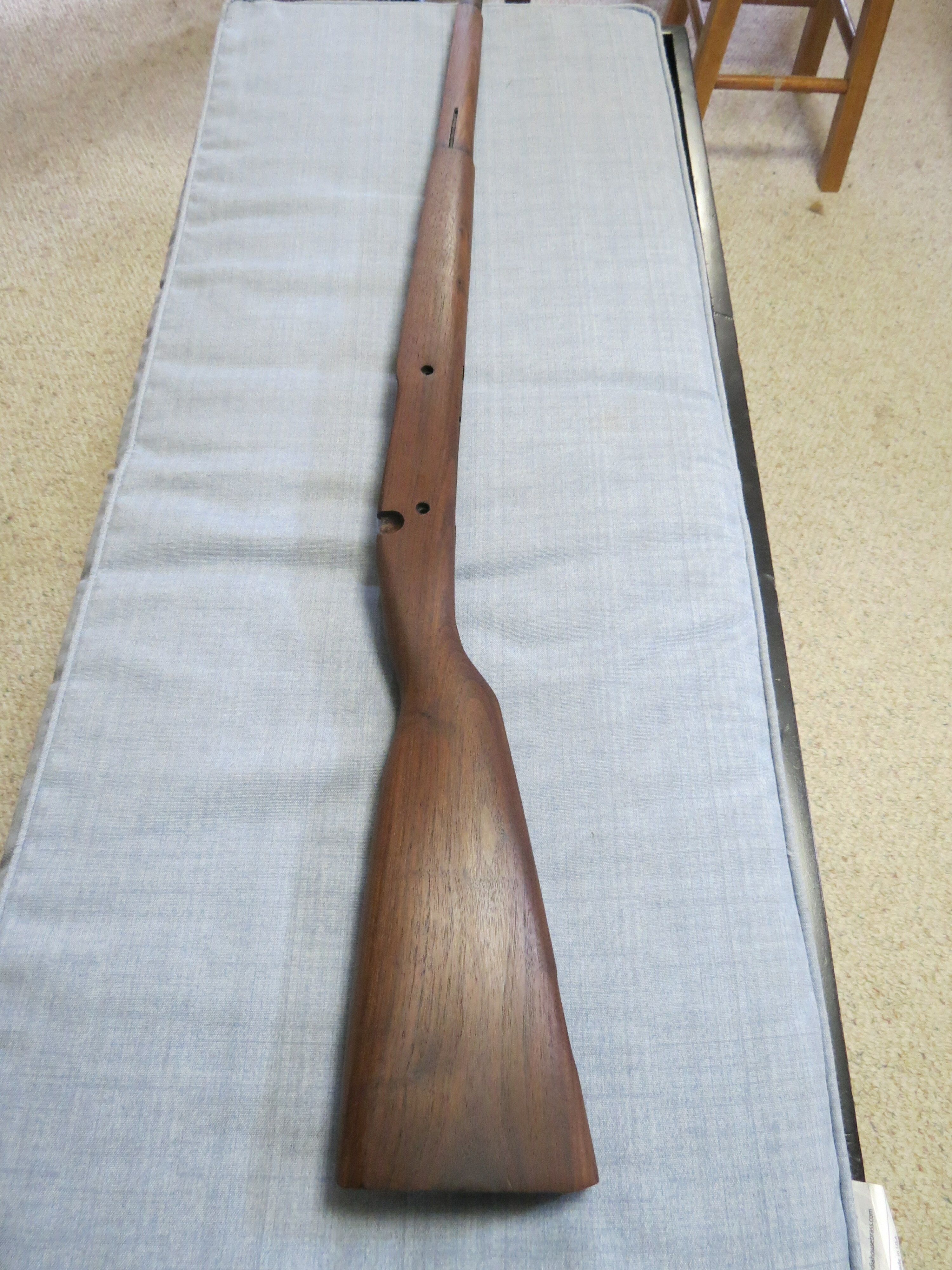

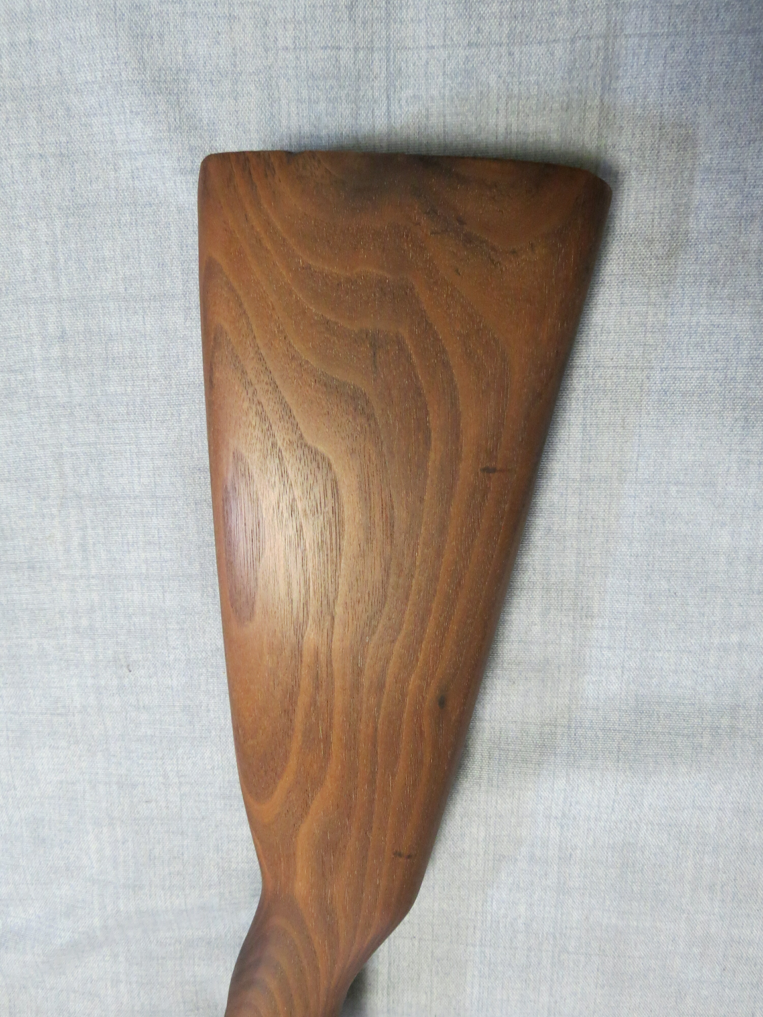

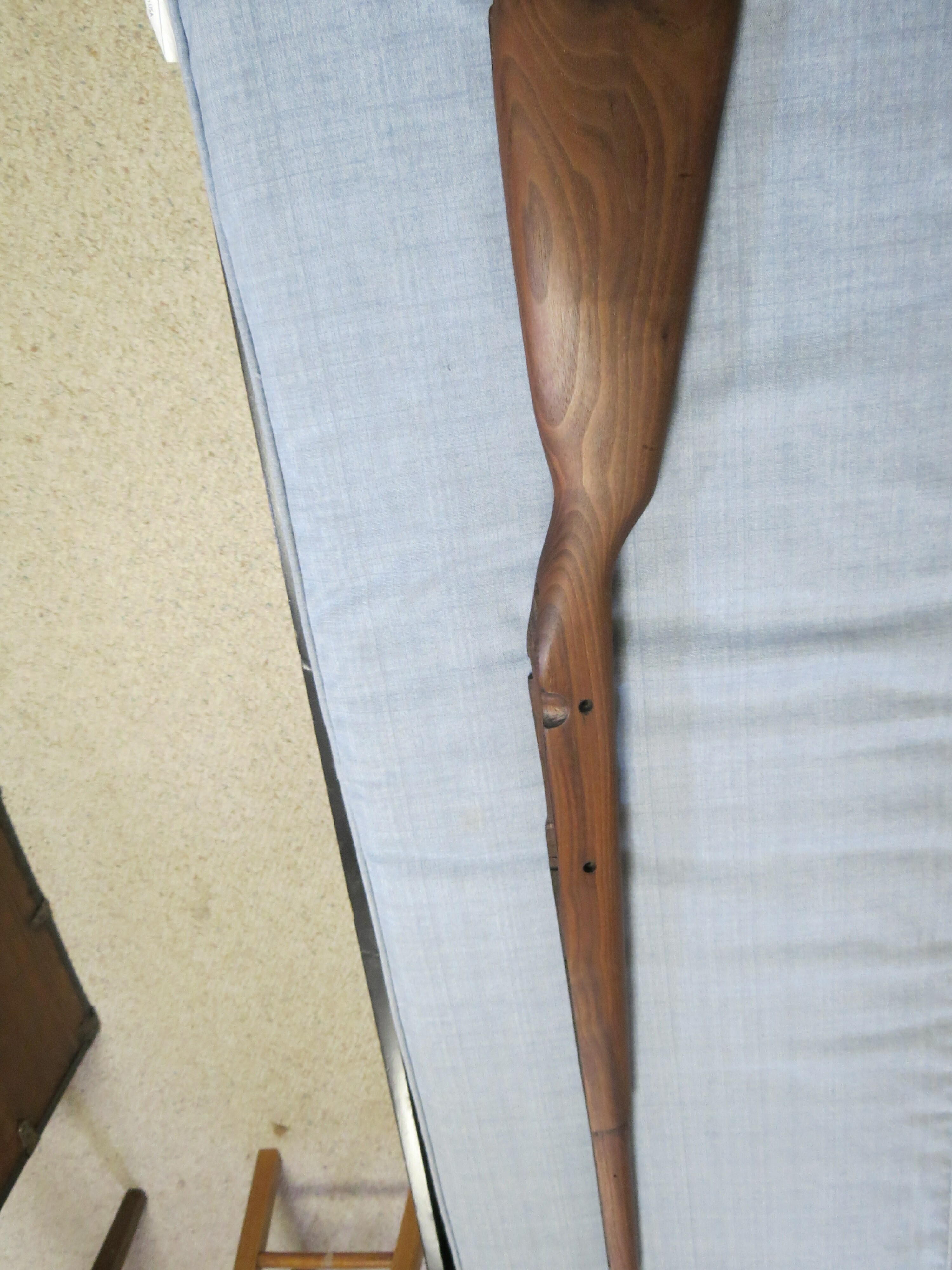

    Sorry folks. After the blackout I started digging for progress pics to add back in. I think I've lost most of the early ones. I usually take them on a phone, upload to my dropbox account to post here, then I periodically purge my dropbox when pics eat up too much storage. When I'm all done, I'll post a series of before/after from what I can recover.
    Been spending the last couple weeks working on the stock finish. Here is how it's turning out.
    The lighting is misleading. There is way more depth of color and grain contrast than what is showing up. I am very pleased.
    The handguard didn't turn out so well. After sanding it, and duplicating my process along with the stock...there is a streak of sapwood in it covering most of the rear right side, which developed no color and looks awful. Thankfully I have a few more NOS hand guards, one of which seems to be turning and will be just perfect in another week or so.
    For finish...I bought 1lb jar of alkanet powder on amazon. I put 3 heaping table-spoons in an 8 ounce jar, topped off with turpentine, and shook it up every day for a week, then strained in a coffee filter. I also made a second jar with alcohol. Color in the latter is very pronounced in just a single coat, but seems to sit on top of the grain. The turpentine stain takes several applications to reach same depth of color, but penetrates deeper. I'm no expert, but I would describe it as added depth, nuance, and complexity over the alcohol stain. It has a more natural look to it. I did maybe 4 coats? drying for an hour or two in between.
    The next weekend, I went to the porch and heated up a quart of raw linseed oilicon to 460ish F, held it there for 20 minutes or so, cooled and strained out the couple insects that decided to dive-bomb the pot and fry themselves. I mixed this 1:1 with my turpentine stain to create a red oil, and oiled rubbed it in liberally daily last week, letting it sit for a couple hours before wiping off the excess. Now I'm rubbing in straight raw linseed oilicon (well, the stuff that I heated up). Pics above are after two iterations, on two consecutive days. I'll rub some more on in a weeks time, then let it cure before assembling. I need to grind down/fit the tang bushing, and rust blue the cross bolts - of course I need to figure out how to finish the bolt. It's mostly in the white still from bubba, save for the grey patina on the knob and some scattered etching and light pitting. I'm thinking of rust bluing it at some point. May just polish it mirror bright for now for a little flair. Oh, and don't let me forget to finish ream the chamber after lapping lugs!
