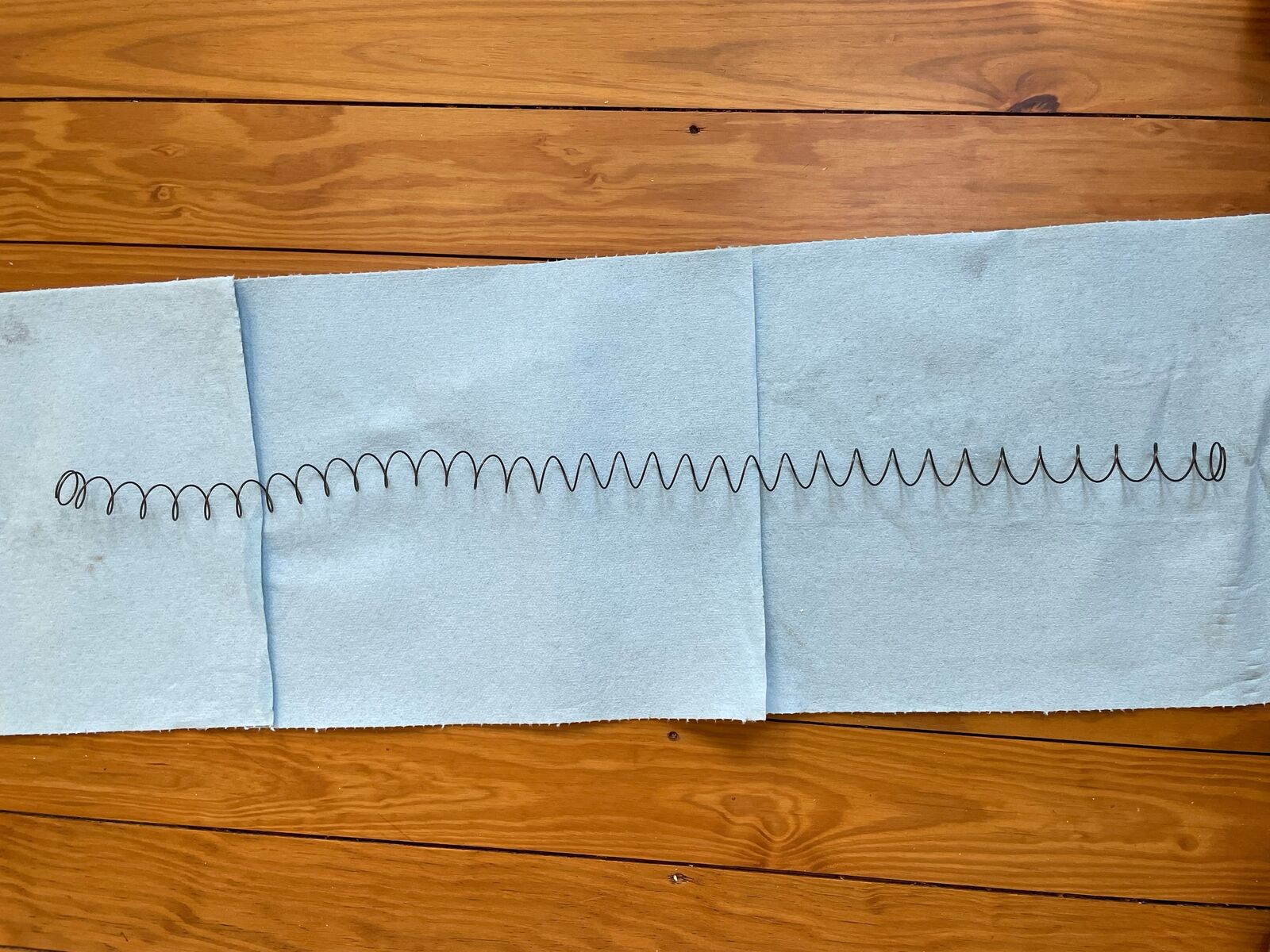

    New mag spring
    Is this 12 Ga "New Factory Original, Vintage" spring OK to use ....? The eBay seller laid it out sorta straight after a request.
    I need a replacement....

    You only need enough extra spring to get that last single shell to feed reliably. Were not talking about a luger that you use a tool to load the magazine because of it’s heavy duty spring which is needed in order to get rounds to feed fast enough to run the exceptionally fast toggle action.

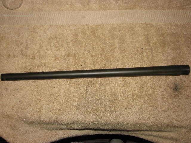

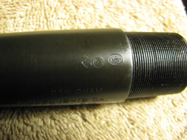

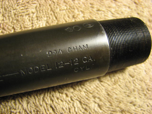

    M12 riot barrel
    A friend of mine didn't want this Riot barrel and offered it to me yesterday for a price I couldn't refuse. It has a clean parked finish, "CYL", bore ordinance stamp and 1940 mfr date. Bore is mirror except for a small apparent rust spot inside....I guess I'll have to start looking for the rest of it now.

    I was always under the impression that M12 barrels were very difficult to change out and fit to another recvr but also required special Winchester tools and M12 parts to fit to a different recvr. I’m obviously not a gunsmith and could be wrong, often am.

    Yes sir, I'm from what I've seen online, it would require a gunsmith to attach a receiver extension to the barrel properly and with the equipment or tools.
    The barrel was too good to pass up and so far I've just been reviewing replacement extension options and prices. Something might turn up somewhere.
