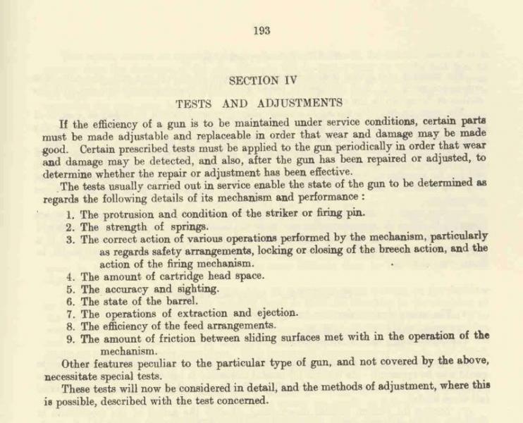

    What Amatikuluicon is saying is a bunch of Americans arguing about oil or grease on cartridges isn't going to solve a Britishicon problem.
    The bolt thrust differences between wet and dry were published in the "Textbook of Small Arms" at the turn of the century.
    The Enfield Rifleicon is not going to explode if fired in the rain or if you grease or oil your ammunition. The "Textbook of Small Arms" says "if the action is not to be strained".
    What is going to increase strain and head space faster, a wet or dry cartridge case, and WHY do you think there are so many warnings about not doing this.
    What our British and Commonwealth forum members need to do is inform the writers of the critical articles that the Enfield rifle was tested with an oil proof cartridge to simulate a wet conditions and the Enfield rifle survived 100 years of shooting. (its the bolt body, bolt head and lug recesses that are "strained" with the resulting increase in head space)
    It's not age, its the mileage that counts.
