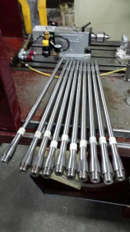

    I was able to visit Criterion Barrels on the way home from work today ... and had the fortune to take a look at the new No.4 Enfield barrel prototypes ... they're looking good!
