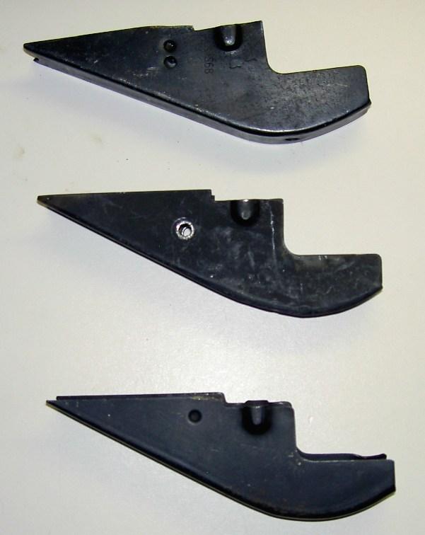

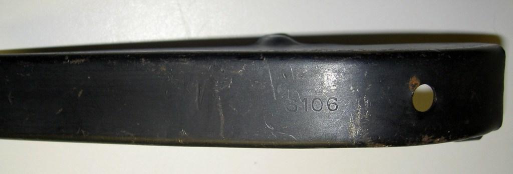

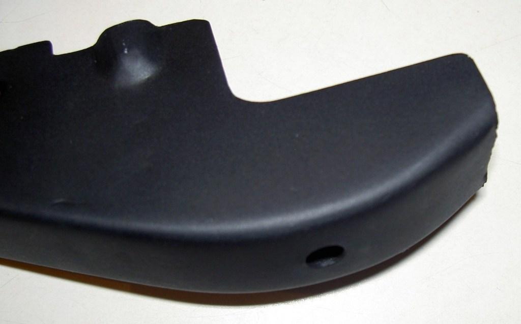

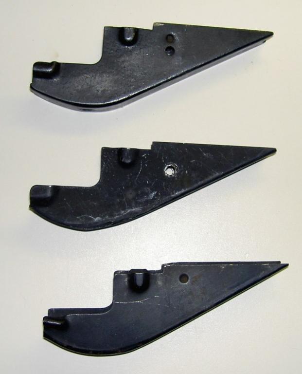

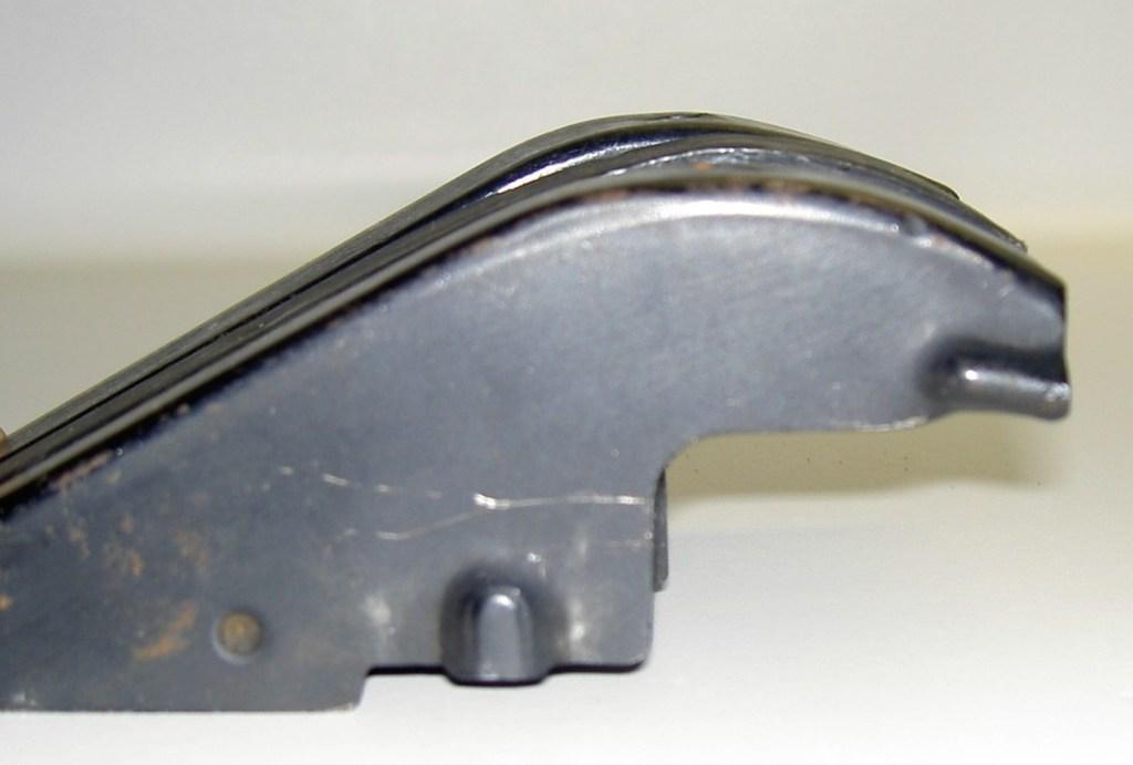

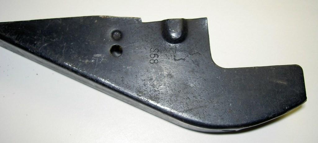

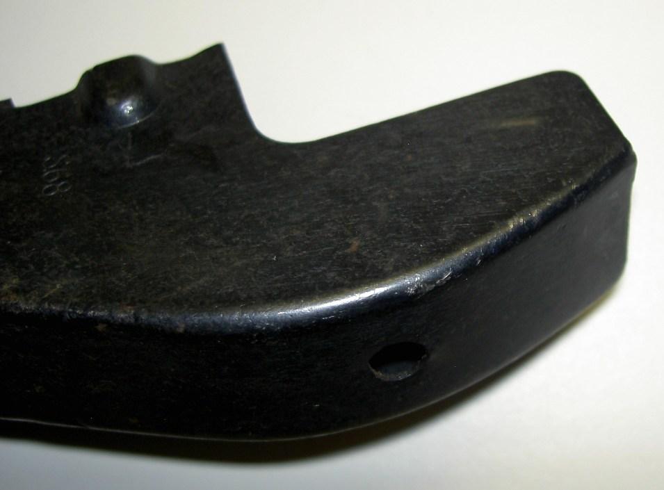

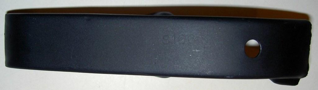

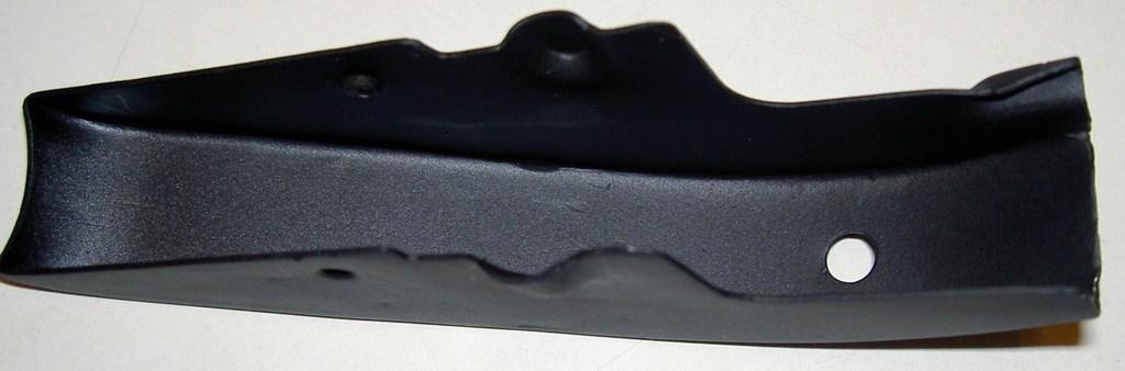

    Here are some pictures of three covers that are in my Sten parts bin.
    The top one is marked “S68”, the center one has a C with a broad arrow inside and the bottom one is “S106.”
    The S68 (Lines Bros Ltd) is welded at the back. The outside was linished, making the join hard to see. It looks smoother than the LB marked cover.
    I believe the "C broad arrow" is the Canadianicon Government property mark. It is welded at the back.
    The S106 (Spear & Son) is like the ones you have, stamped only.
    All three are slightly different. The S106 is closest in the picture. It has a larger radius at the back than the others.

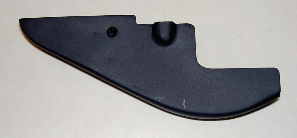

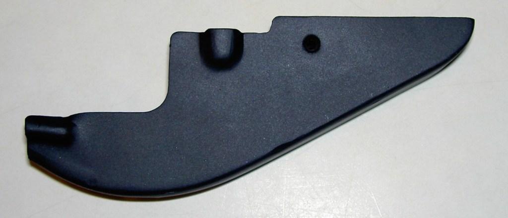

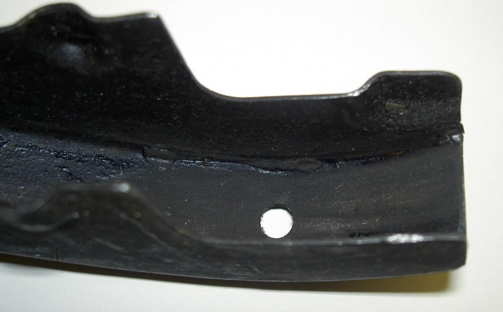

    The LB marked cover.
    Compare it with the S68 marked cover, and you can see there is variation at the same manufacturer.

    Yes, it’s a fourth cover. It’s also in post #50.
    Lines Brothers used their initials or their manufacturer’s code, S68.
    People often mistakenly think the LB stands for Long Branch.
    Lines Brothers was the only manufacturer of the Mk3 Sten. The LB cover belongs to a semi-auto Mk3 I am working on. I have two other semi-auto Mk3 guns and their covers are also LB marked and made the same way.
    Here are some pictures of my Mk5 cover. It has been refinished but you can still see the S106 (Spear & Son) code. It is made like their Mk2 gun cover, stamped only, no welding.

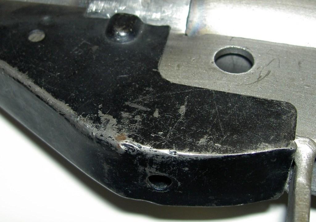

    Sorry vincent, I completely missed post 50. So looking at the picture of the Lines Brothers cover in post 50 I would say that the tooling to produce this cover would be a relatively simple affair. The top tool or punch, to some, would have it's lower edge/surface which hit the blank (cover) either completely flat or flat with a small rad at one end. The bottom tool or die would have been 2 parallel blocks of metal secured to a base with screws and dowels. The distance between the 2 parallel blocks would have been the width of the cover. Almost certainly there would have been a spring loaded pressure pad between the blocks to eject the cover from the tool after forming. The die blocks probably also incorporated perhaps 6 location pins for the blank. This type of tool could easily be operated in a Fly Press (hand press). Its when you try to start forming the radius that you would need a power press.
    With regards gas welding, years ago welders were much more skilled in the use of Oxyacetylene (gas) welding than they are today. There was none of this fancy Tig and Mig equipment.
  8. #56
    02-27-2020 @ 09:22 PM
    1,890
    05-04-2025
    04:33 AM
    Thanks for describing the tooling. It sounds very similar to what I use for pressing AK47 receivers.
    What causes the galling you see on the Lines Brothers cover?
  9. #57
    Yesterday @ 08:55 PM
    5,317
    05-04-2025
    11:33 AM
    I take it that by "galling" you mean deep scratches/grooves? On the edges of the die blocks it is normal practice in toolmaking to radius these corners off so that as the metal is pushed down into the die it flows over the edge without digging in too much. With the Lines Brothers cover these rads either require increasing slightly or, through use, the tool edge has "fired up". This is where tiny amounts of the metal being worked has transferred itself to the tooling causing a rough surface to build up on the tool which in turn then scratches/marks the metal being worked. Normally this can be removed and the surface cleaned up by the use of an oil stone and emery cloth but not with power tools. It is normally advantageous to use an oil or thick cutting liquid as a lubricant when working with form tools in order to help the metal slide over the tool without binding.

    It surprises me that the Lines Brothers cover isn't made the same way as the Spear & Son cover i.e. in a single hit, or perhaps they did? They were obviously reasonably skilled in the art of sheet metalwork to be able to produce the MK3 Sten.
  13. #60
    1,890
    05-04-2025
    04:33 AM
    That surprises me too. Lines Brothers might have gotten around to stamping them at a single hit at some point. I haven’t seen one of their covers made that way, but there is variation in the ones I have. So it’s quite possible they could have made some that way.
    It’s also surprising to me that the Long Branch cover is not made from a single stamping. Though we must consider how new this type of production was for guns at the time. Before the Sten guns were made the traditional way. The Sten was a totally new way to produce guns. Like any new production method there’s always a learning curve.
    Parts of the Haganah cover are stamped. That makes me wonder why they didn’t make them like the others, with only the back welded.
