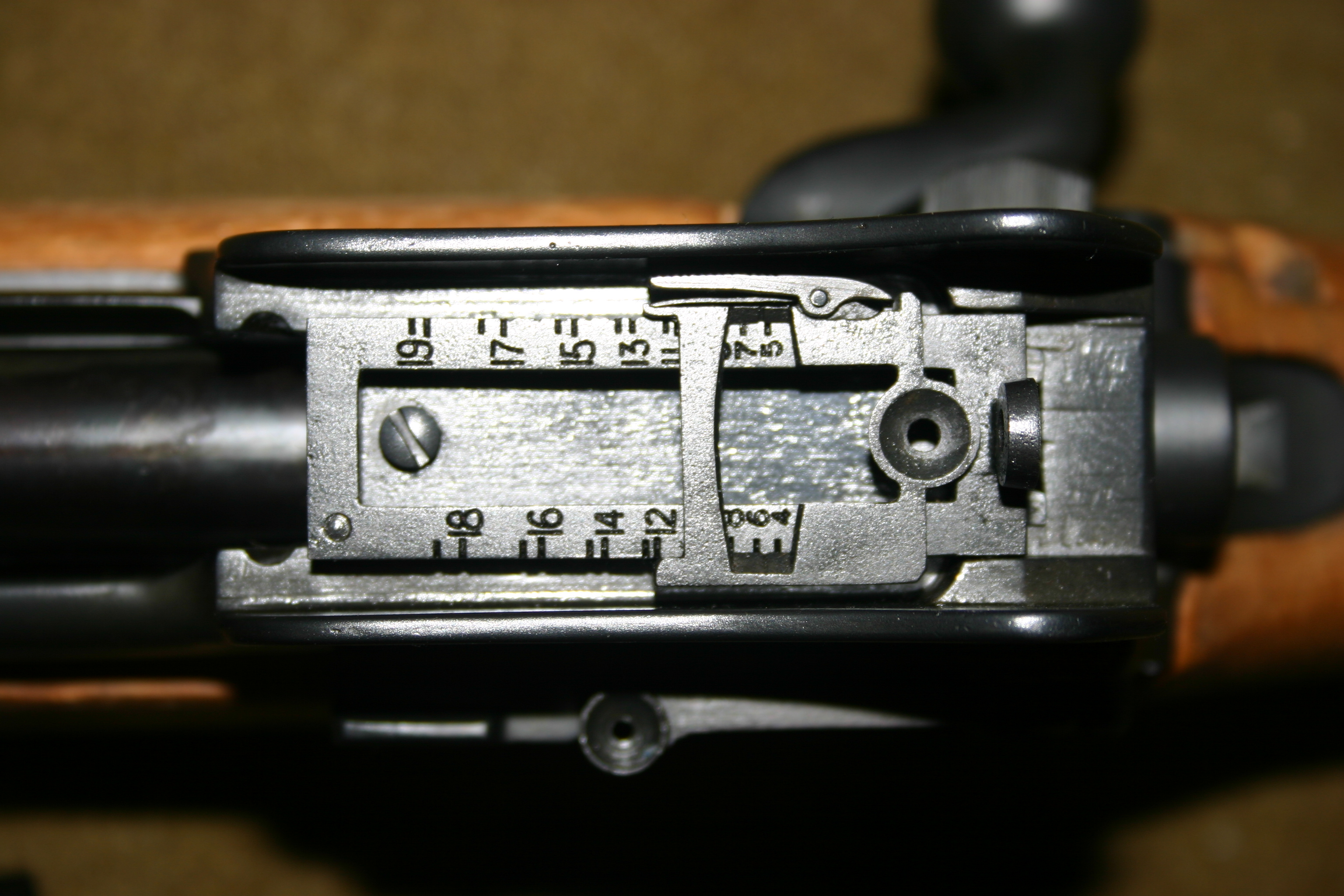

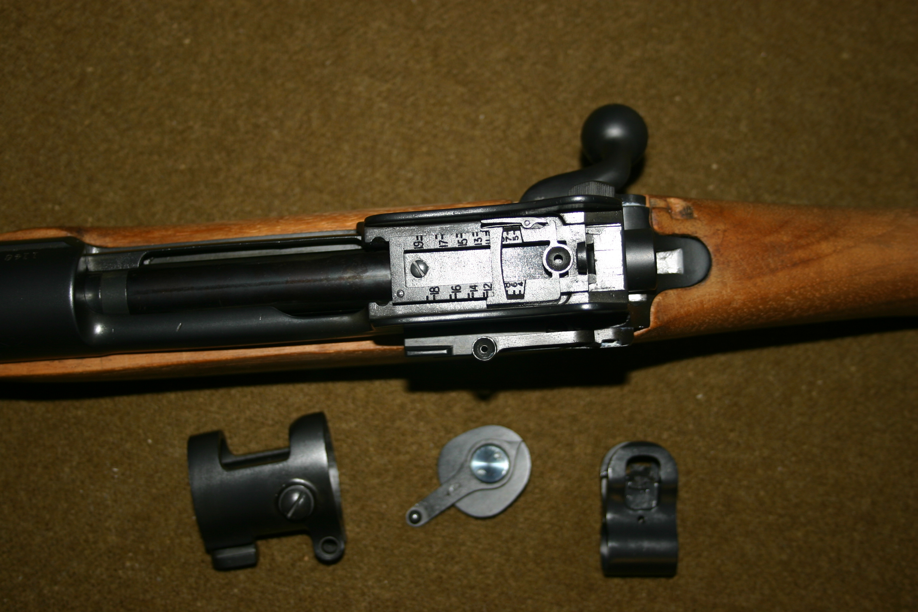

    Well Santa came early for me... last friday to be exact.
    The P13 is back from the restorer/metal fabricator shop.
    To say that i'm pleased would be an understatement.
    I had not posted updates in a while...well simply because i had nothing to post lol
    He was so busy that he wasn't sending pics in the updates. It's ok i had complete confidence in him.
    Other than rebuilding the ''ears'', the rear sight was probably the more challenging part to replicate.
    (i think i'll have to repost all my other pics )

    Wow that's looks amazing. You must be quite pleased!

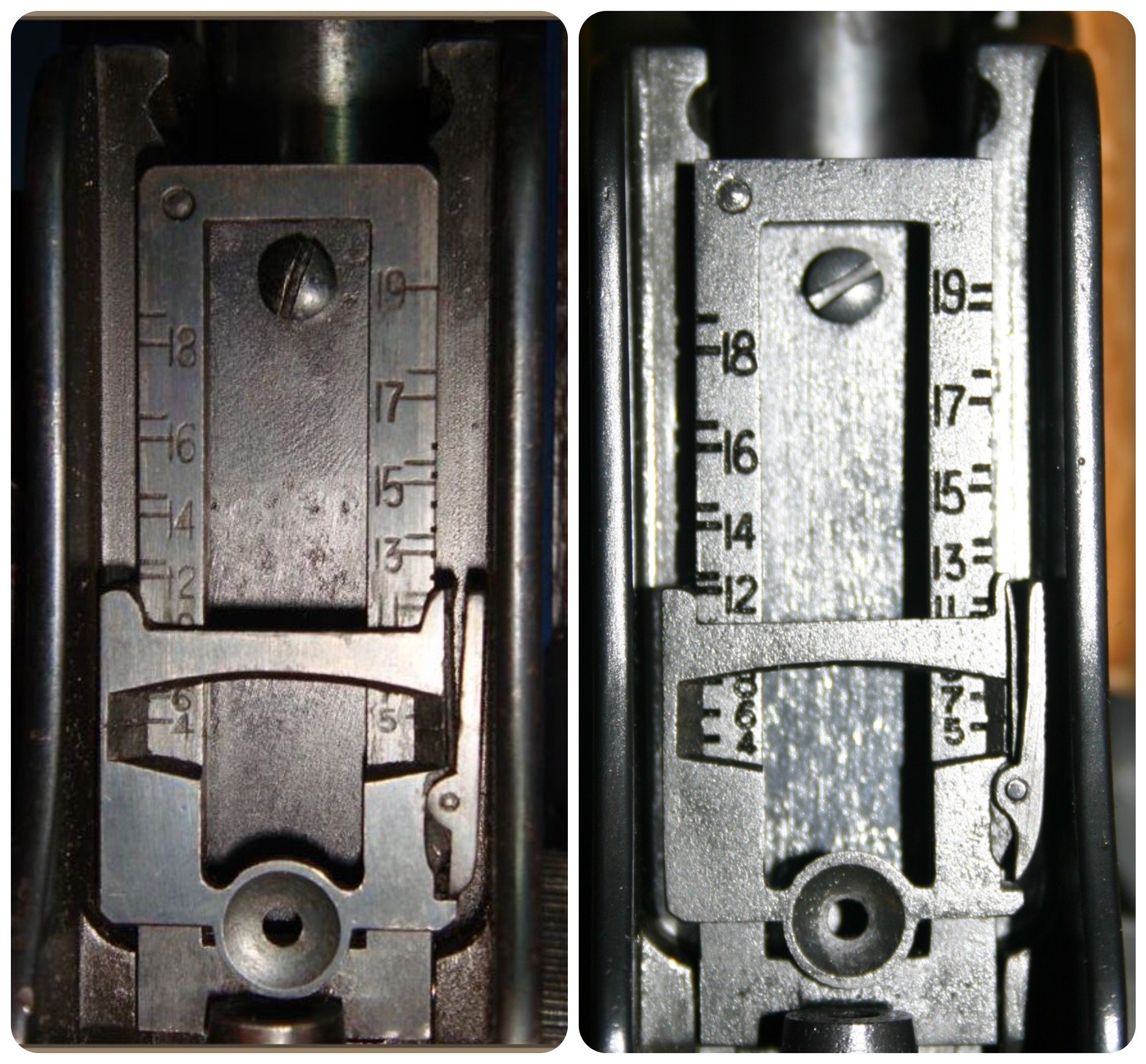

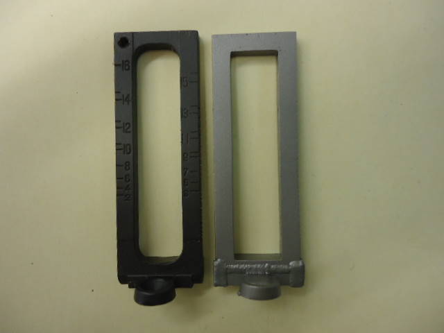

    Here's a top view side by side pic of the reproduction sight, for you promo.
    The one on the left is the original.

    That sight looks excellent. Only thing I had noticed was the original one has rounded edges on top, and the 19 is lacking the second setting line. The spring held lever is also a bit of a different radius, but amazing excellent done. Did he mill that from a full part and laser engraved it, or was it 3D printed?
  13. Thank You to Promo For This Useful Post:
  14. #58
    Legacy Member tatou's Avatar
    Sep 2008
    11-12-2023 @ 04:55 PM
    281
    07-01-2025
    07:06 PM
    Yes those are small differences that i had noticed too and are more obvious with a side by side comparaison.
    The top rounded edges could be very easily fixed with a small file.
    I'm assuming the extra line next to the 19 is a small oversight by the engraver but it doesn't look out of place and i can live with that.
    As for the leaver, it was way simpler to convert an existing P14 or M1917 sight than build one from scratch... so some leeway was more than acceptable.
    That leaver is tiny and i hate to think of the work it would take to make an exact replica.
    Trust me, the time adds up very fast on this kind of work.
    If one was to make a second one, this could serve to point out those small differences. The 2nd try is often better than the 1st in this kind of work.

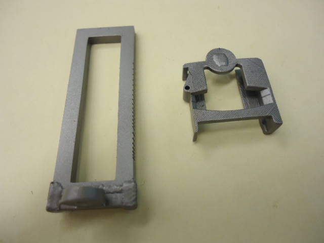

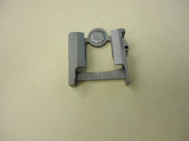

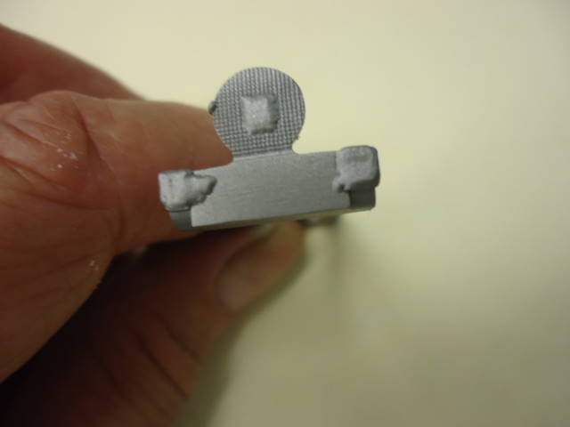

    The next pics are some of the work that was done.
    The leaf was shortened, the peep holes filled in and re made to get the proper look.
    The old inscriptions removed and new one laser engraved.
    The slide also had the texture smoothed.
  15. Thank You to tatou For This Useful Post:

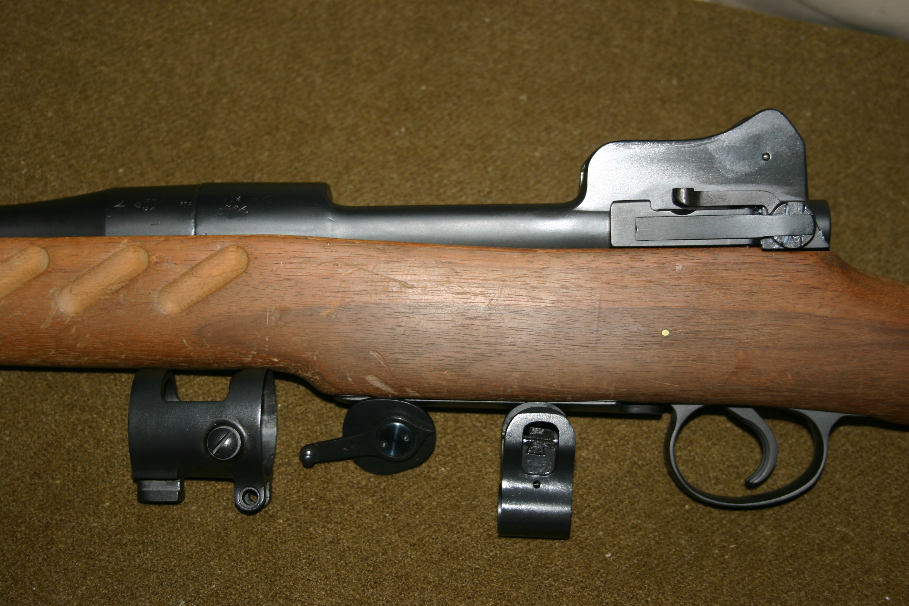

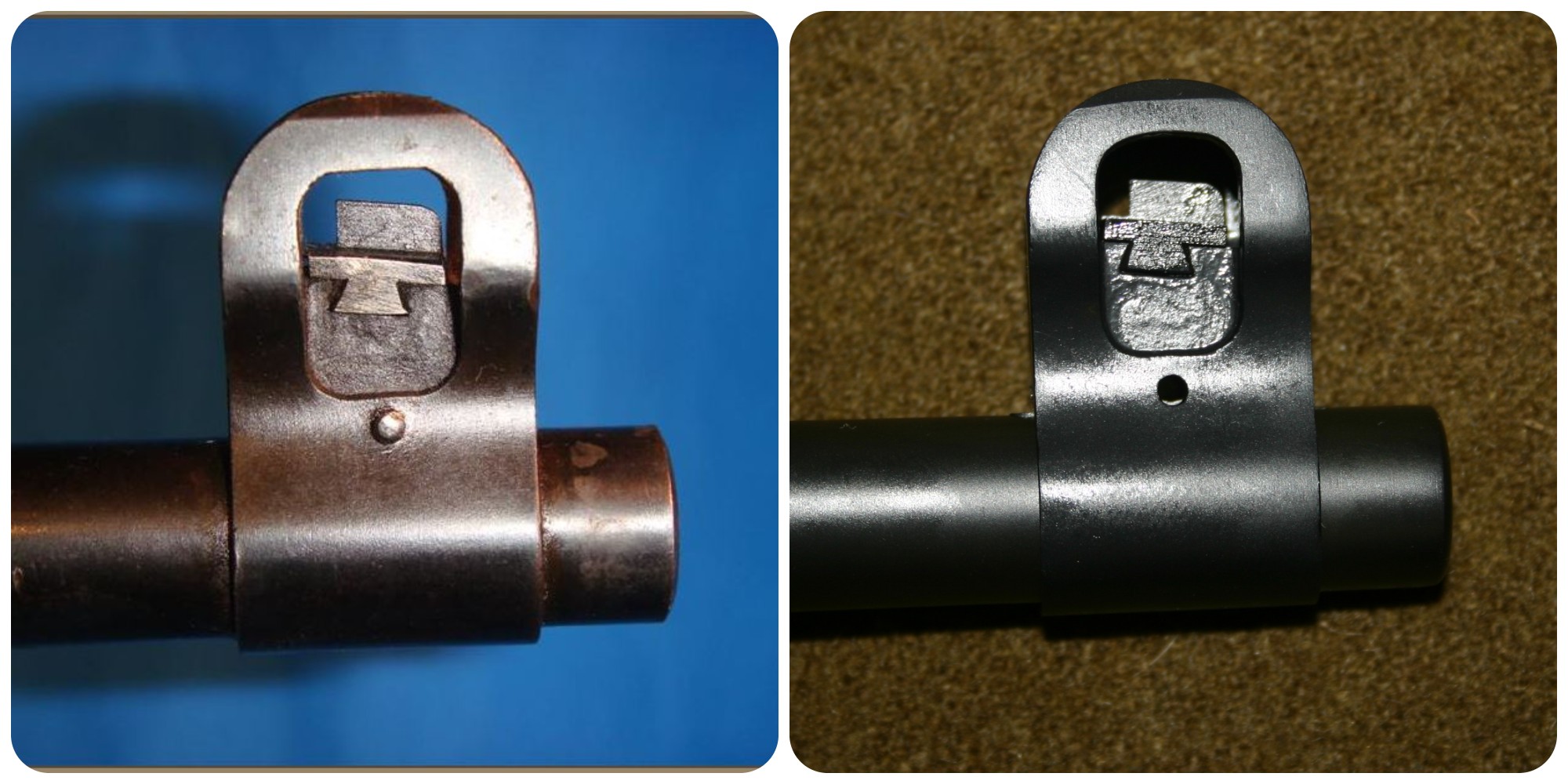

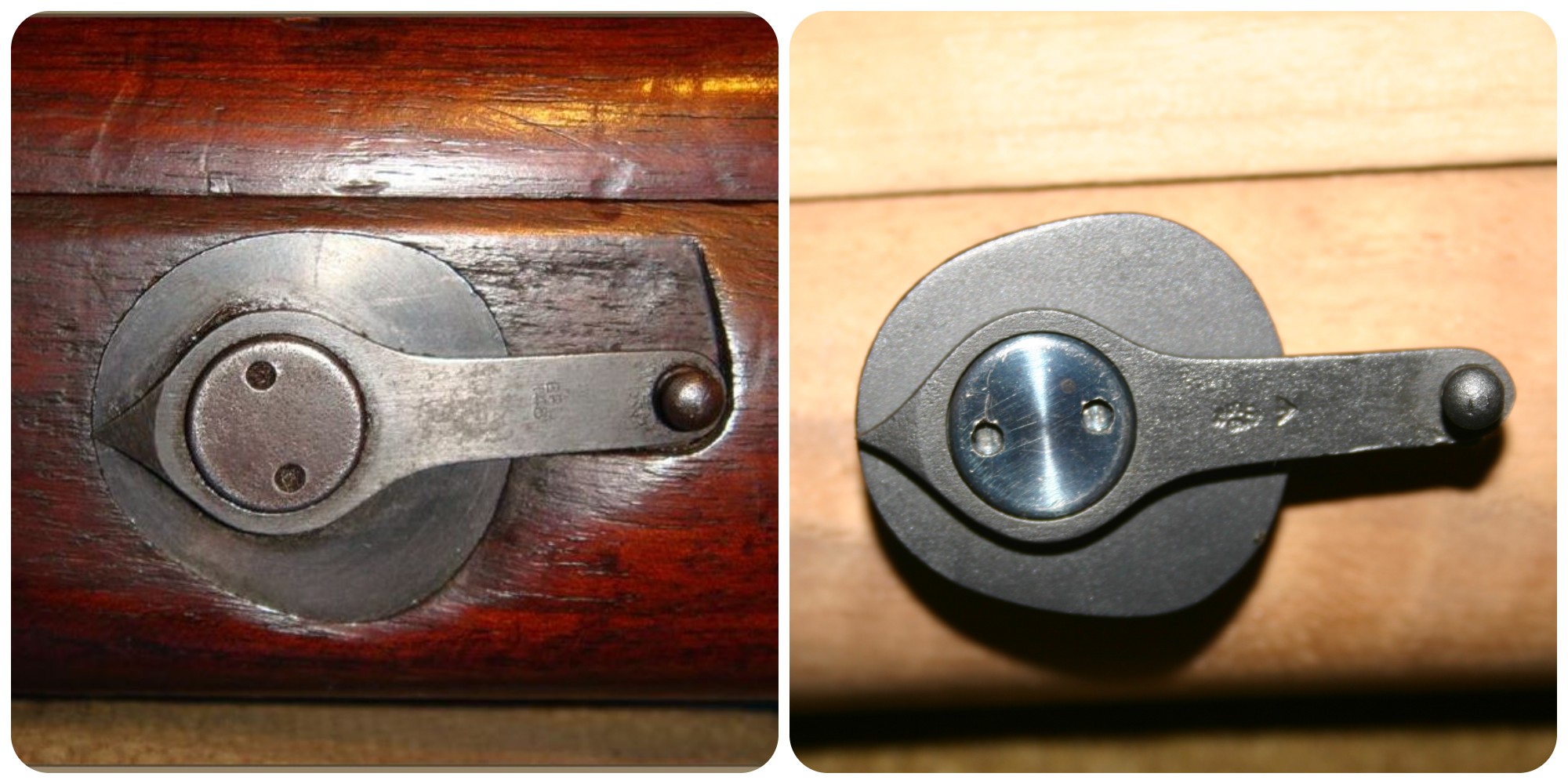

    Here's a couple more side by side shots of the front sight band and the front volley sight.
    Left is the originals (like we can't tell)... right reproduction.
    Again the easiest way was to use a Pattern 1914 Sight band and dial plate, the pointer is SMLE like on originals.
    I just noticed the marking on my pointer is BSA... the original was probably EFD on all Pattern 1913.
    And yeah the finish on the pivot screw is different but that's an easy fix.
    Somethings i never noticed before. Oh well... i hope i can sleep tonight

    Tatou, Intriguing work you are doing. What process was used to make the rear sight parts? My guess is they are a 3D printed sintered part-- ?? Thanks
