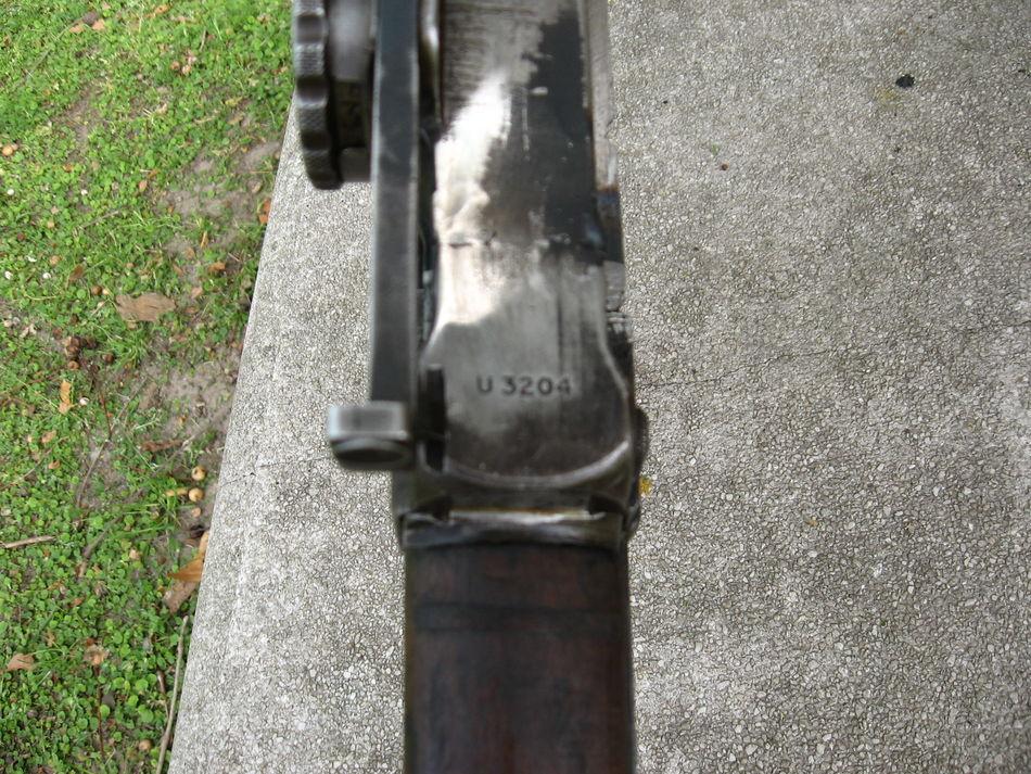

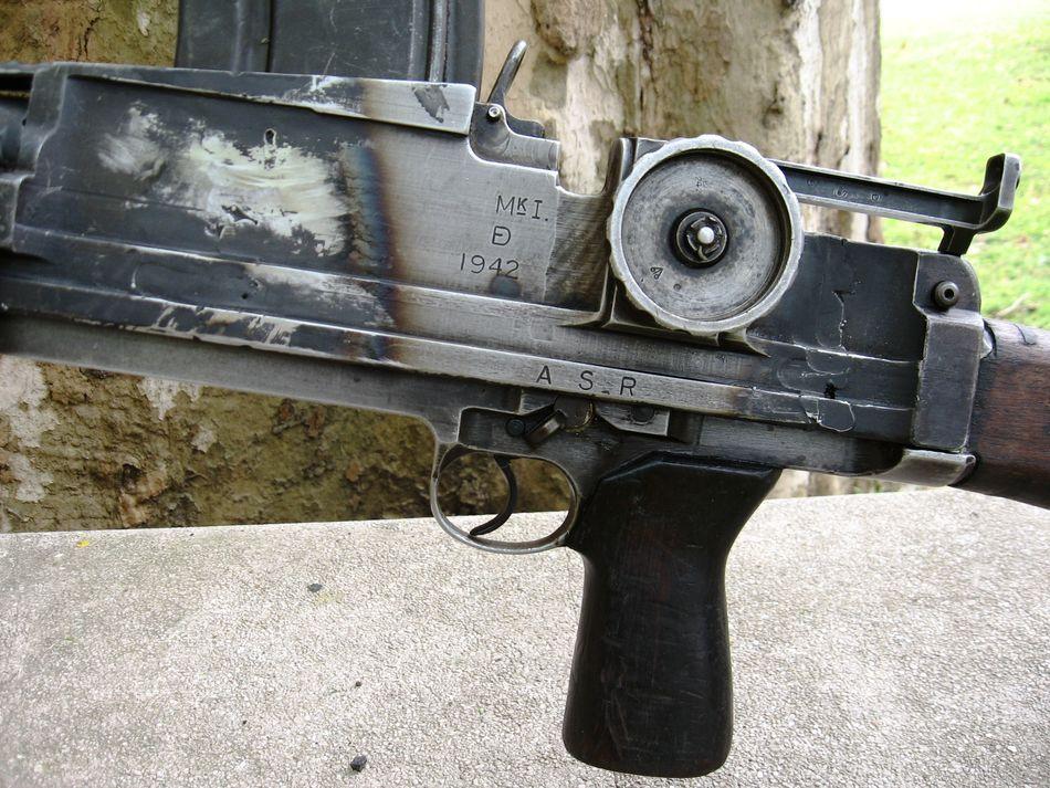

    My Bren MK I numbers
    Regards
    Luis
