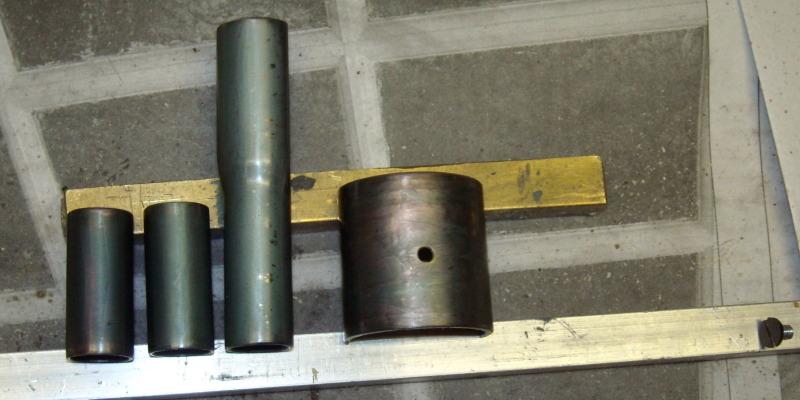

    I did remember to take a couple pics of some of the browned parts prior to assembly:
    And here is the barrel after the last round of browning but prior to scaling:
    I won't bother going into the browning details - there are lots of references on how to brown steel parts. Just buy the solution of your choice and follow the directions. I prefer to leave my browning solution on longer, 12 hours at a time, as I prefer the older stippled look like a true older rifle.
