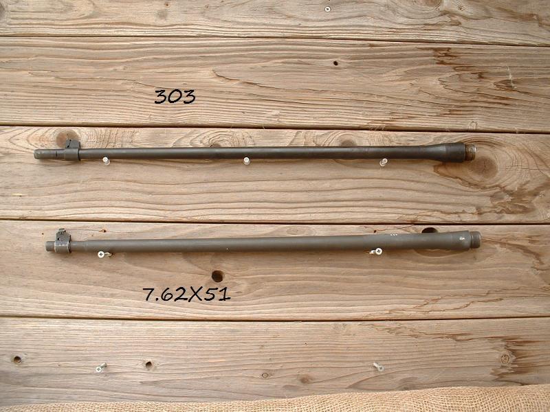

    I would like to thank all the posters for this very informative thread. I look forward to future postings. For several years I had thought I was very lucky to have two like new barrels in 303 and 7.62 and two serviceable receivers to mate but this has let a great deal of sunshine on the larger picture of our sport/ passion.
    I have been away to middle earth for a good long time with no shooting at all but now reading this post I feel the juices starting to warm and flow again. Thank you all.
    Note to self, contact Brain.
