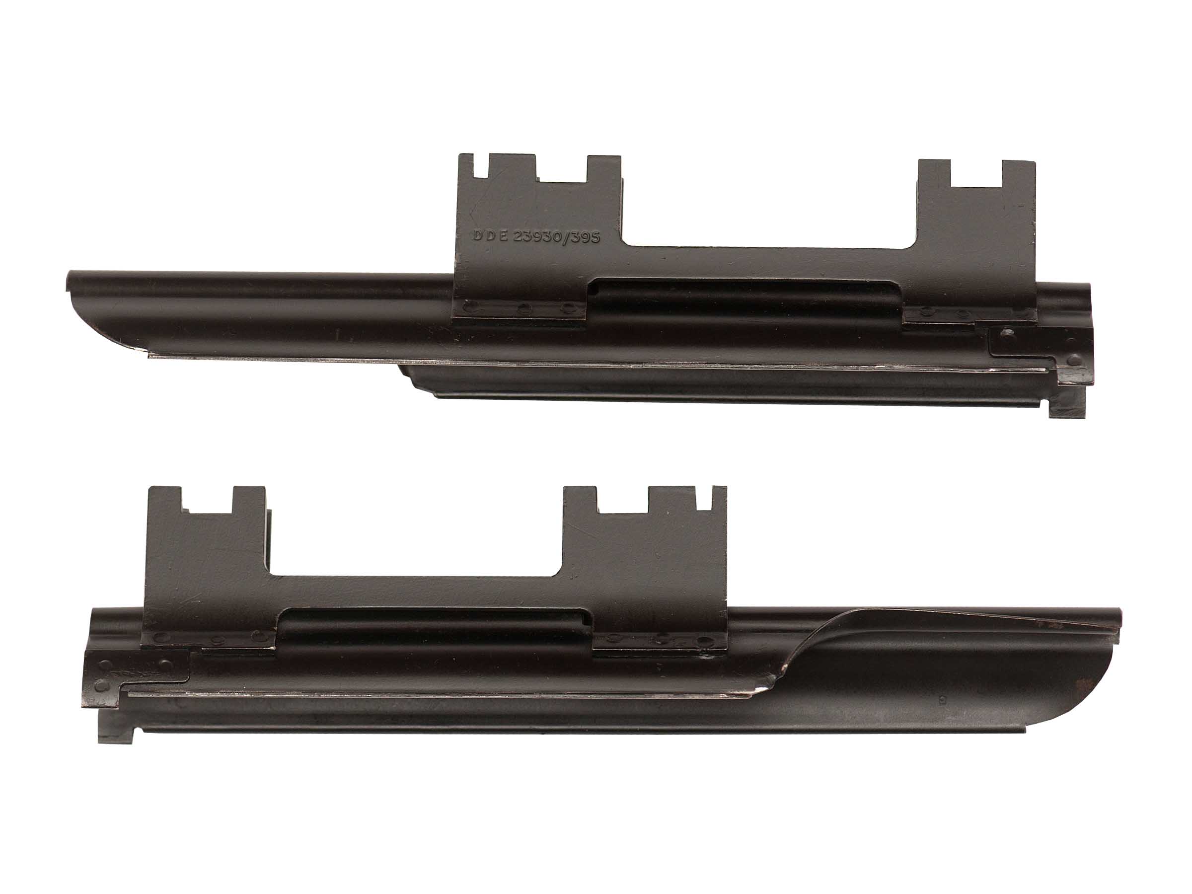

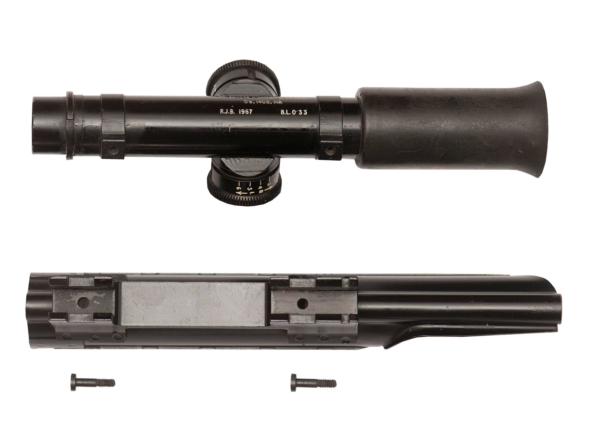

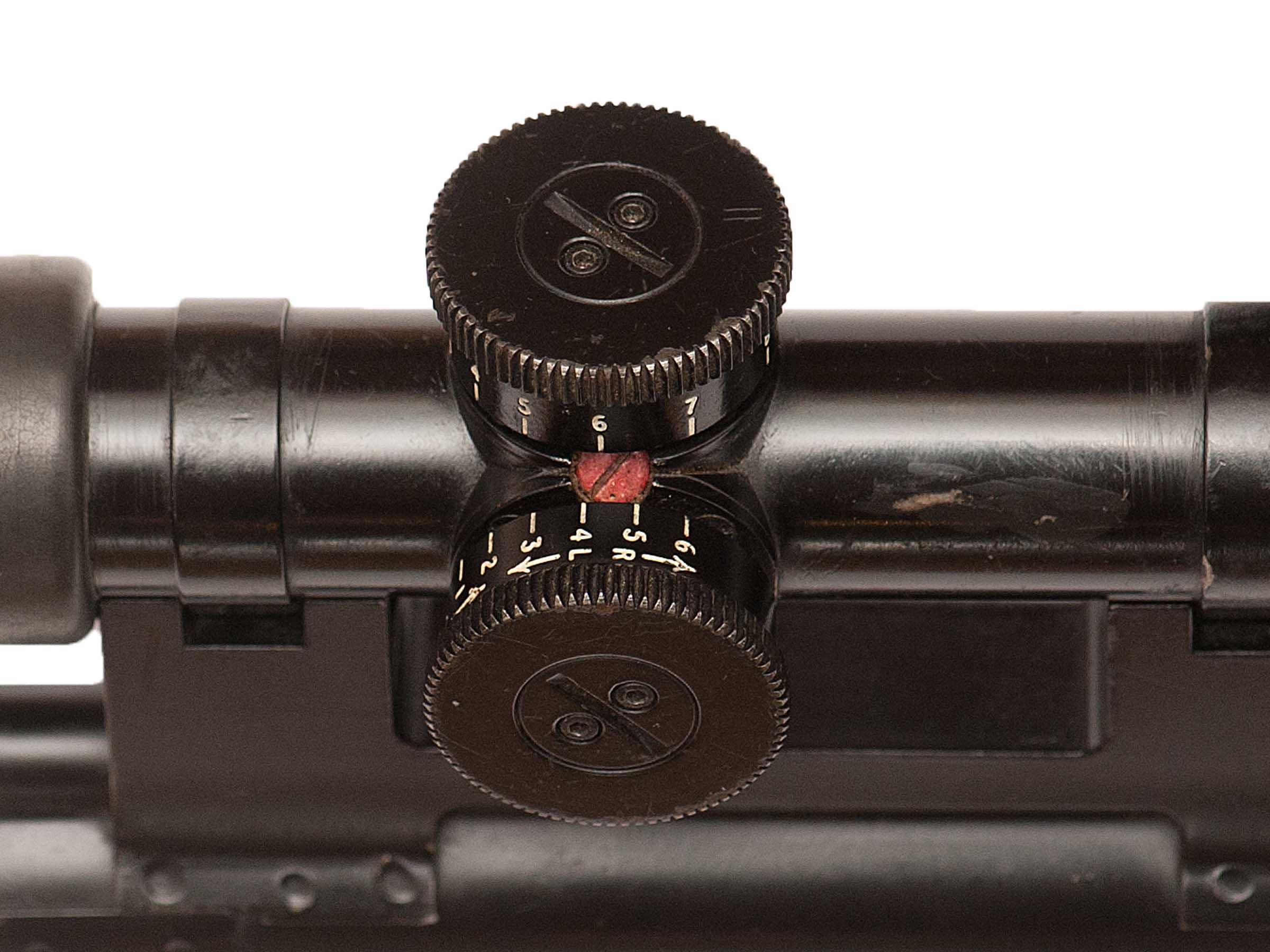

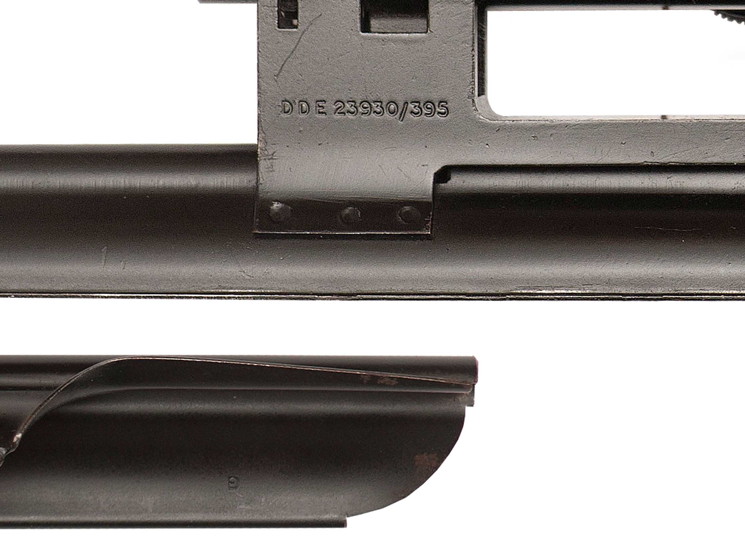

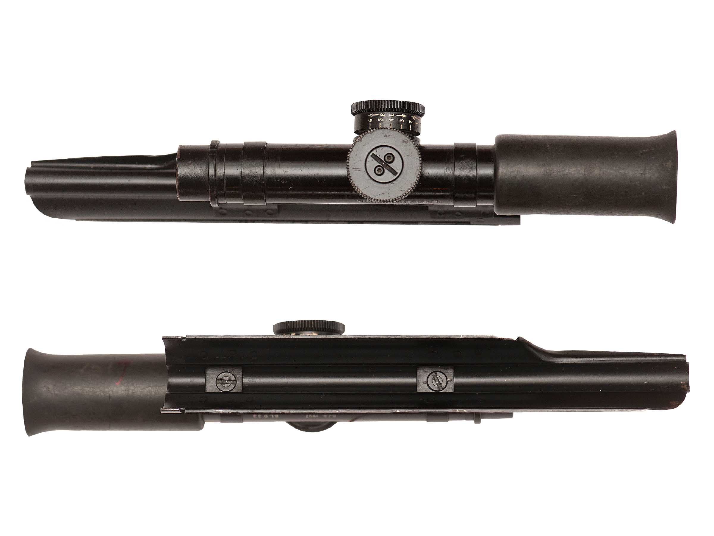

    I finally had a chance to circle back around to the ongoing research....
    Attached are a series of detailed cut out images I've taken of my example for future reference.

    Excellent photos. Not much of a case is it?
    A bit of deformation at the front top of the cover from recoil "slamming"? A half-round reinforcement brazed on there would have been a good idea.

    Research will trickle on as and when I get time. It's Warminster first to check for any trial information and then Leeds to look at their examples and the considerable documentation archive on the subject there.
    The pouch ( provided cleaned up image, not my pouch) does appear a little Health Robinson, it was a trials pouch however and I'm sure a far more robust example would have been produced to integrate with the 58 pattern ?? web equipment, had the No74 been adopted.
