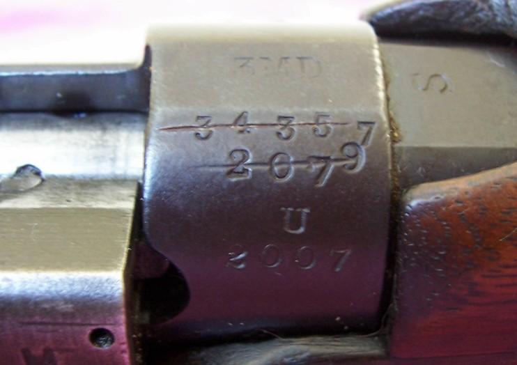

    Here's a 1907 BSA MkIII 3MD marked rifle that has had 2 Inventory numbers struck out, the rifles original sn is U2007
    This one is a 1917 Lithgowicon MkIII also 3MD marked that has the Inventory number still intact with the original sn below it, from your 1 photo it would appear yours has been restocked in Aussie Coachwood but if you are lucky enough you might have the original butt with the Inventory number stamped into it which you can see below the X'd out CMF 3MD
