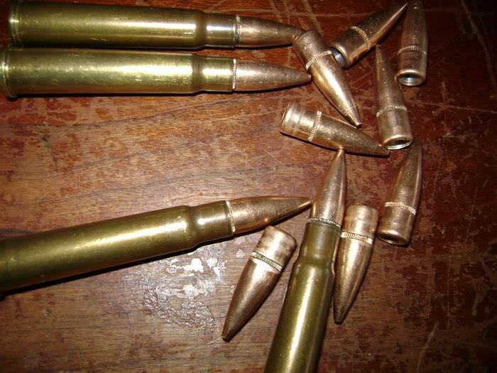

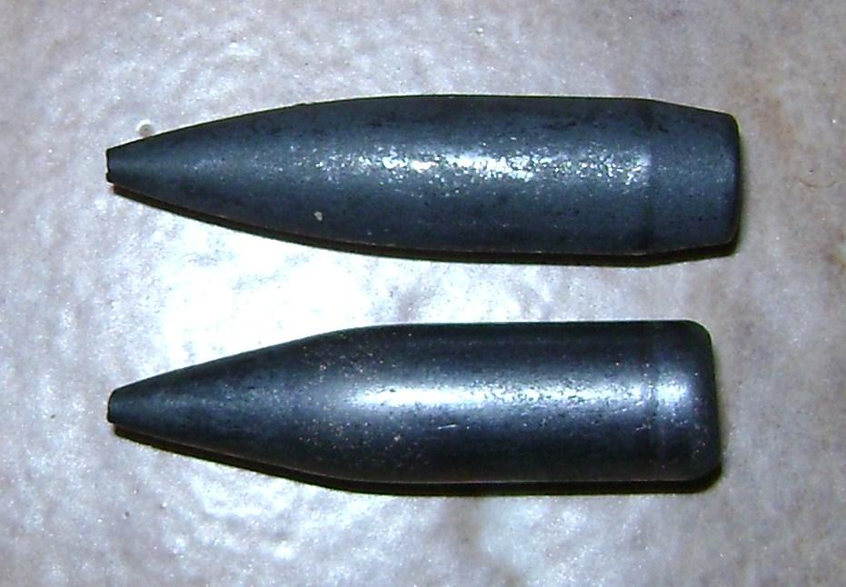

    I am still here I just moved out of there. here are some pics of some more recent ones made from LC FMJ's
    I stopped making them when tipans came out because everyone started buying the tipans

    I have made a few die sets to use in a large reloading press like a rock chucker. they are not hard to make but are slow and time consuming but rewarding if you want the goodies with out the headache of searching for them. I have also been reforming the 168g and 175g SMK's
    if you know a machinist that can chamber a barrel I can show them how to make dies
    the reforming will work on any lead core bullet but not on steel core and not real good on steel jacketed
