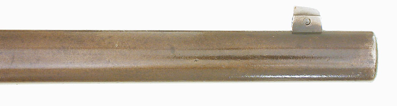

    The front-sight base appears to have been freshly drilled and the blade pin looks to be an over-size replacement.
    It does not look like arsenal work. (Burred & apparent punch mark)
    It is just another one of those inconsistencies in fit and finish that Patrick Chadwick has alluded to.
