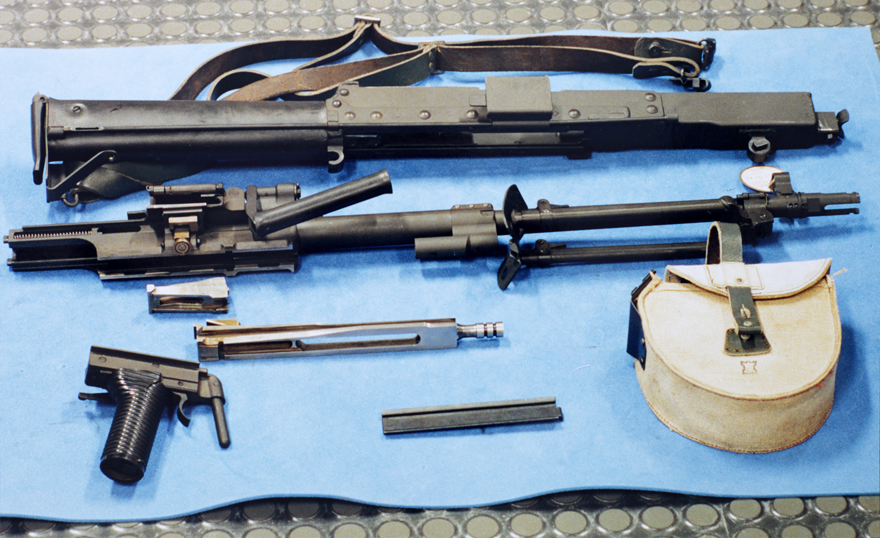

    Seems like there is always one more pic I should take. A stop screw in the lower keeps the the latch pin from lining up with a hole in the lower. Remove the screw, align the holes, and push the pin out. Can you "stamp" the E in the D on your latch?

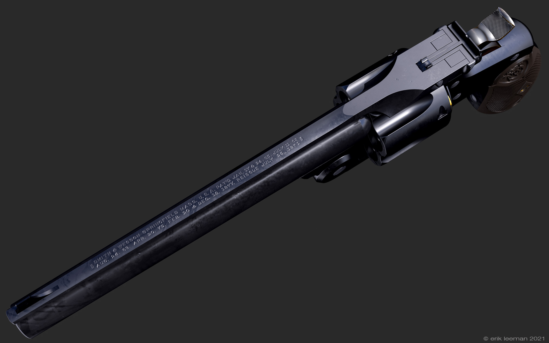

    Hey, I could do some nice scroll engraving with gold inlays and a hunting scene on the sides of a Bren, there's plenty room for it : )
    Here's an example of a roll engraving on an old Smith&Wesson revolver I've modeled recently:
    For this I just need a good image, from a photograph for instance, so I can convert it to 3D geometry.

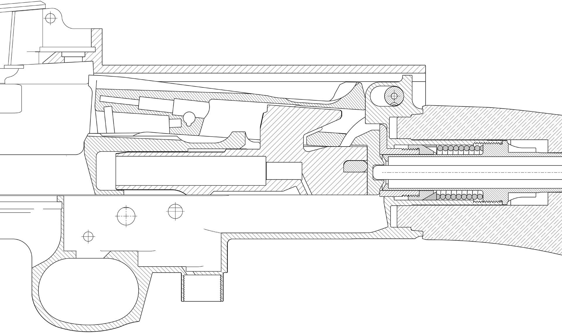

    Here's a 2D drawing of a fully compressed Bren recoil buffer.
    The receiver (or body) is also in its rearmost position.
    (the section plane is in the centre of the buffer, not in the centre of the boltcarrier, they are offset to each other)
    It appears the bolt (or breech block) is stopped by the lower receiver itself, not by the buffer.
