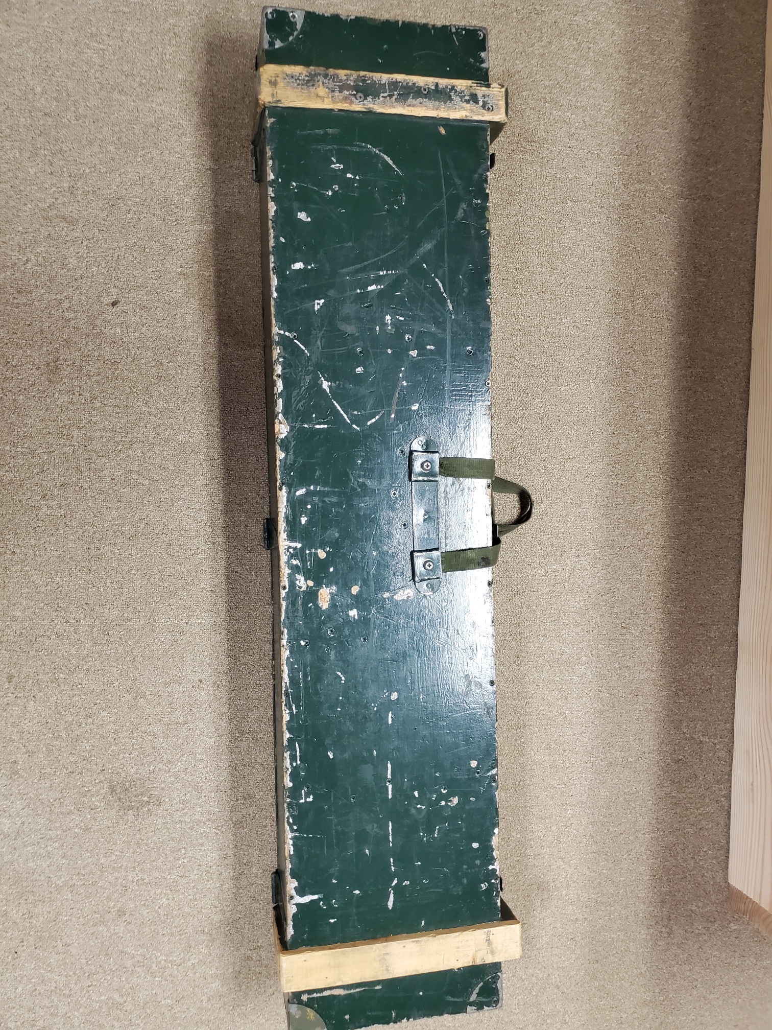

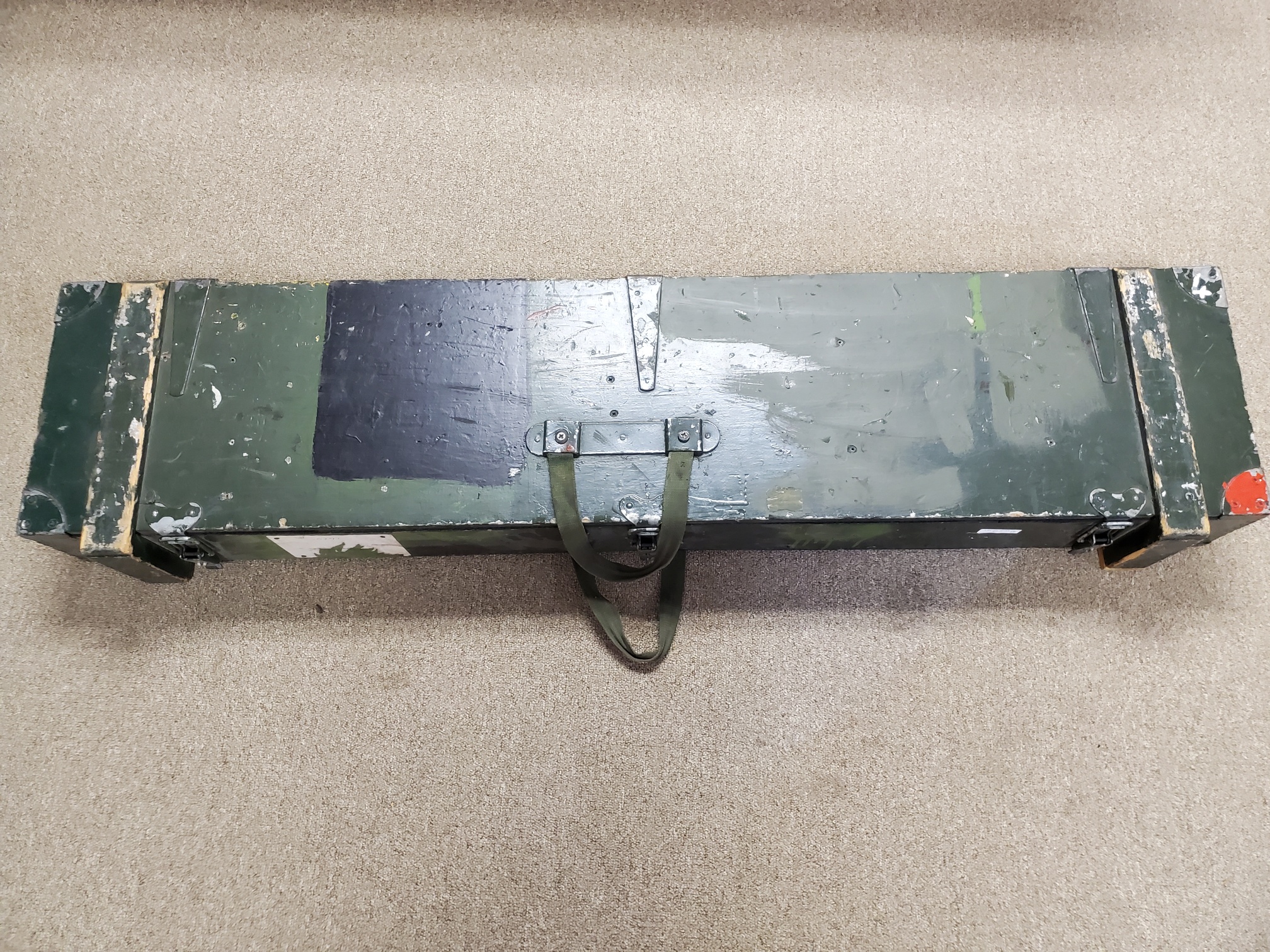

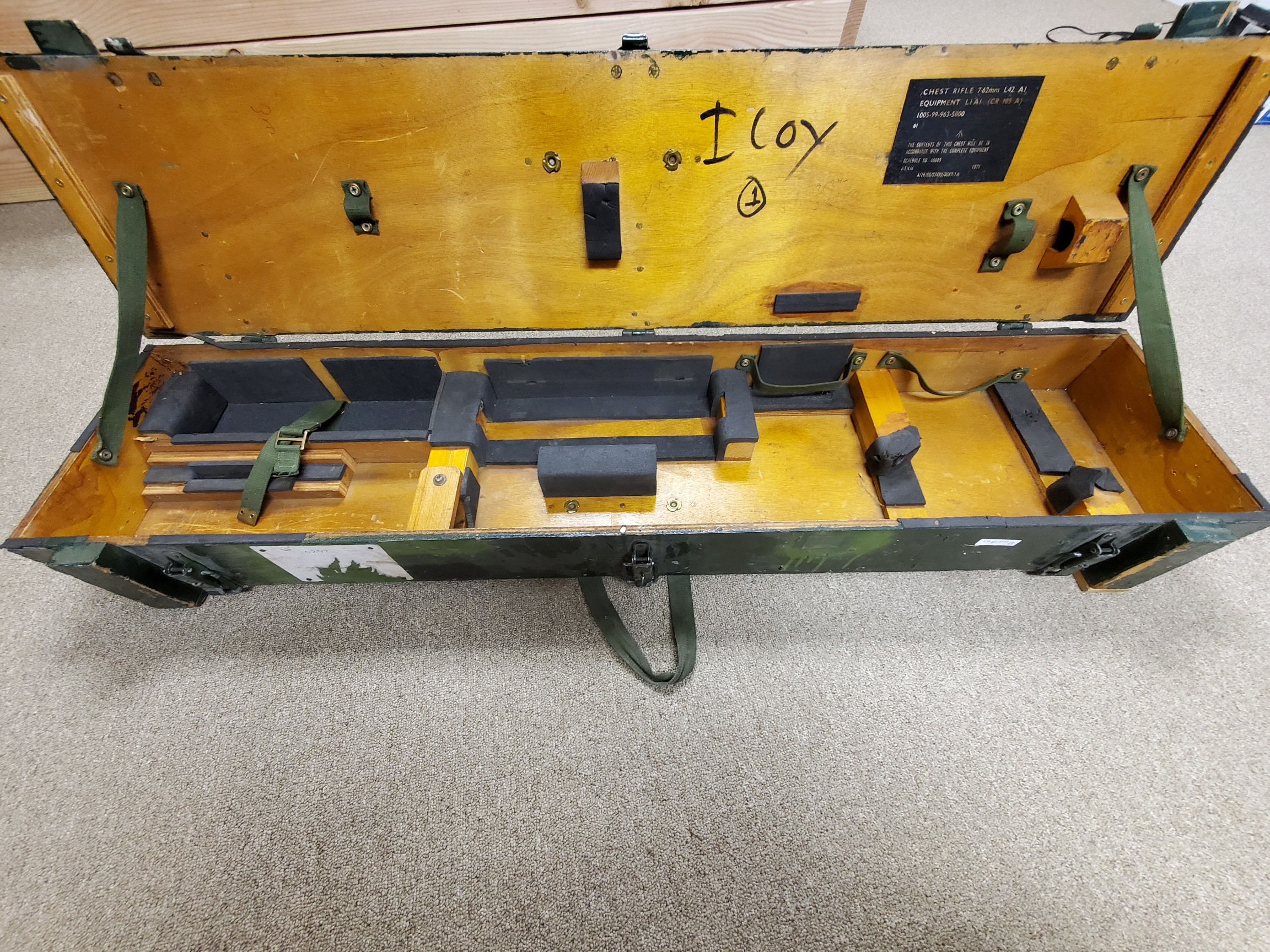

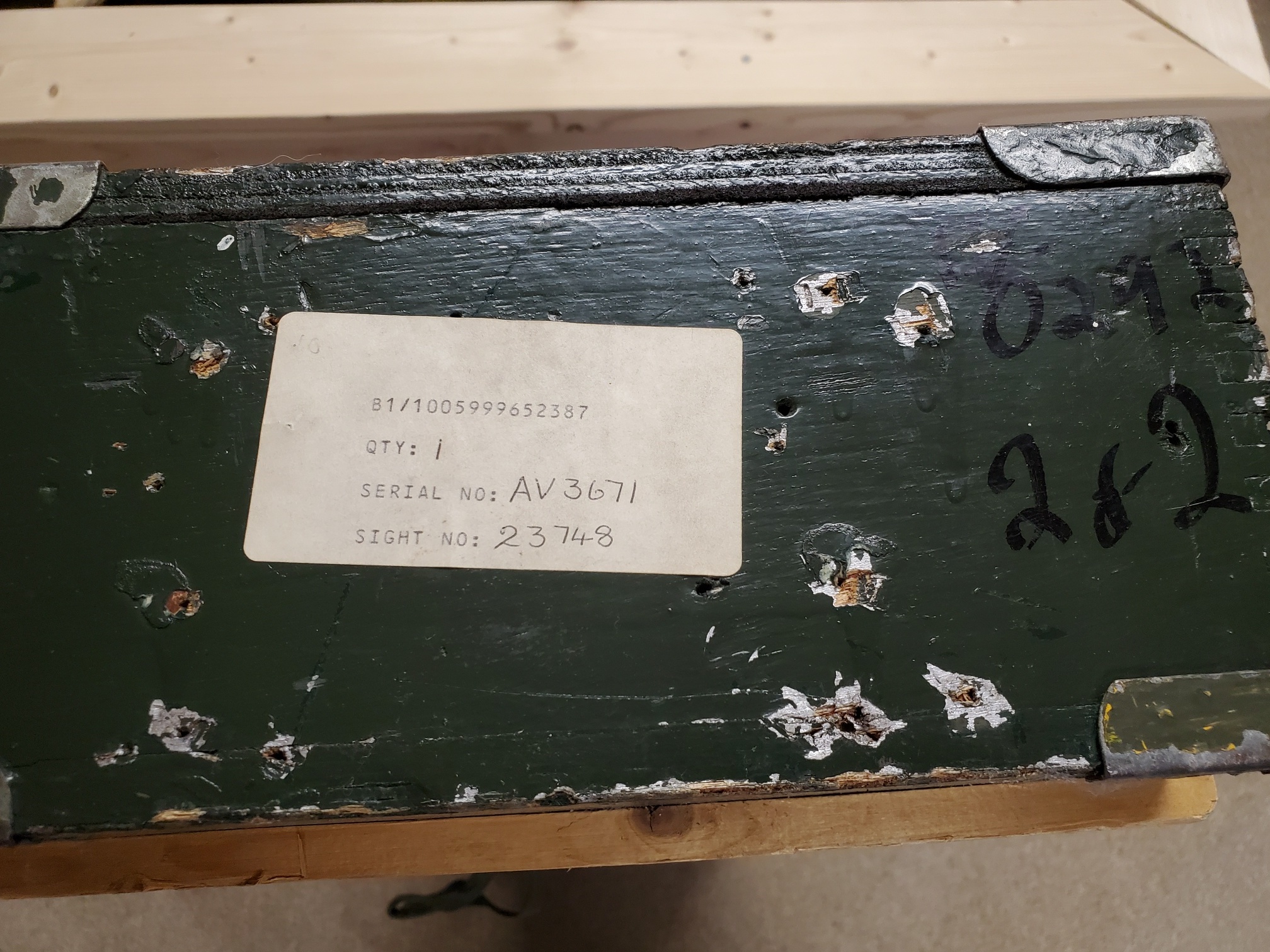

    For those interested the rifle/scope appear to be matched together. From my records the original chest sadly I did not record where I saw it (lazy).

    Lance, this chest was one of the ex Faris collecton auctioned by Poulins - you mentioned it in the thread here - https://www.milsurps.com/showthread.php?t=62695

    This transit chest is not with the rifle. The one with the rifle is the one that is made up.
