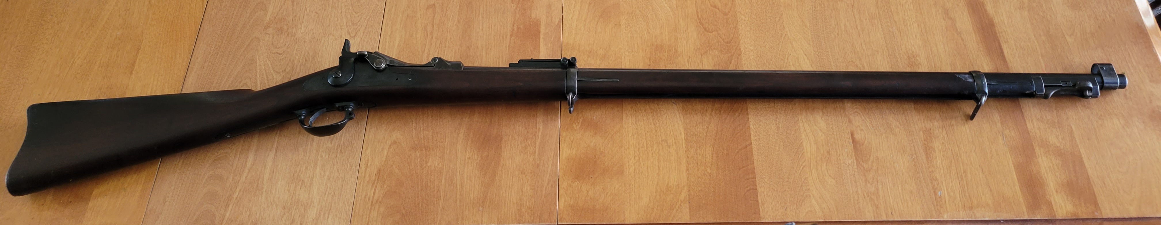

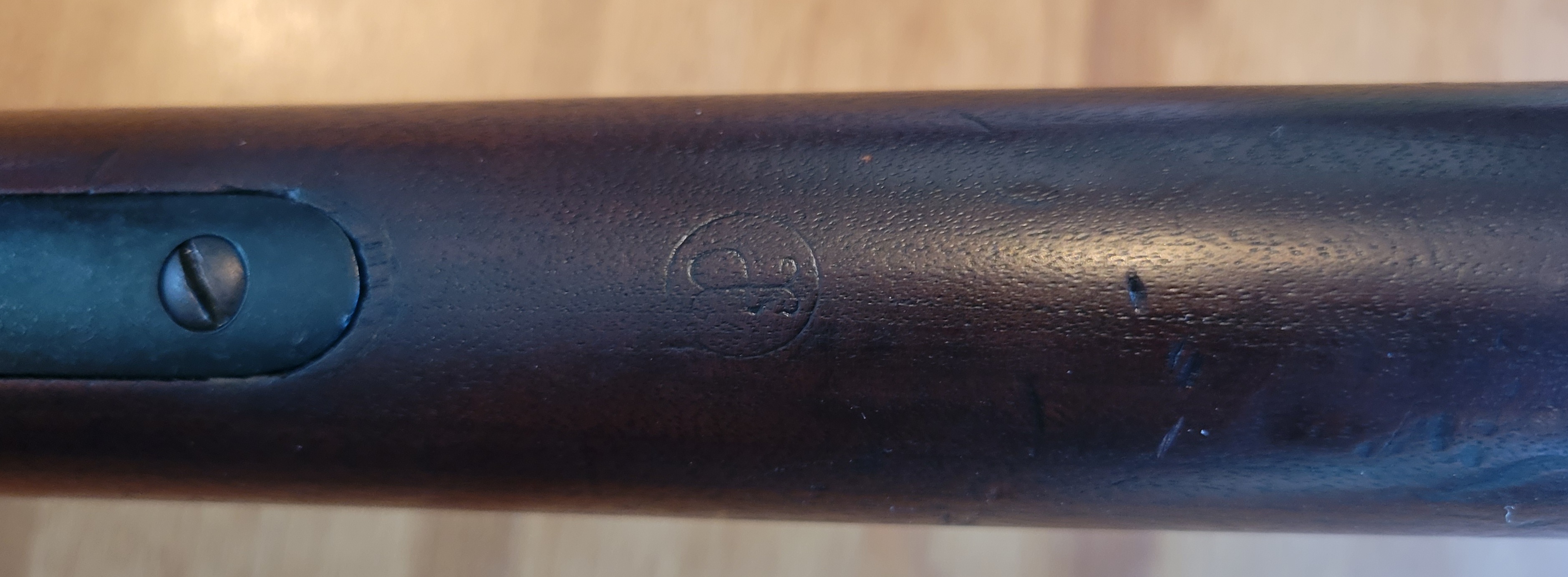

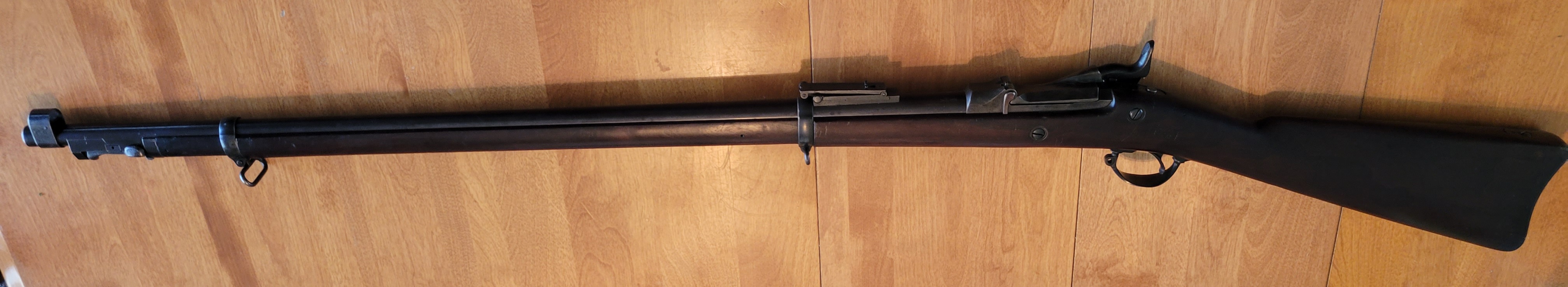

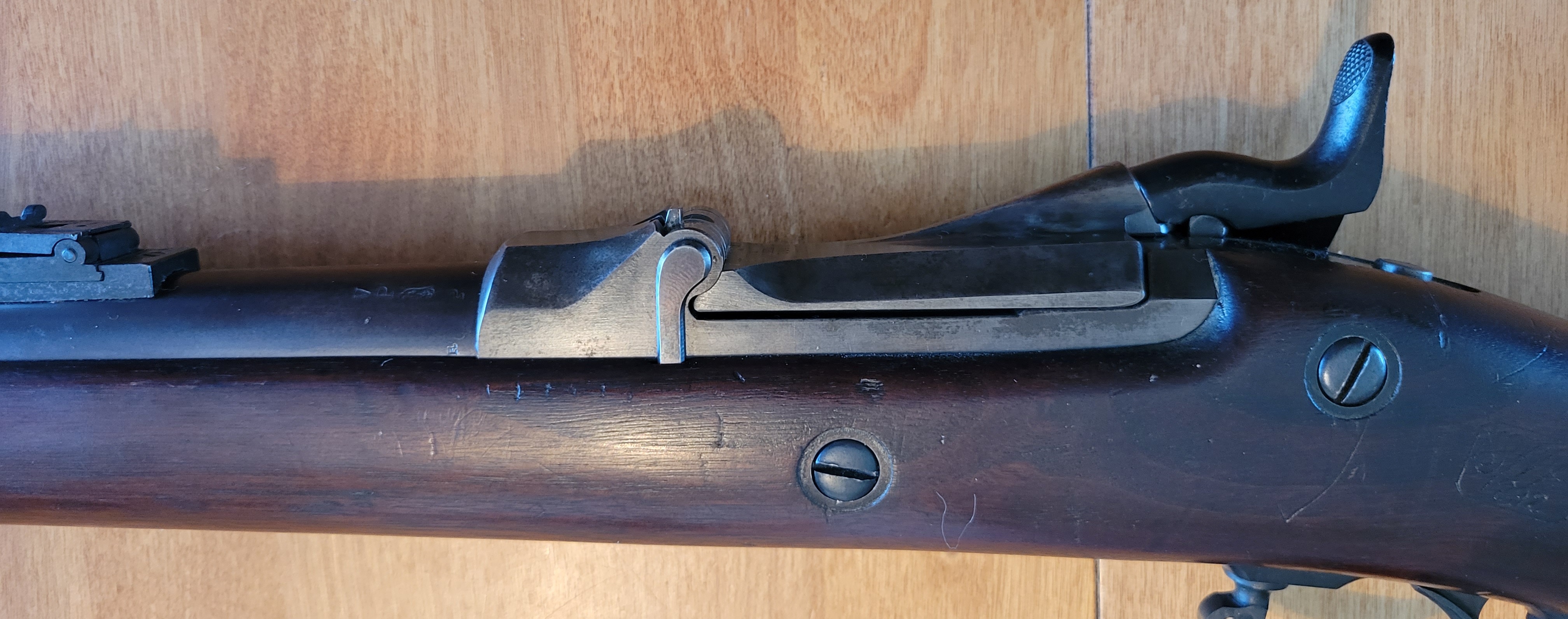

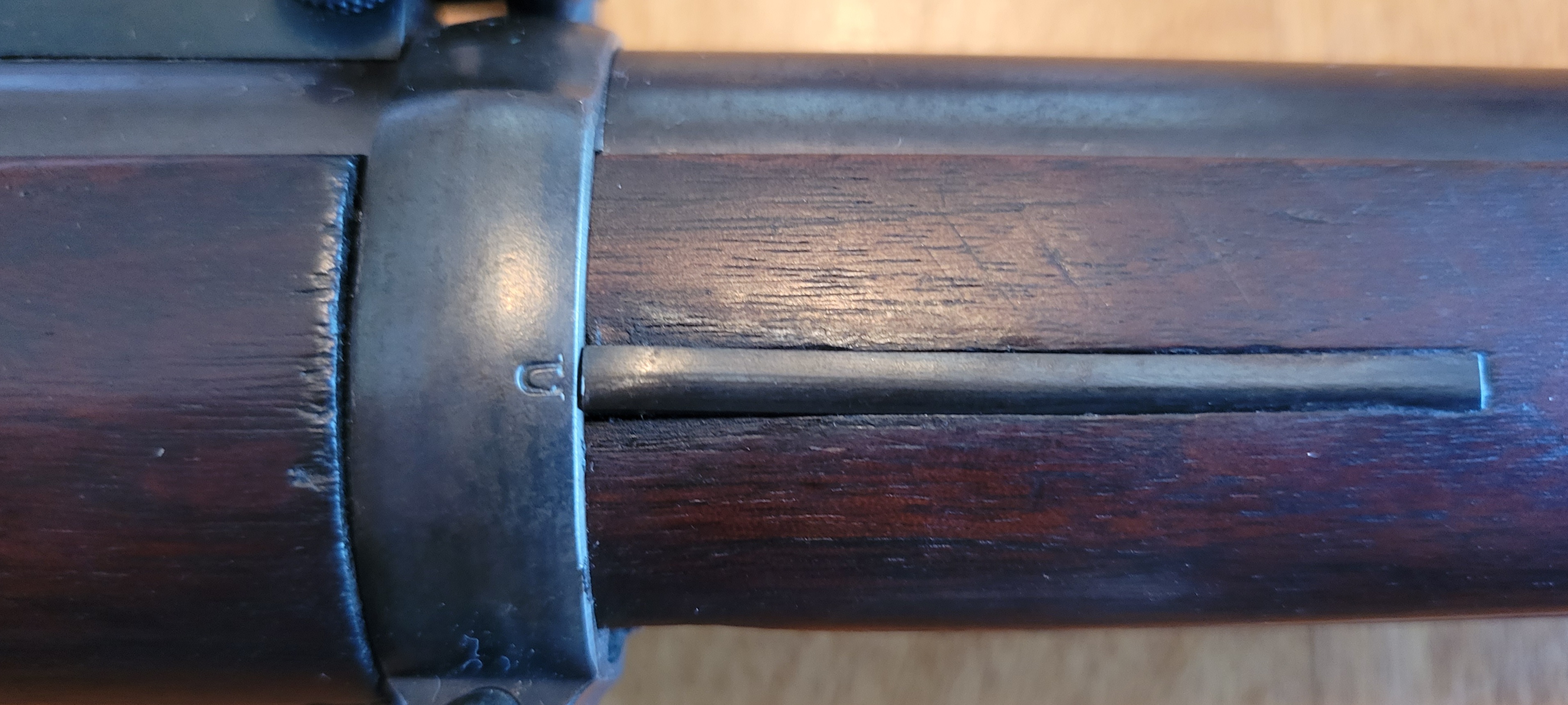

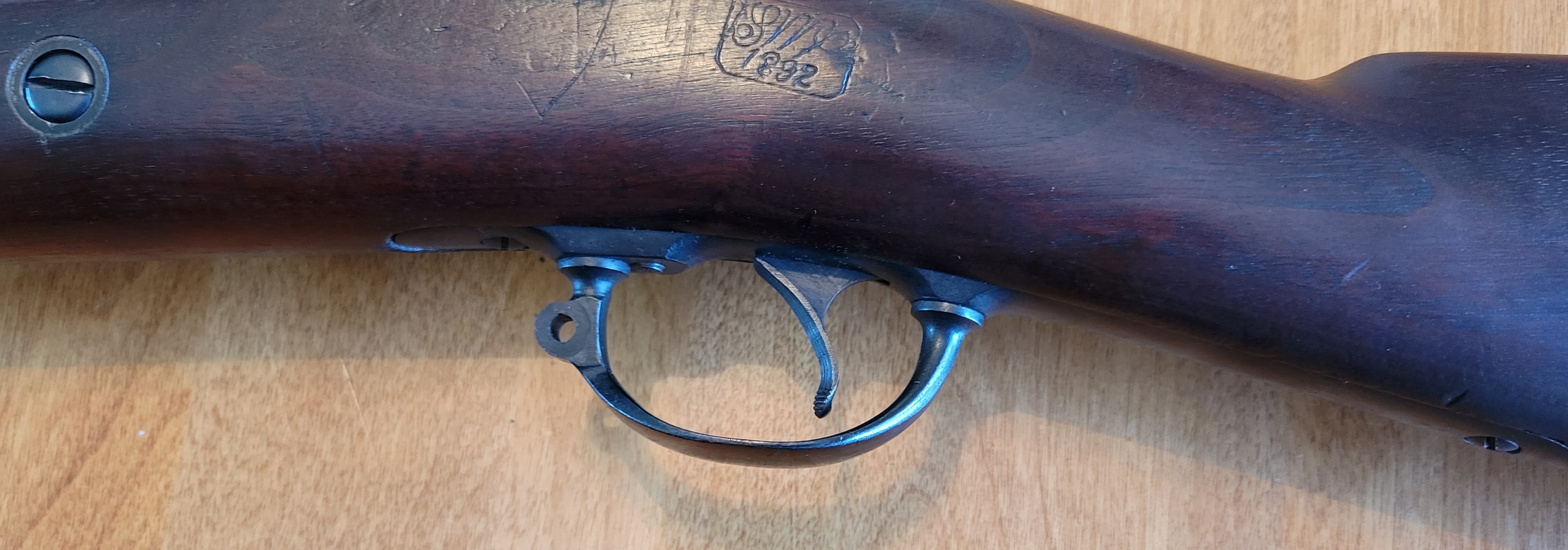

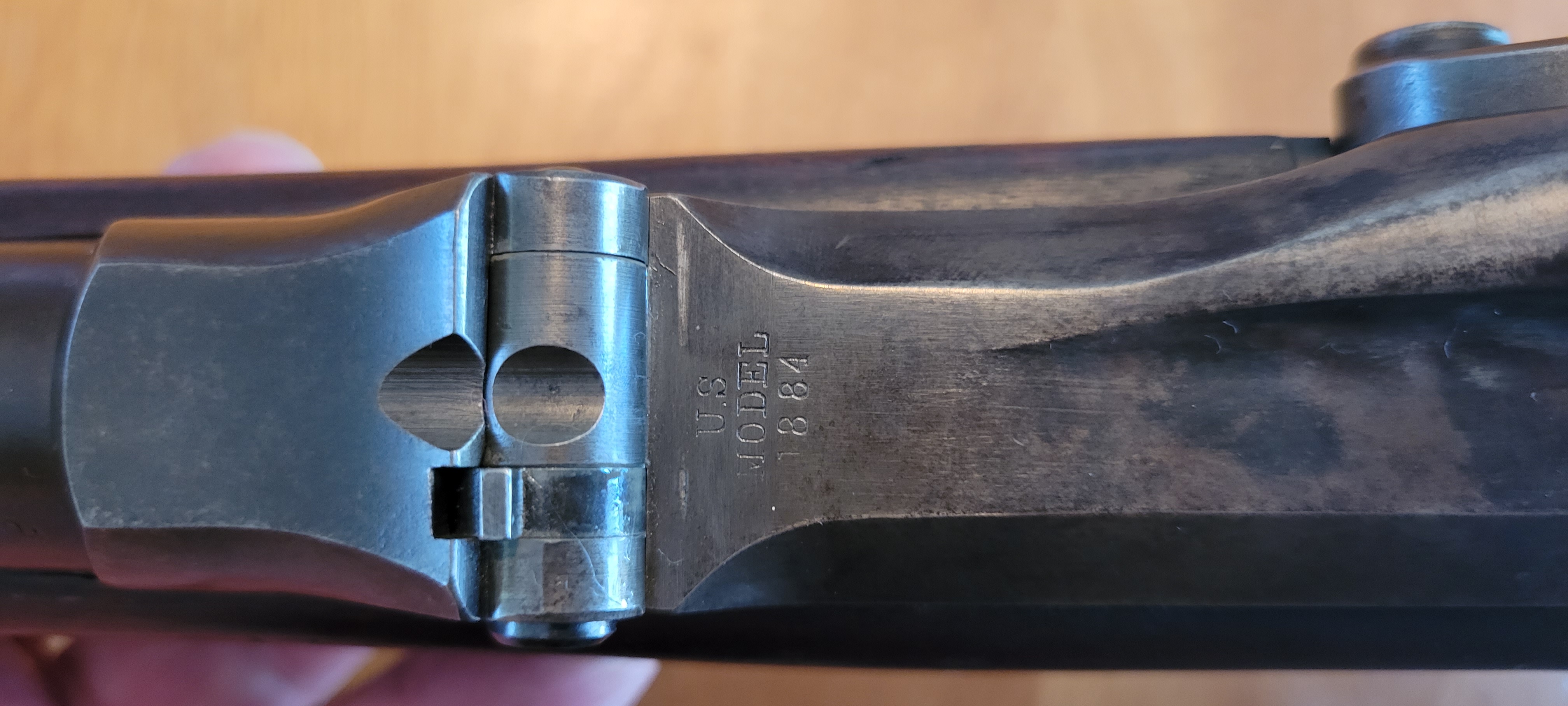

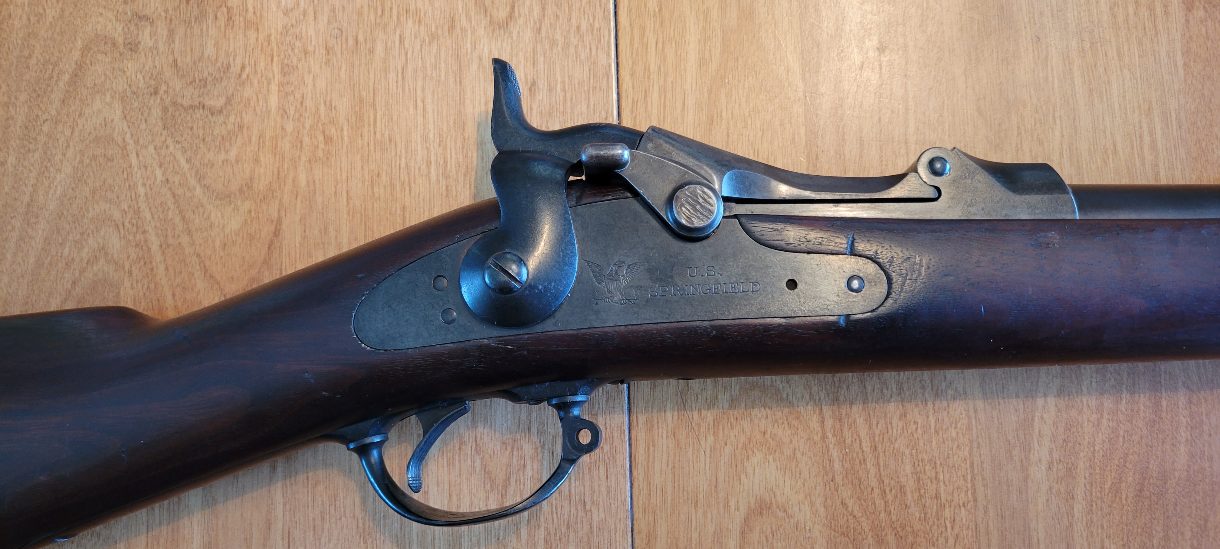

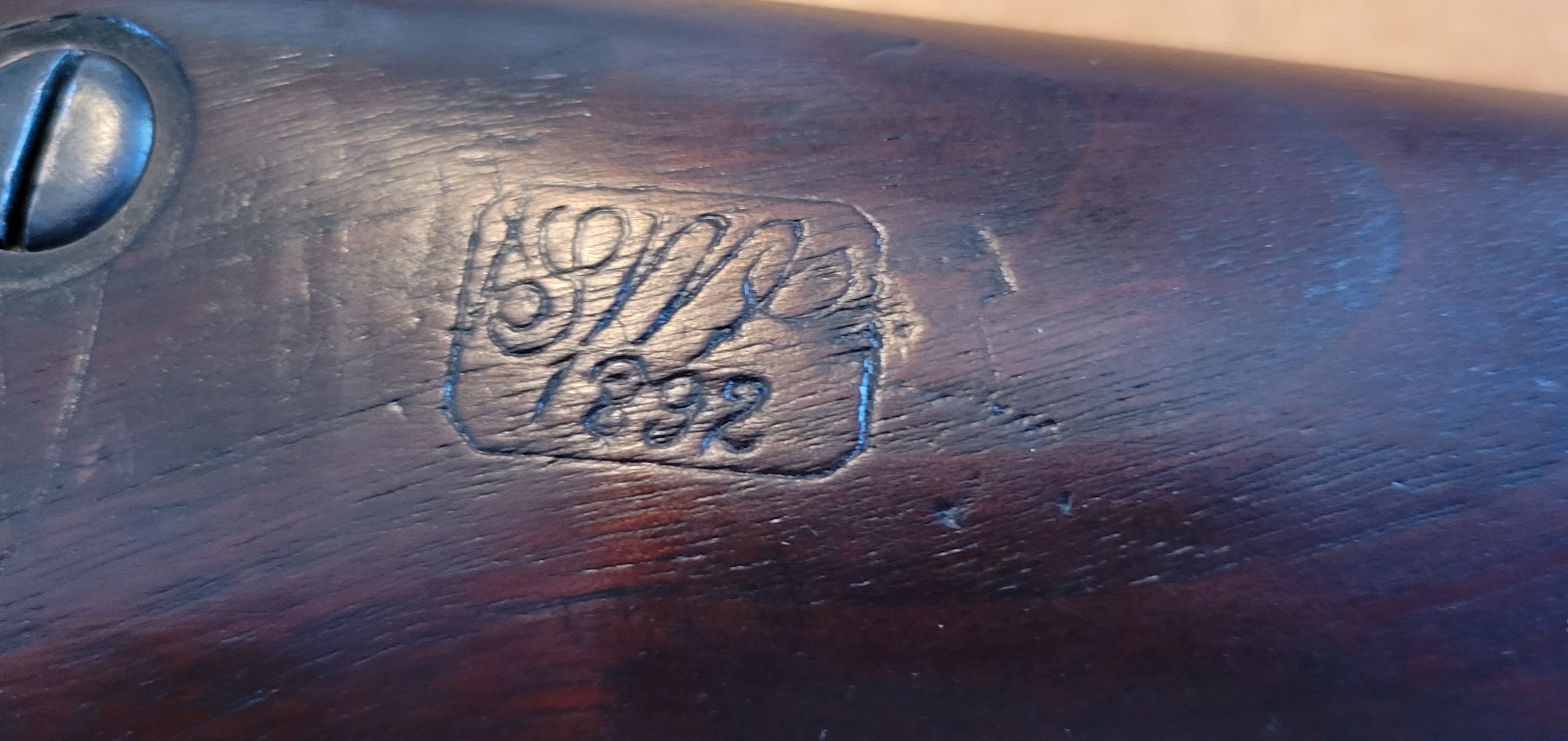

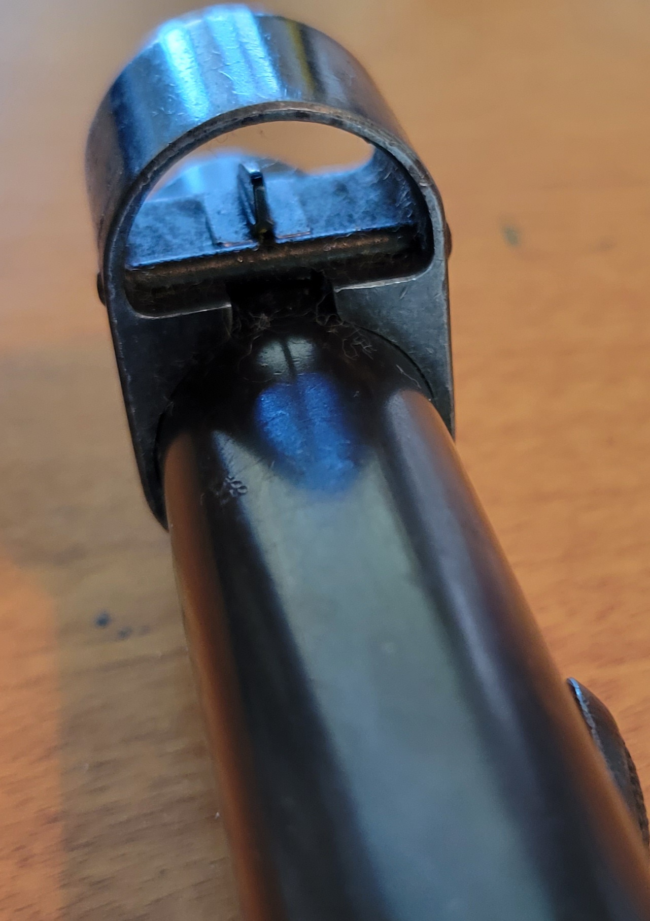

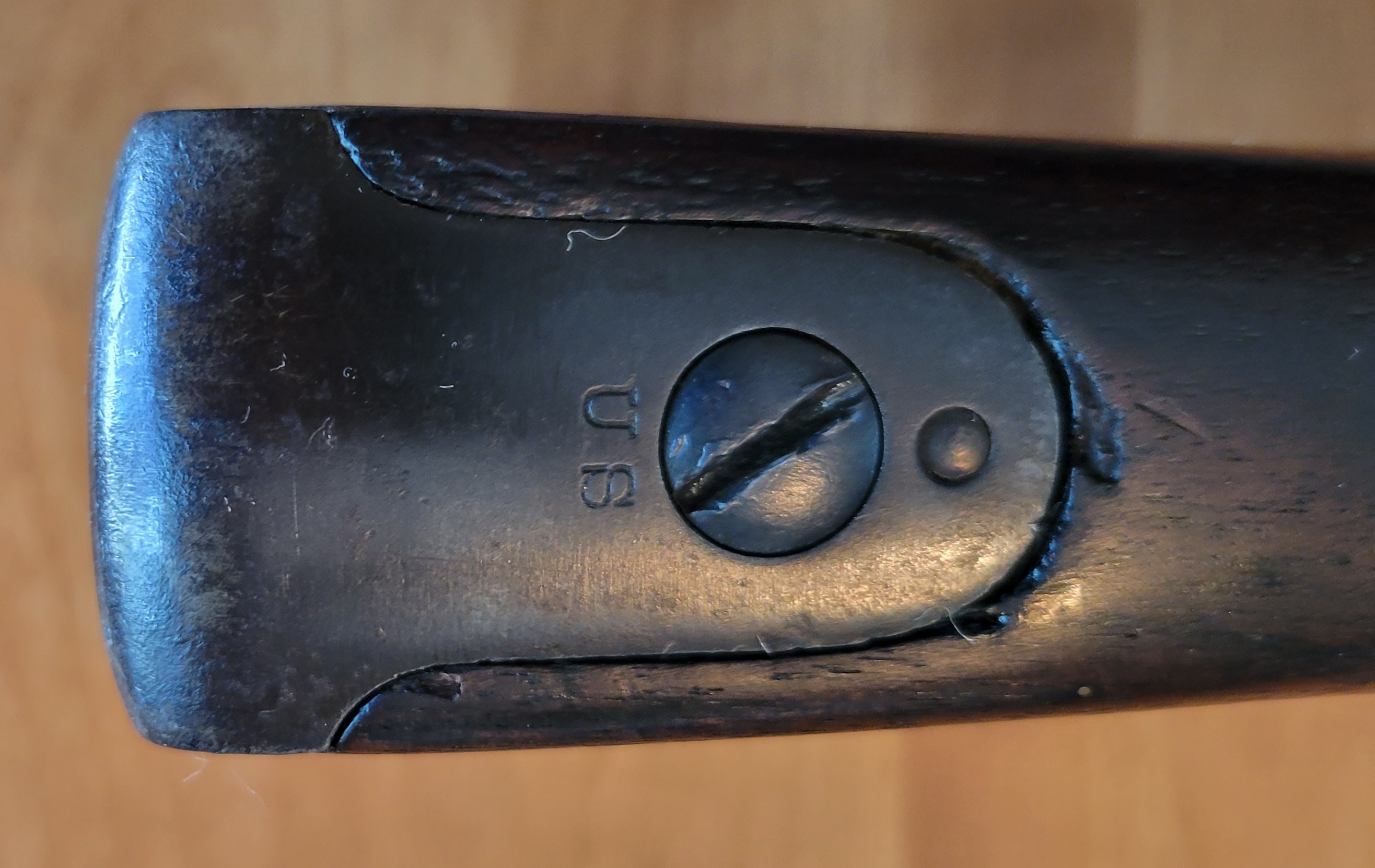

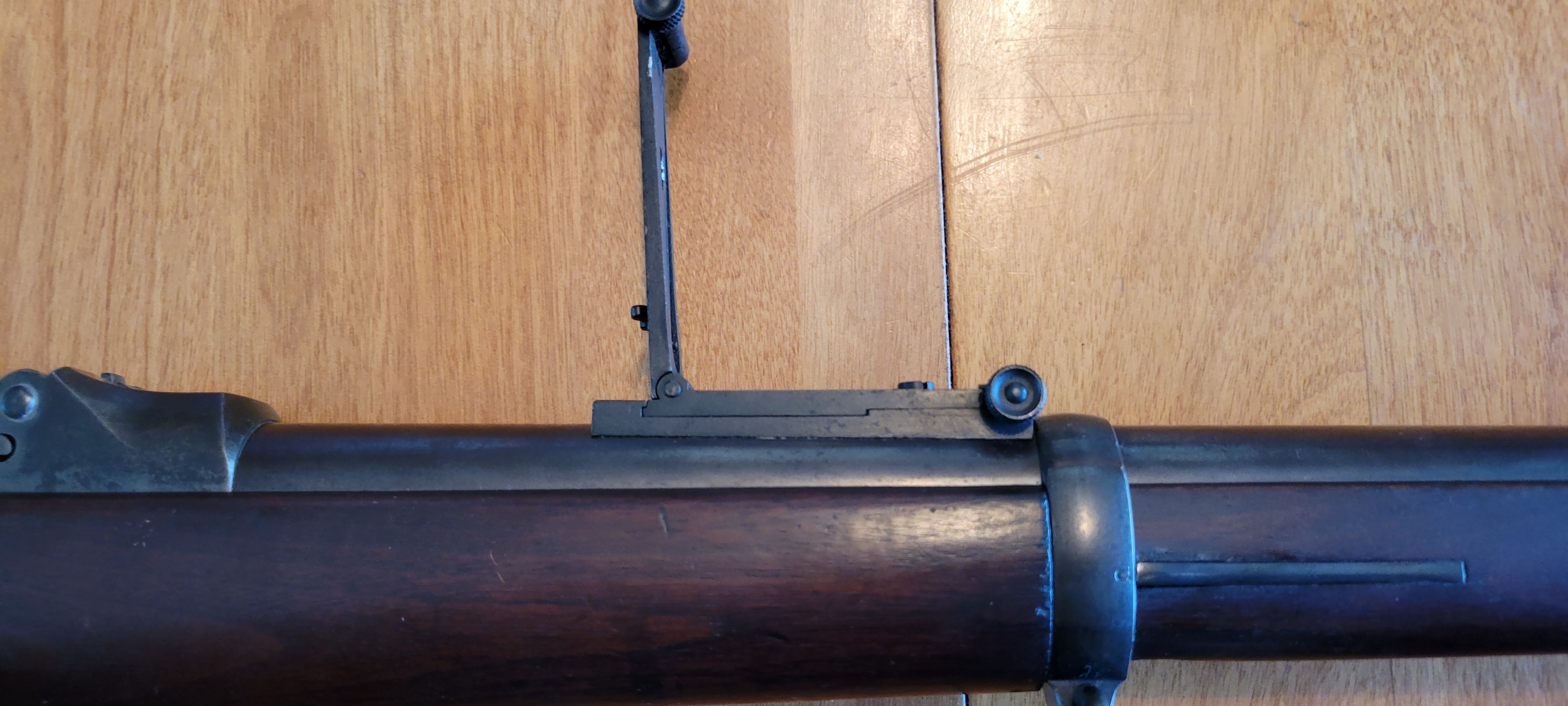

    Ok the rifle is mine now. After extensive hammering back and forth I got everything for $1100.
    In all I'm happy based on the overall condition of it. Lots of bluing left, beautiful case hardening on the receiver, great bore and muzzle crown especially for a 130 year old rifle.
    The good:
    Excellent bore and overall condition including nice wood
    Seems to be mostly matching with the front sight cover in place
    100 1x fired brass 200+ new unfired brass and 39 loaded rounds
    Approximately 600 bullets of 2 different weights
    7/8 ths of a pound of powder and wadding
    Approximately 220 primers
    Lee 3 die set with 2 shell holders
    Lee case length gauge new in package
    New .460 dia Boresnake
    Carrying case
    The bad:
    No Bayonet that's just some unidentified blued steel rod in its place
    Lockplate isn't original and what's there is undated
    Lockplate screws are replaced
    Trigger guard sling swivel is missing

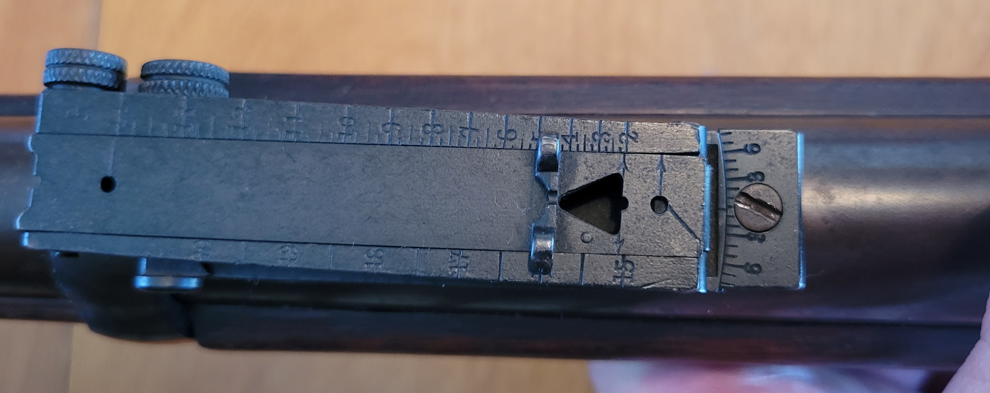

    Buffington sight is slightly loose at the pivot pin
    Missing chip of wood behind front barrel band

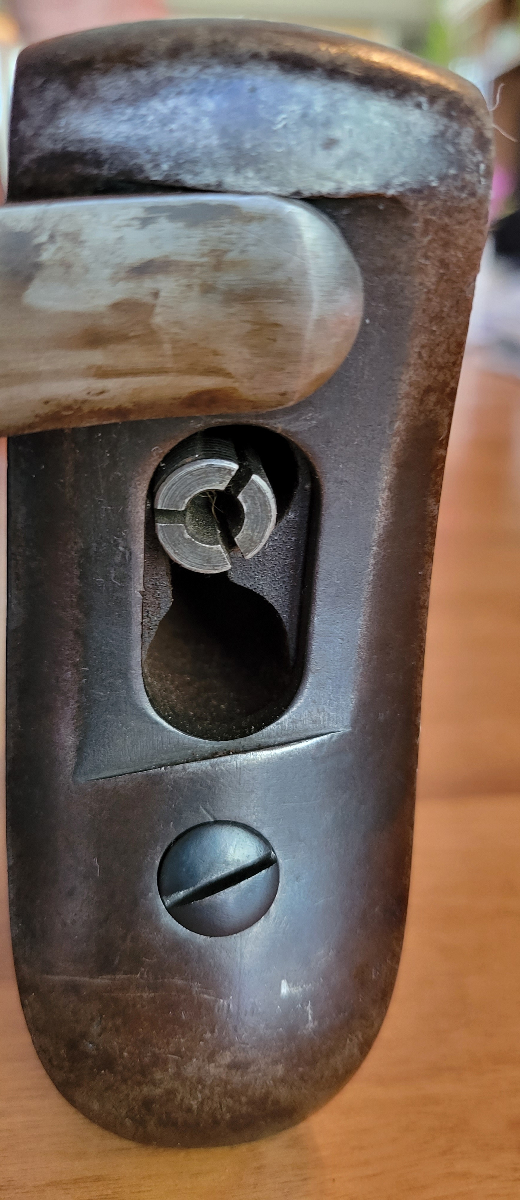

    Only 1 rod attachment in butt trapp
    Block release has been peened
    Photos of it are exactly as I picked it up haven't had a chance to clean it yet and seem to have loaded randomly for some reason. Seller said he hasn't fired it in 4 years but he did really well with it the last time he used it. He messaged me about an hour ago and regrets selling it already. I replied that I'm 20 years older than him so I'll give him the first option on it when I'm gone.

    Nice...good enough. I'd go ahead and make up a copy ramrod bayonet using the piece and the small needs aren't so bad. The bore looks like it could use a cleaning. I've never been able to figure out the Buffington sight, I'd be more comfortable with a standard sight. I guess a range report is forthcoming? I still think It's a good catch...

    I'm hitting the range later this week Jim I'll write up a report right after. I have no experience with this rear sight but it seems overly complicated for a battle rifle. I possibly found an original ramrod bayo for sale at trapdoor collectors. I've sent an email and am anxiously waiting for a reply. This will leave only the sling swivel and screw to be located. I love it when a plan comes together!

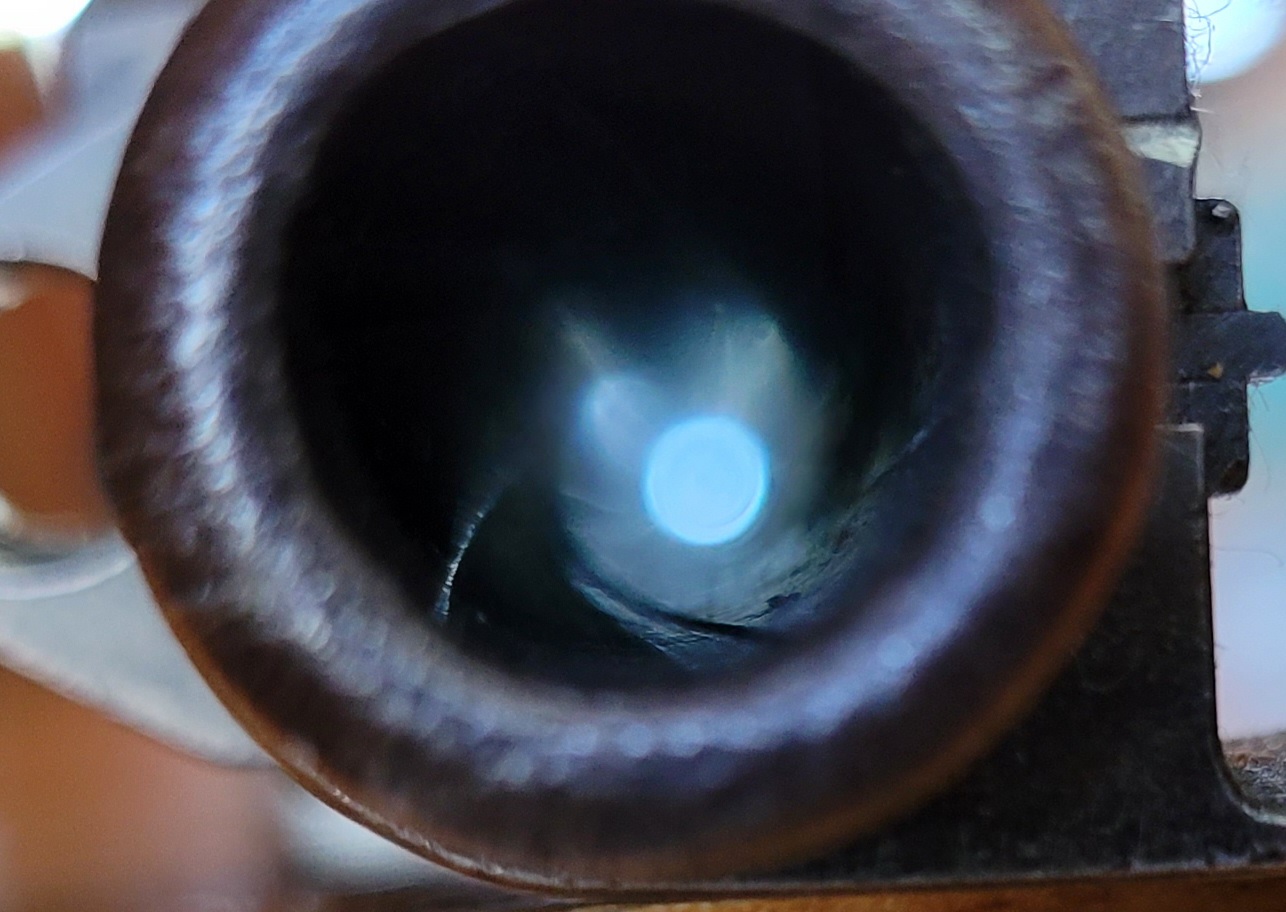

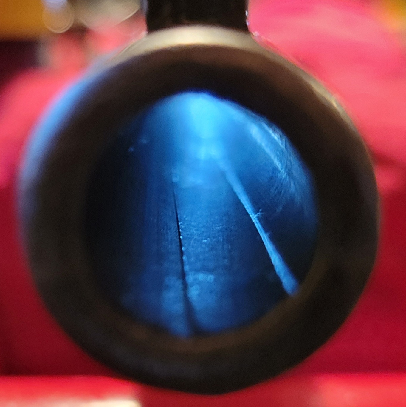

    So I took the rifle completely apart for an in depth cleaning and oiling.
    Several small parts are missing yet it still functions. Extractor spring plunger, pin for the ramrod retainer and one of the tiny springs that go with it. Found some rust under the lockplate. The middle band is the stacking swivel band for a carbine. I have an email out waiting for response for a ramrod bayonet. It's moving along very well.

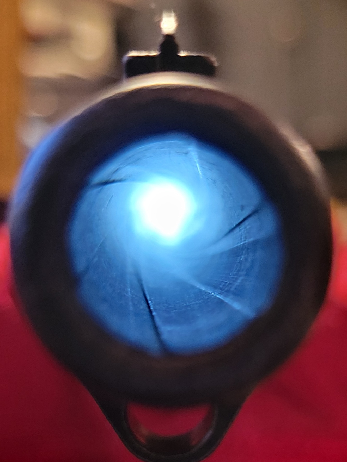

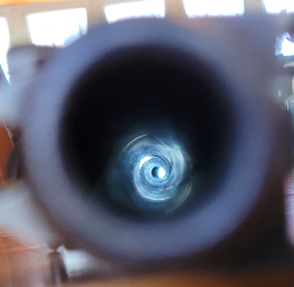

    Have been cleaning the barrel and am about half done. That hasn't been done to it in years have some pictures of the bore condition. I'm not surprised by it even dirty it showed strong but wow. Can't wait to get to the range.

    Nothing wrong with that one at all.

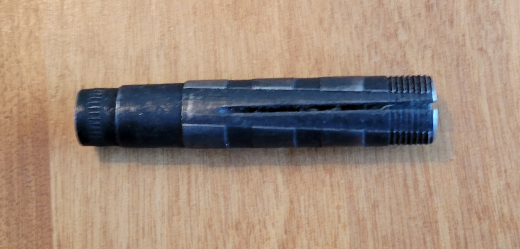

    Springfield M1888 Trapdoor Updates

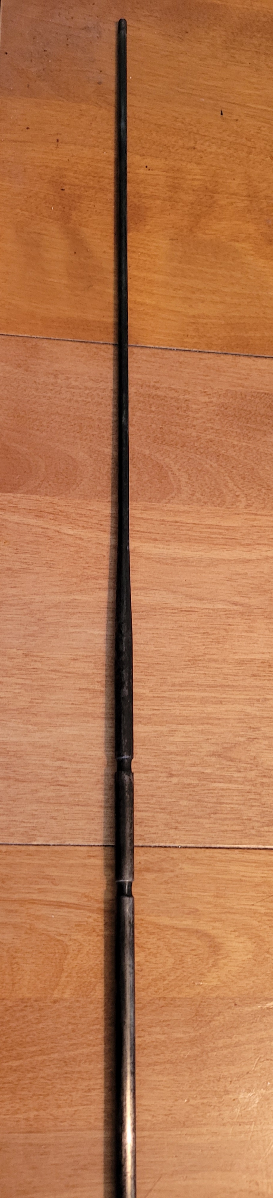

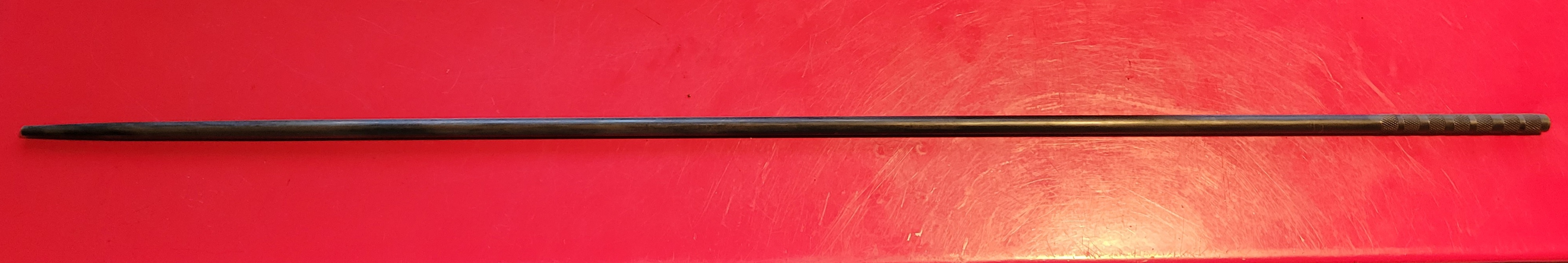

    So the rod-bayonet arrived today in good order. Some patina as expected with an item of this age. Good solid never flattened point, excellent threads on the other end and as straight as the day is was made. Took the rifle to the range on Thursday and did somewhat acceptable. I did a write up in range reports if anyone is interested.
    After learning a lot about these rifles in a short time it's become apparent there are several incorrect parts on this rifle and a few missing altogether and I am hard on the trail of correcting all the mistakes I've inherited.

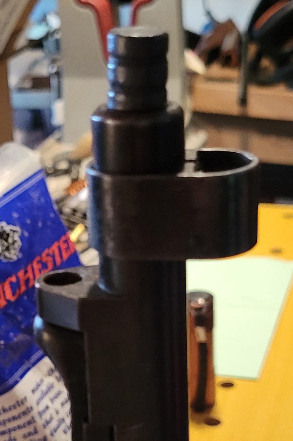

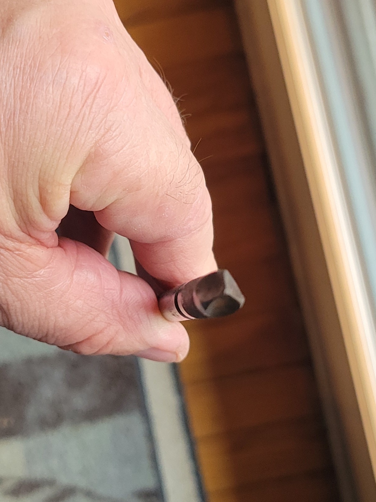

    Right now I'm doing a barrel soak with Hoppes. Chamber plugs for 45-70 have been discontinued everywhere I looked so it was up to me to make my own. After trying several different cases I found a .243 with the neck hammered flat and a 7/32"x 11/32" O ring in the extractor groove makes an excellent water tight substitute. Will keep barrel soaking for 24 hours then scrub well and give an update afterwards.

    The barrel soak went very well and the barrel is now as clean as it's ever going to be with spotless patches coming out of it. Apparently the barrel wasn't so bad perhaps because of the cleaning I gave it before taking it to the range. Although darkened the Hoppes was still see through which is the opposite of how it came out of my P14 when I soaked that. The solvent came out of that barrel looking more like mud.

    That barrel looked about perfect from the beginning. Something we seldom see here...

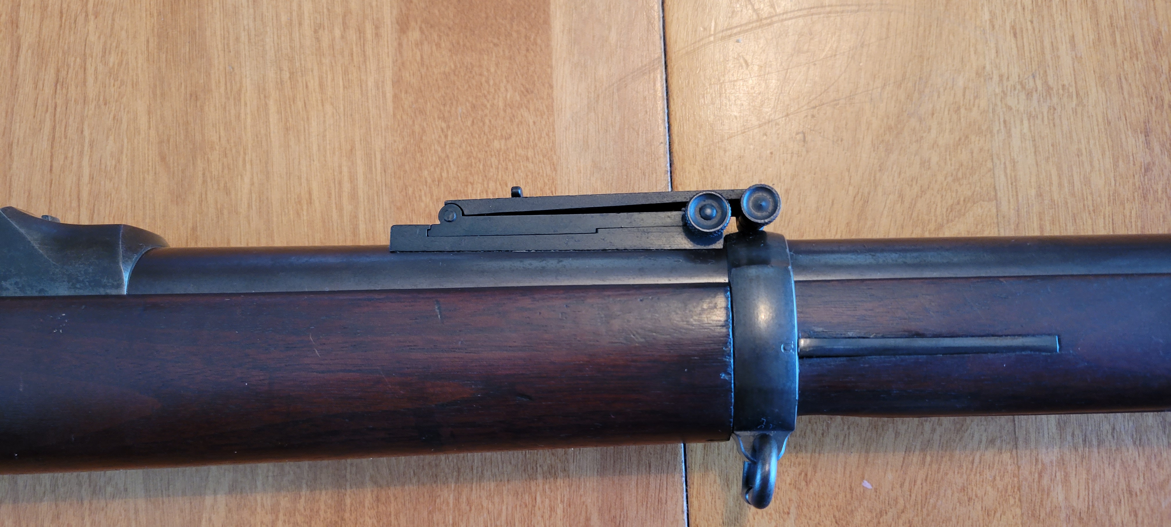

    So the little box of goodies from S & S arrived today with almost everything I need. Reproduction rear sling swivel and screw, spring plunger for extractor, spring for ramrod retainer, middle band with indent for Buffington sight, extra tall front sight and pin.
    I'm going to fire it before making any front sight changes now that the rear sight is laying flat. It was about a foot high so I'm assuming it may drop by 6 inches but we'll see. With the spring plunger in place the extractor really kicks out the brass where it was gently pushing out of the chamber. After putting the block in with the spring plunger in place now I understand why so many are left out.
    The pin for the rod retainer is still missing and I may have to make my own as no part suppliers have one. The top band is still incorrect but that can wait because it doesn't affect function and funds are limited.
