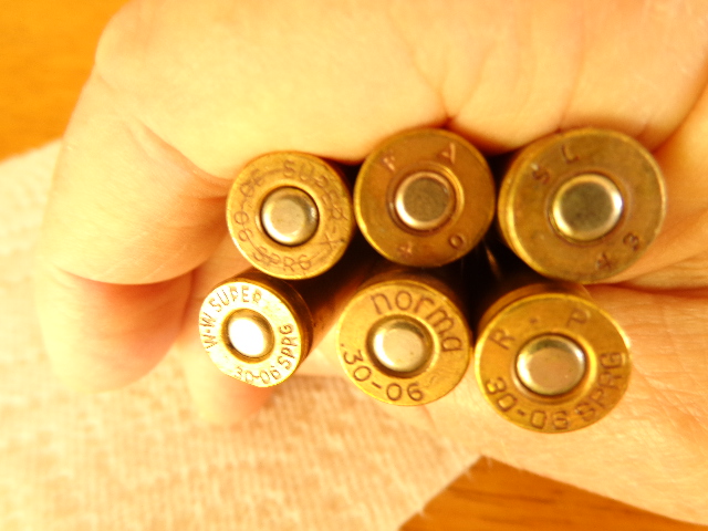

    Speaking of headstamps in general here is a handfull I just grabbed from my handy box of reloads. Most of my .30-06 ammo was inherited from my father whose brother was a gunsmith who sporterized the family 1903 and reloaded most of the ammo I have in the early 1950s. We have a lot of the SL 43 stamps.

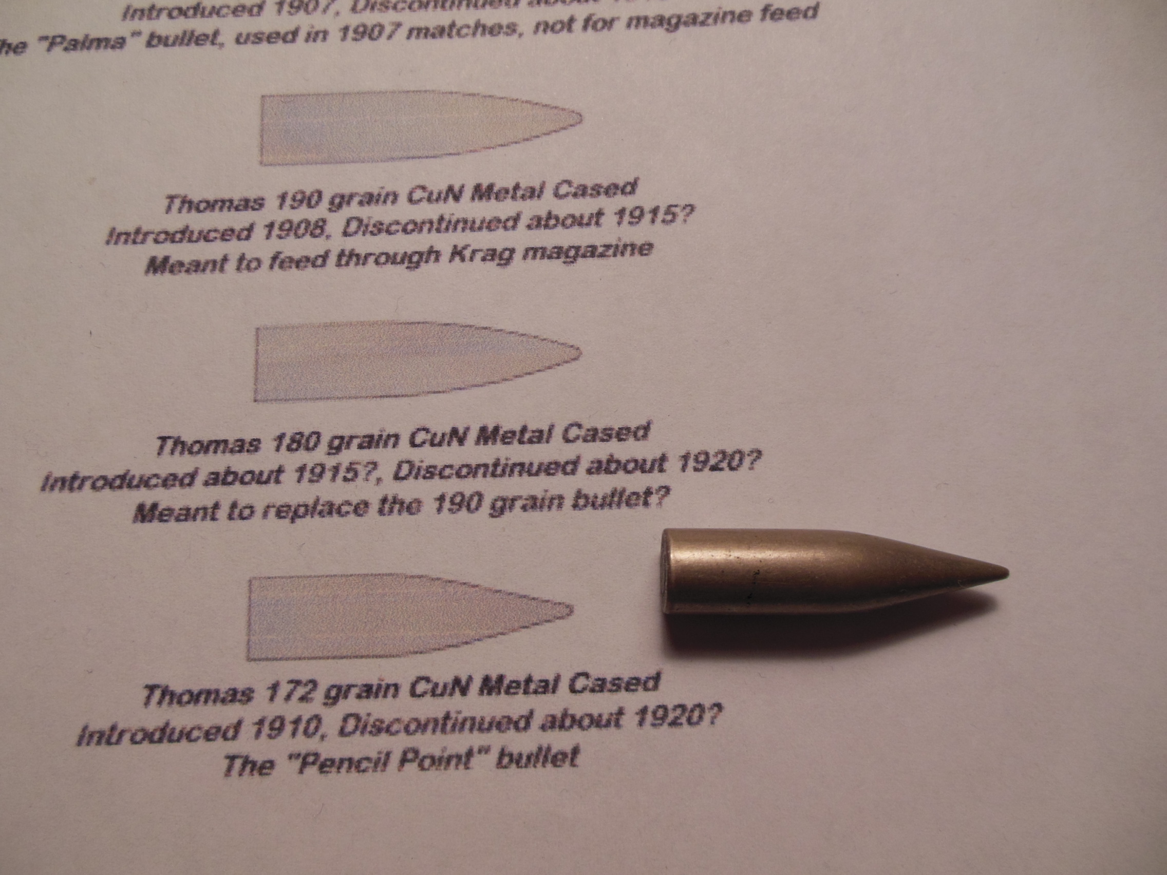

    Thomas Pencil Point pre WW1 Match bullets
    The Thomas Pencil Point match bullets were first used in the 30-40 Kragicon for match shooting and later developed for the 30-06 cartridge in both 150gr and 172 gr loadings. REM-UMC also loaded cartridges for match shooting with the Thomas pencil point bullets. Some pre WW1 matches were won by shooters using these Thomas bullets.

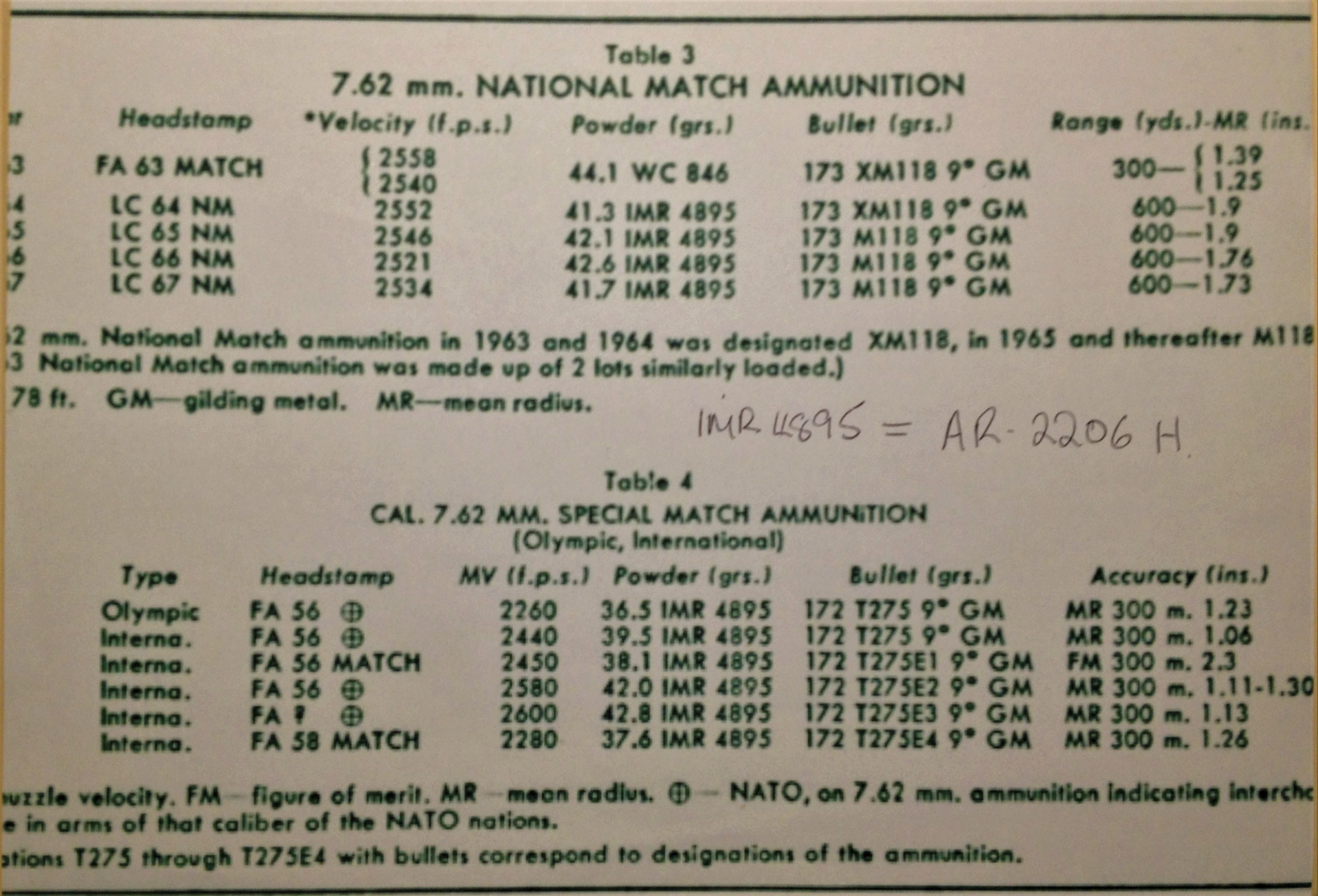

    7.62 NM loads
    Whilst not NM 30/06 loadings here are some NM .308 (7.62mm) loadings for you to try if you wish to, once again I accept no responsibility for these loads being used.

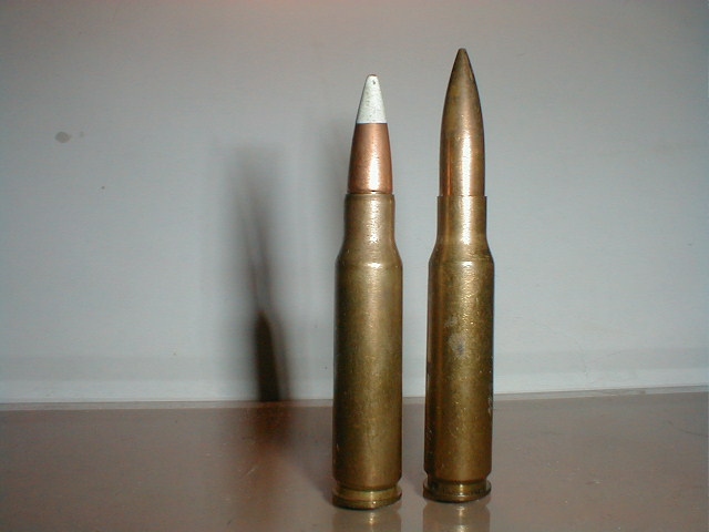

    very early 7,62mm National Match cartridge
    My photo shows a very early 7,62mm National Match cartridge headstamped WCC 58 loaded with a 200 gr bullet. Because of the total length, these National Match cartridges could not be loaded into an M14icon magazine as they were too long. These were used for slow fire matches being hand loaded into the chamber.
    The other cartridge was called the "low recoil" M256 with 82 gr steel bullet and the M256E1 with a 90 gr steel bullet. These loadings were designed to control the M14 rifle in full auto fire
    and to make these M14 rifles available to the small statured Vietnamese troops. these was even a special modified M14 stock for this program. The whole plan failed as the Vietnamese only wanted the M16 or M1 carbine
