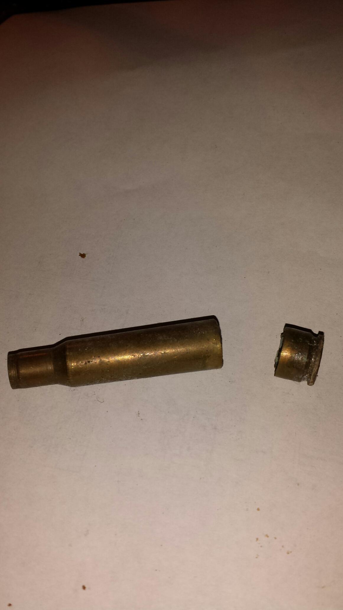

    Several years ago, I checked about a dozen bolts in the same rifle, and all passed a "GO" and rejected a "NO GO", so the odds are that a new bolt will be correctly headspaced. Get it checked regardless. Incorrect headspace will give you a bunch of these.
