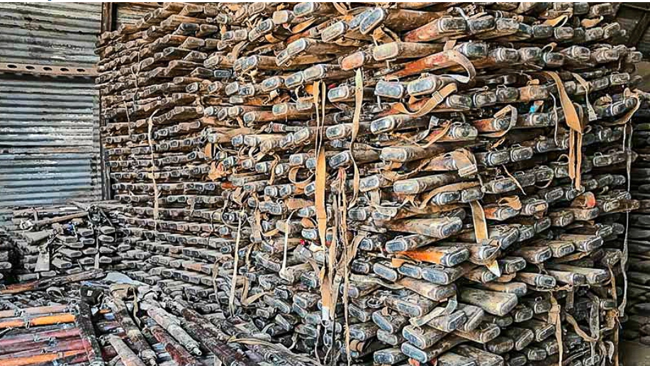

    Yup - its one of these well cared for No5s (does the bolt number match the action ?)
