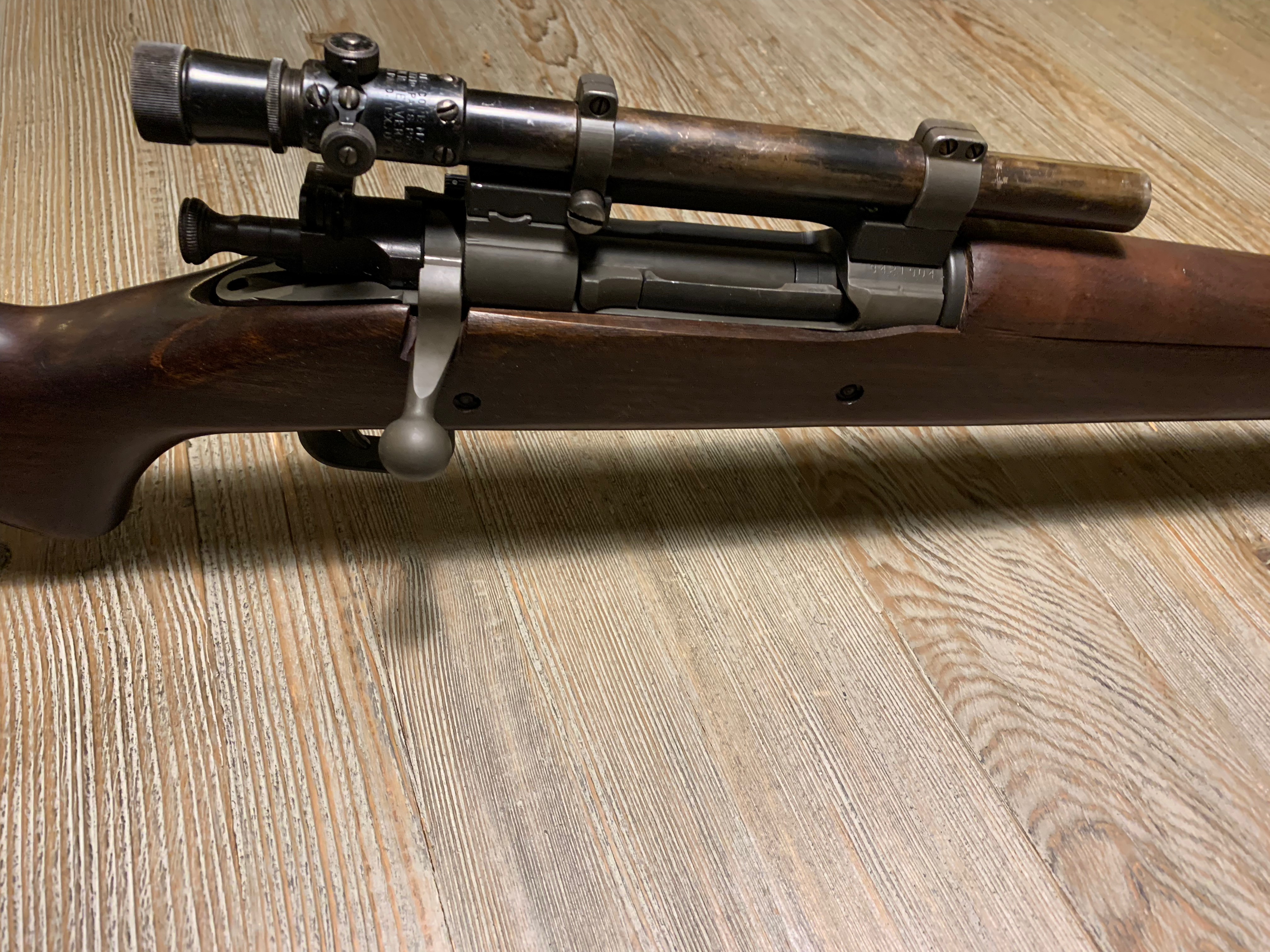

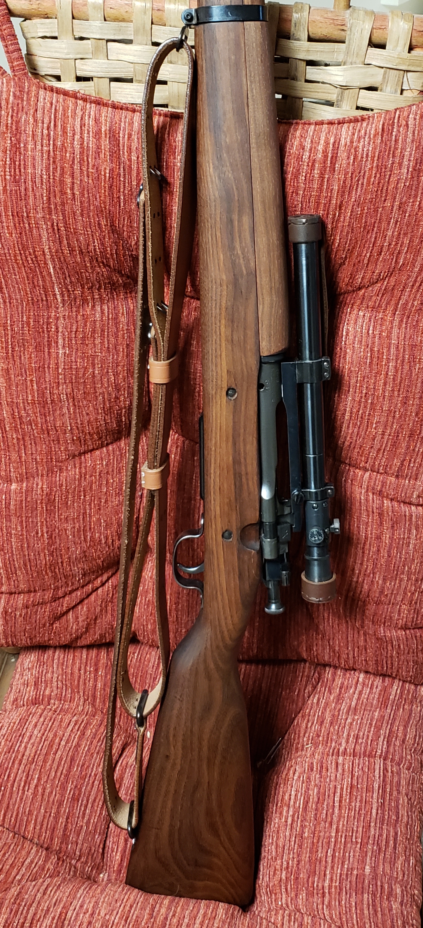

    New member here. I recently acquired the following 1903A4:
    Serial#: 3421904
    Barrel Date: 10-43
    M73B1: #23298
    It looks to have had an arsenal rebuild (blued -> park) and has a Keystone C-stock with the only mark being the inverted K in the well.
    The scope appears to be rotated several degrees clockwise around the barrel so I need to figure out how/if I can accomplish that fix myself or need a smith... waiting for a Tipton Ultra Gun Vise.

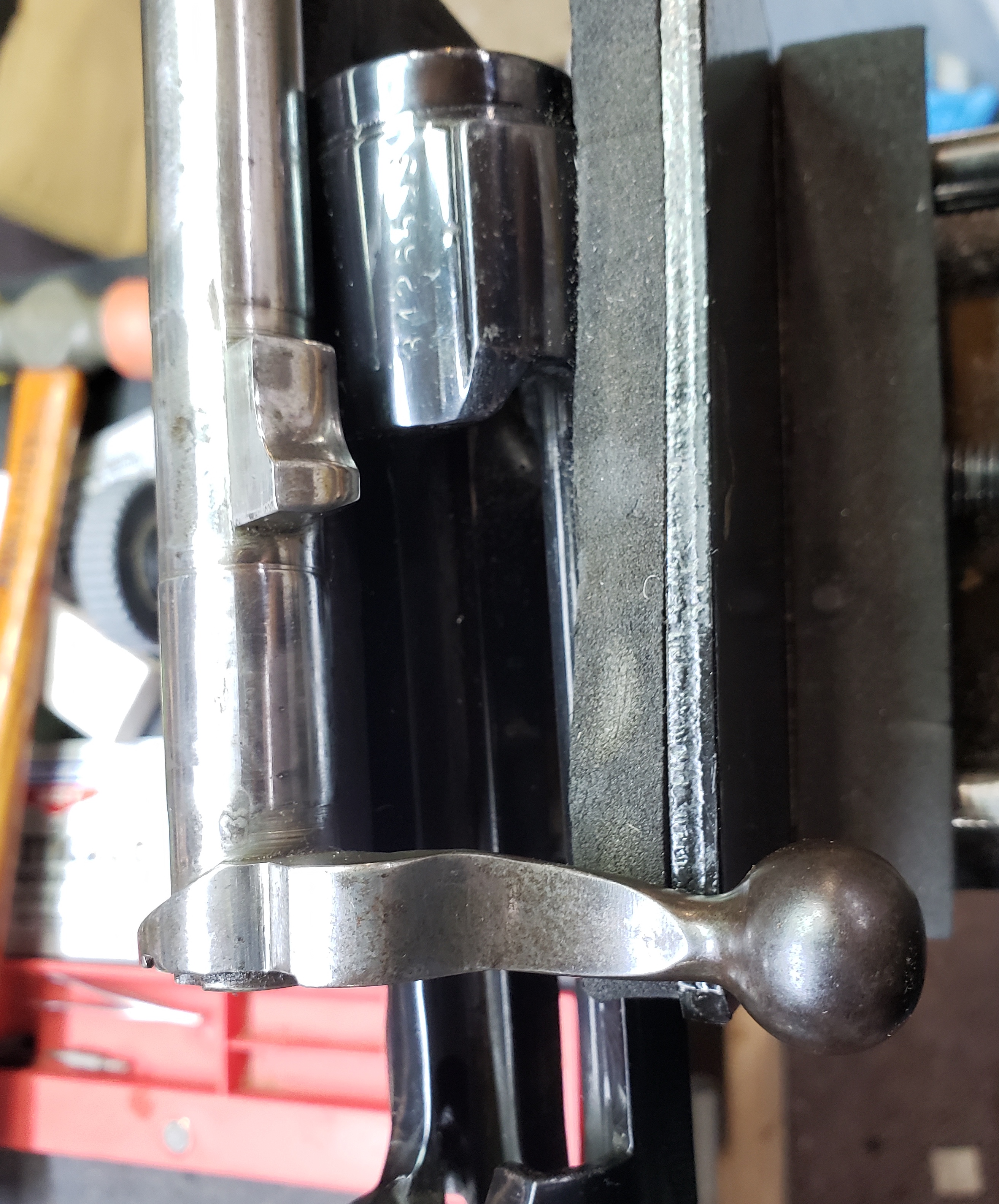

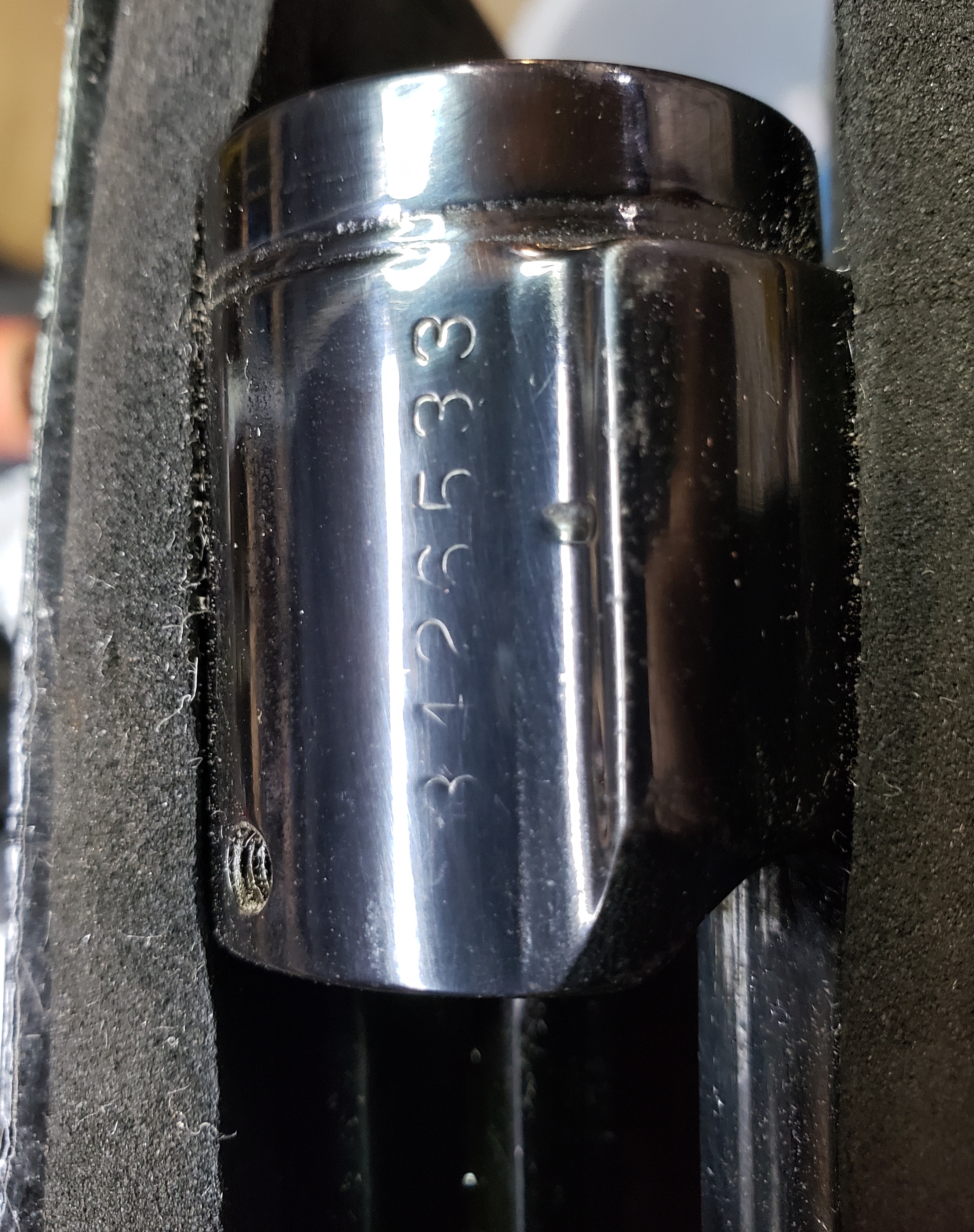

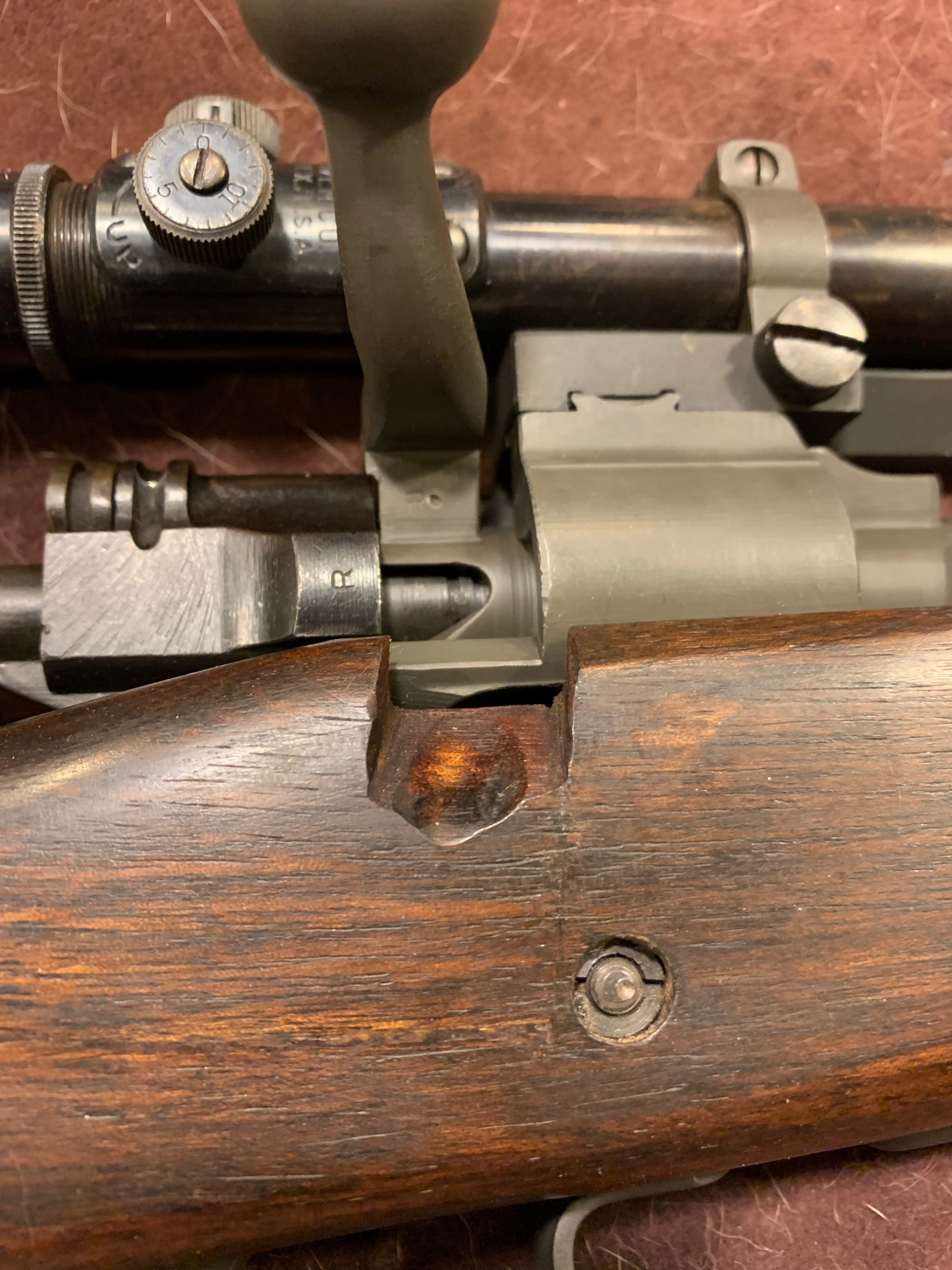

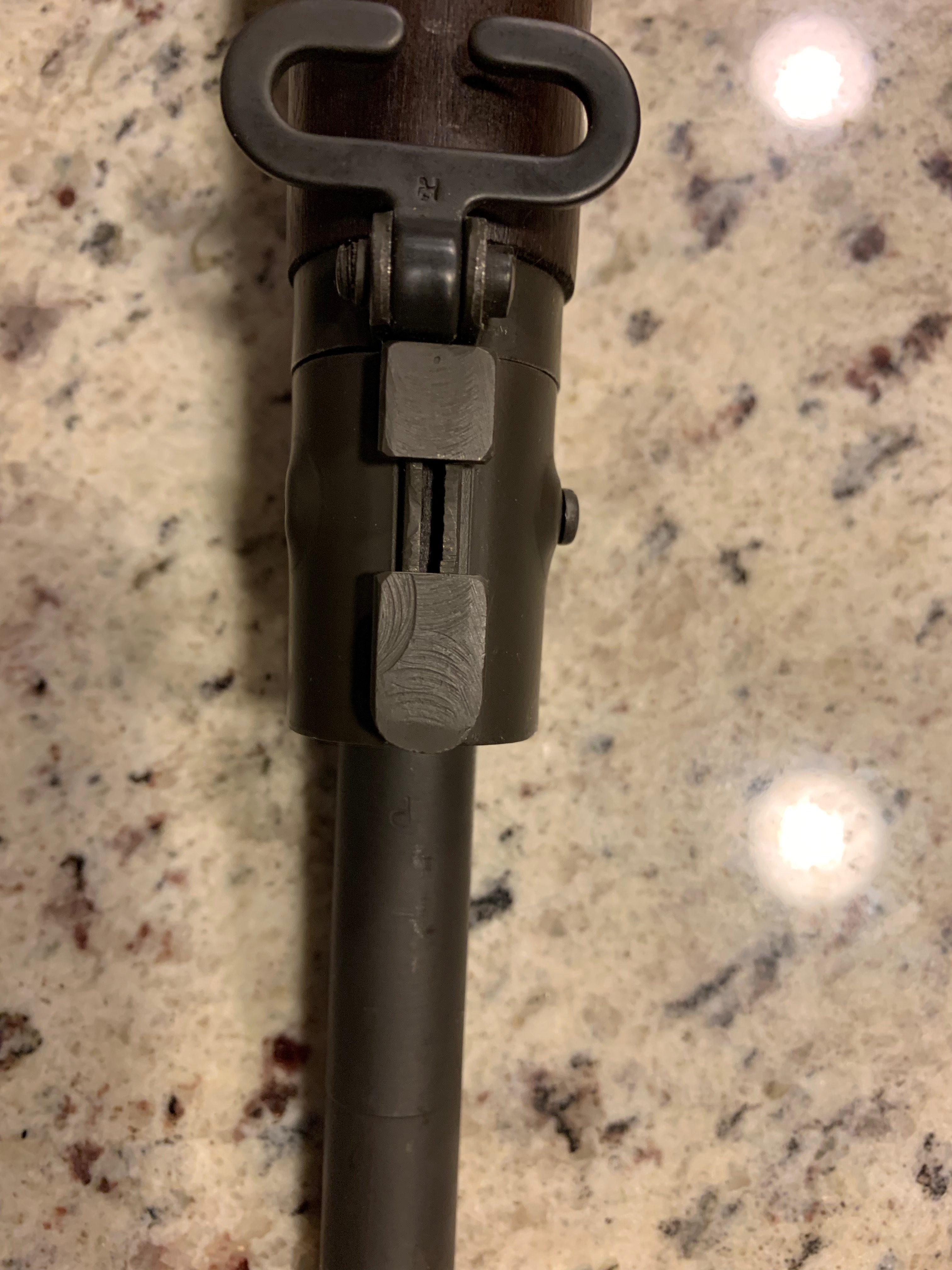

    nice rifle. welcome to the forum, neighbor! Can you post a pic of the underside of bolt handle recess in the stock? as well as the underside of the barrel beyond the forend?
    You can remount your scope pretty easily. make sure you have a good set of screwdriver bits...only use one that fits absolutely perfectly. I would also recommend a torque wrench for re-tightening. 15 in*lbs is all it takes.
    Requested pics added to original post.

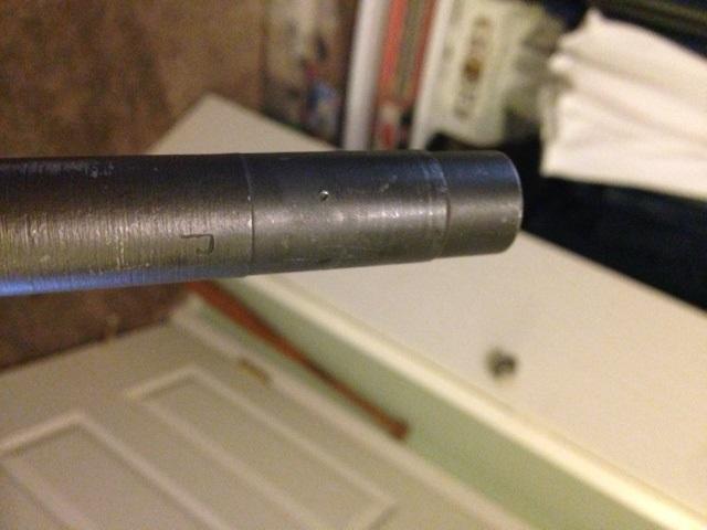

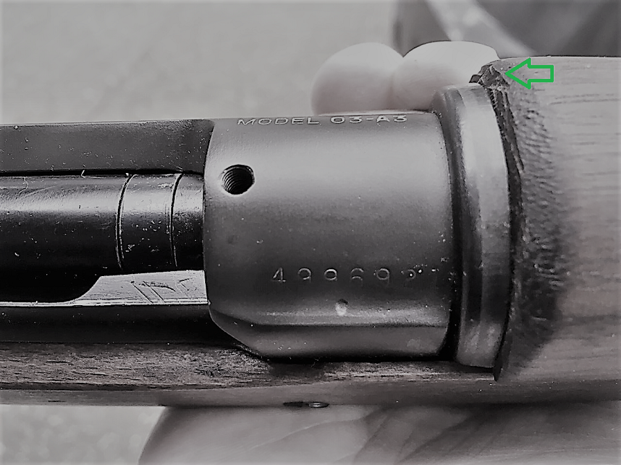

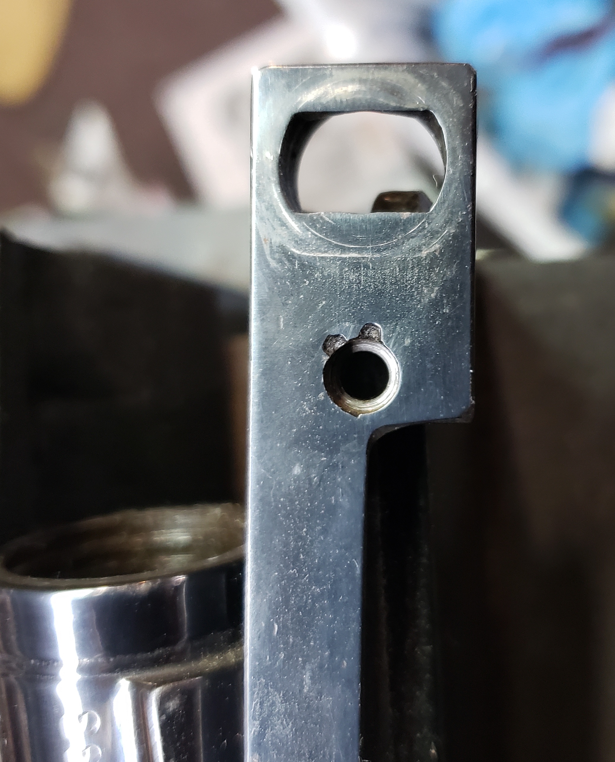

    Original barrels should have a punch mark on the underside of the barrel, about an inch from the muzzle, like in the photo below.
    Original stocks have a very distinctive recess for the bolt handle, like in this thread...https://www.milsurps.com/showthread....l=1#post205733
    I don't have one with it's original barrel and stock to compare.

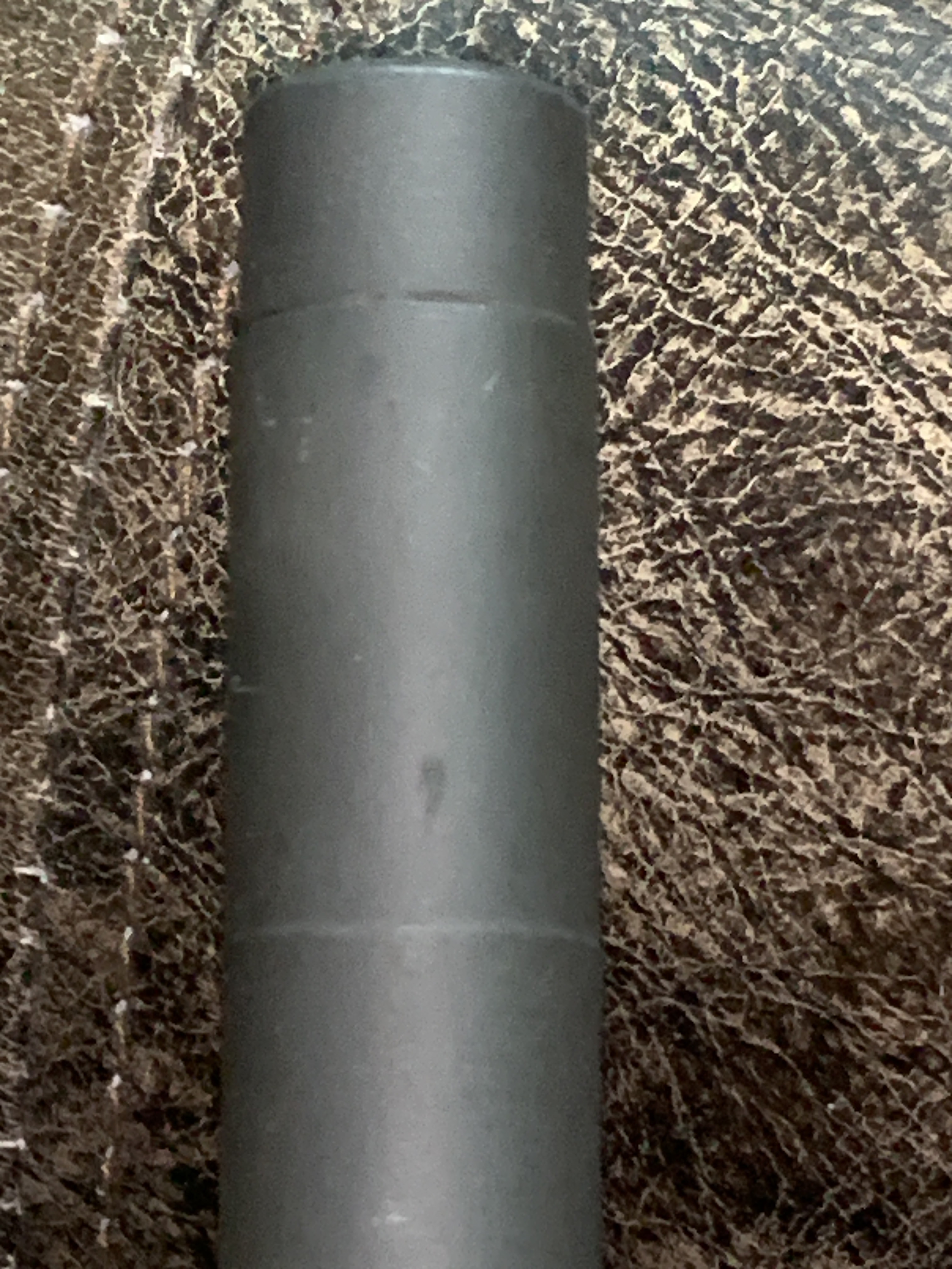

    I took another pic of the underside of the barrel in natural light and it seems to show the remains of a punch mark.
    Agreed on the bolt handle cut-out... I assume it was a DCM gun that was re-stocked back in the day.

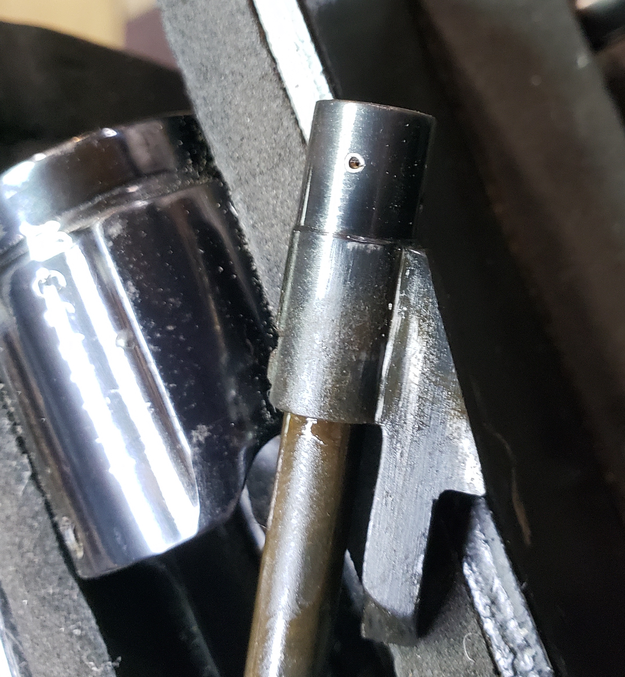

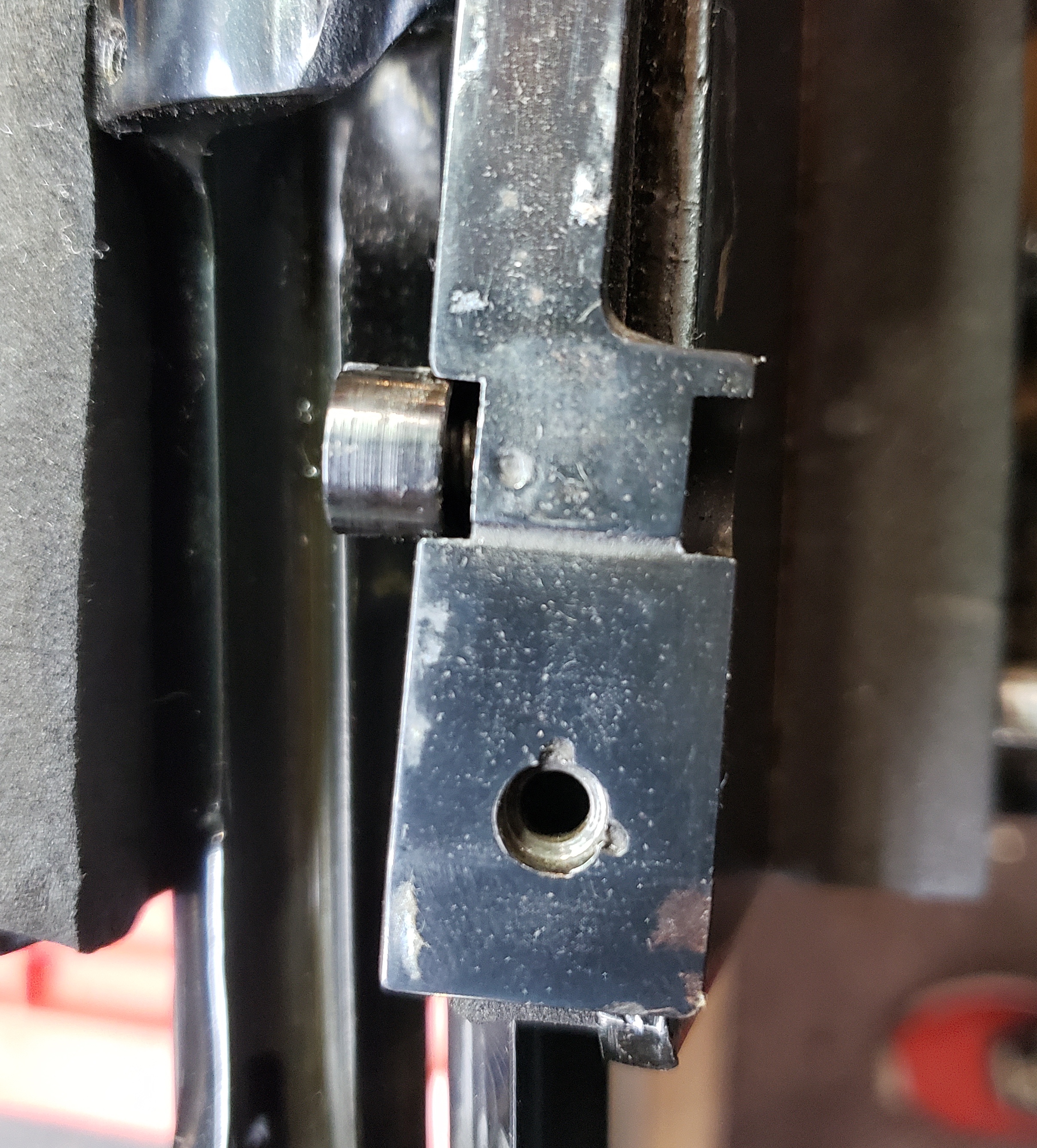

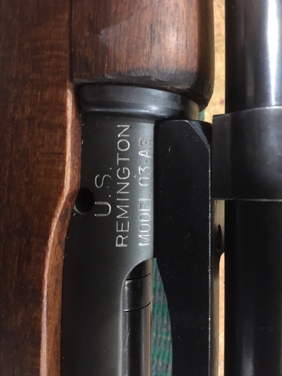

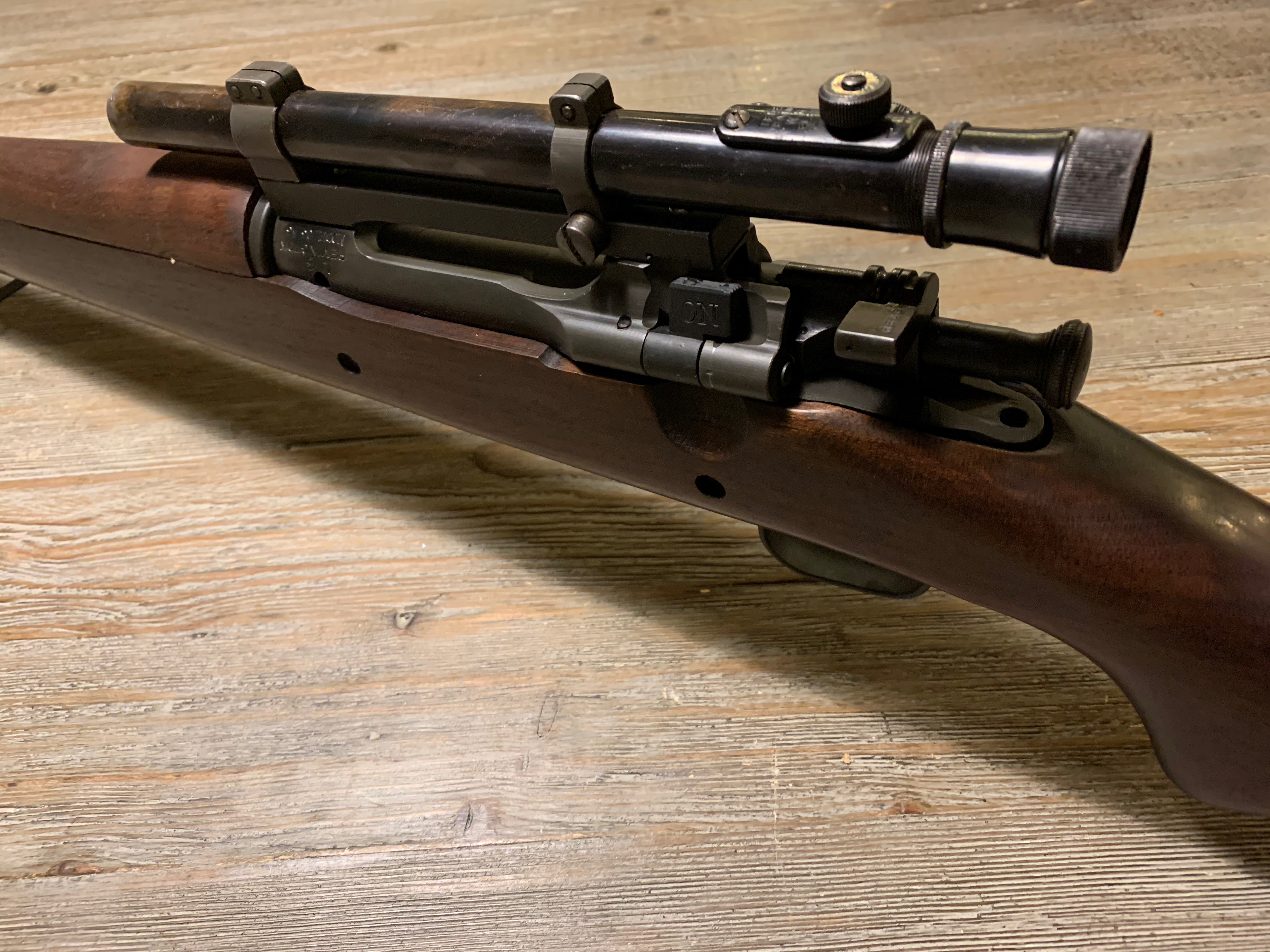

    Your pics are a little too dark, but I think I can see the "problem" with the barrel. It looks like the Redfield mount is directly mounted on the barrel, not shimmed at the front. If so, you can order a set of shims from Brownell's. I don't know how a gunsmith does that & gets the correct height.

    Jan 2020
    Today @ 06:56 PM
    Virginia
    1,717
    07-10-2025
    07:28 PM
    Quote Originally Posted by Neal Myers View Post
    the original mount has a sort of tab looking cut in the rear. some rough elevation can be adjusted by filing the rear in this area - then shims in the front if this isn't enough. I use small cut out beer cans.

    turn your scope to the left so the top knob is facing left and your right knob is on top.. i would say this is a parts gun, that had the barrel replaced as well as the stock, it looks like the stock had a repair behind the bolt cut, and then they for some reason, opened the bolt notch a little, base is a later commercial base thats been parked and added, youll need 2 shims to get it to zero, there is a seller on ebay that sells original shims, i would remove the base and look under it , the receiver looks like someone welded on it , as the dark area right by the front ring, but that could just be the picture, not to scare you, but iv seen a good fake that had this issue, they ground all the markings off, and got the steel hot, then lazer engraved the markings spread apart to make them look right..
