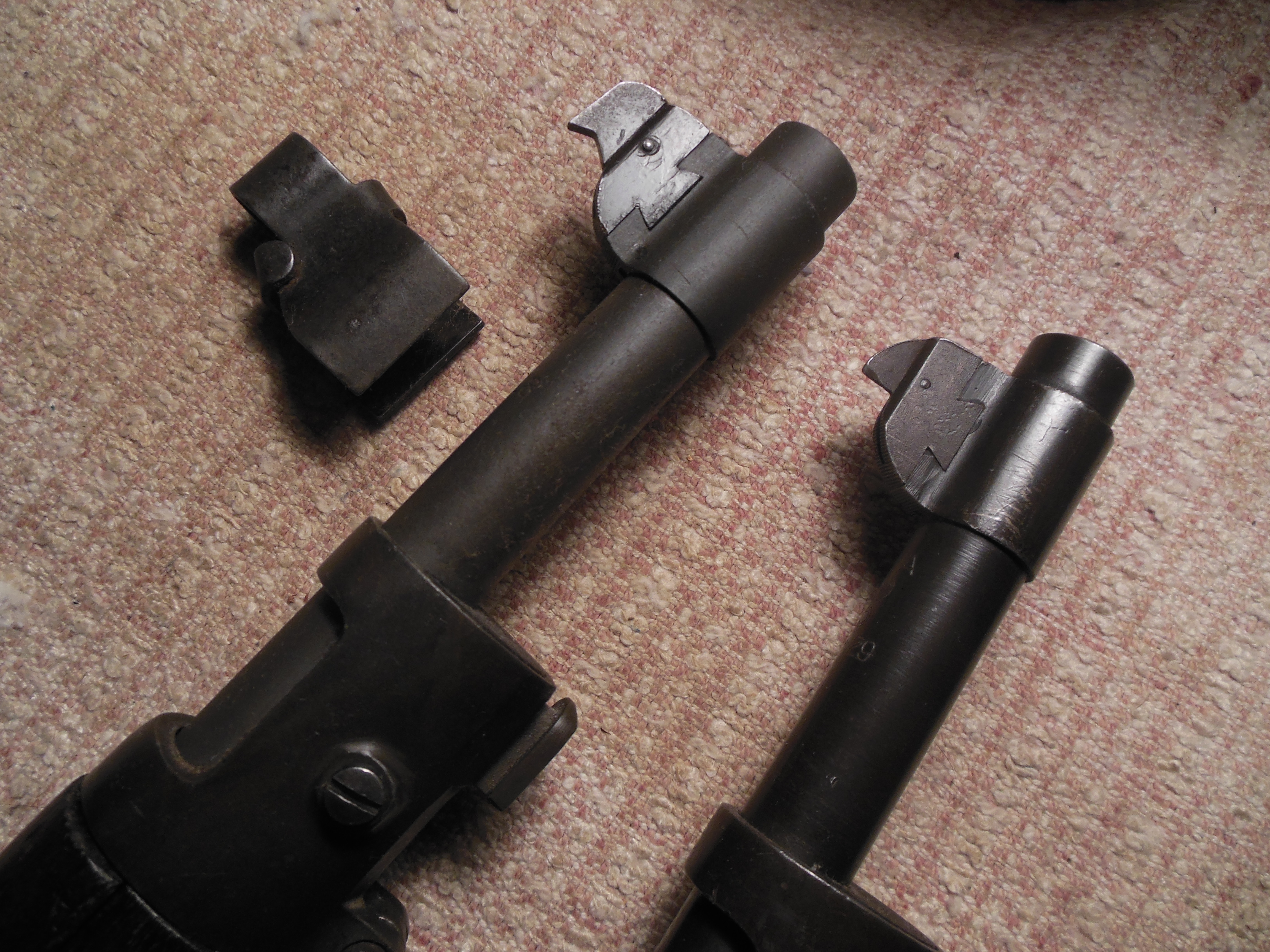

    I think you will have to fabricate a thicker front sight blade for the 1903A3 as the original USMC sight has the dovetail feature shown at the left in my photo

    I think you will have to fabricate a thicker front sight blade for the 1903A3 as the original USMC sight has the dovetail feature shown at the left in my photoAttachment 134525
    The blades for 1903 and 1903A3 front sights are completely interchangeable, and are pinned into the slot in the dovetailed base or the one-piece band, respectively - the slot is ca. .050" in width, and the lower part of the Marine blade is thinned to fit the slot. If making a blade, you may make the top of any convenient width, and some shooters find the Marine .100" too wide for fine accuracy.
