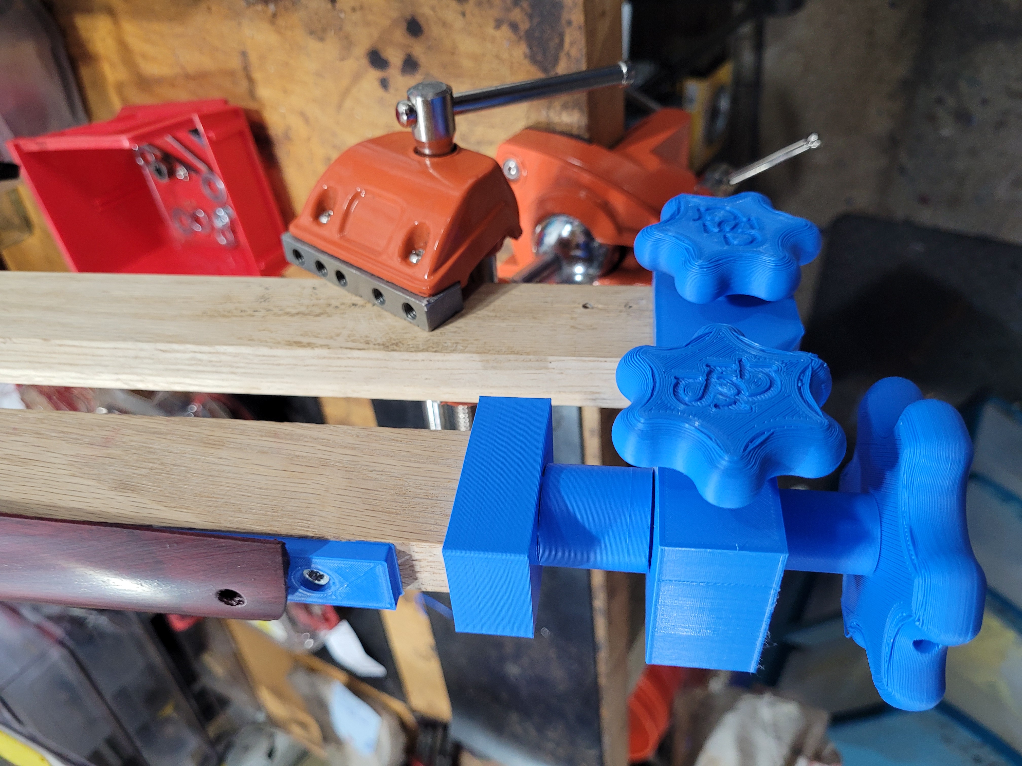

    I've been doing a lot of checkering and finishing lately - mainly cleaning up and beautifying old sporter stocks left over from restorations. There seems to be only 2 options for cradles on the market already made - MTM which is basically a 2x4 with holes in it for $100, or the over engineered version at Berry's Mfg. for over $400. Both are generic in the actual fixture, which is fine for checkering but not so useful allowing 2 hands while scraping or refinishing a stock. So over Christmas I decided to teach myself enough CAD to make me either more useful or dangerous. I designed and made the following updates to my cradle...
    The ends are generic, with a faceplate that has threaded inserts allowing for the attachment of any adapter plate you wish to design. Pictured above is for M1icon Garand stocks. The front fits the stock ferrule, the rear is tapered to snuggly fit the cleaning kit holes. The faces slide on a dovetail so there is no wobble when rotating the stock, so everything stays nice and tight.
    Given the price points of the commercial options, I decided to make an entirely 3d-printed setup. For a prototype I built a smaller checkering fixture for pistol grips.
    The ends slide on to a 1x2 beam. The side knobs tension the main spindle and lock the uprights in place. With a dab of grease on the spindle, tension can be set so that everything is locked in place while working, but moveable with a little more force.
    I'm thinking of printing some kits - end user just needs the 1x2. I was thinking the first few tries I'll send to contributing members for just shipping. Just let me know what end adapters you need. I likely have the rifle in my safe to design it.

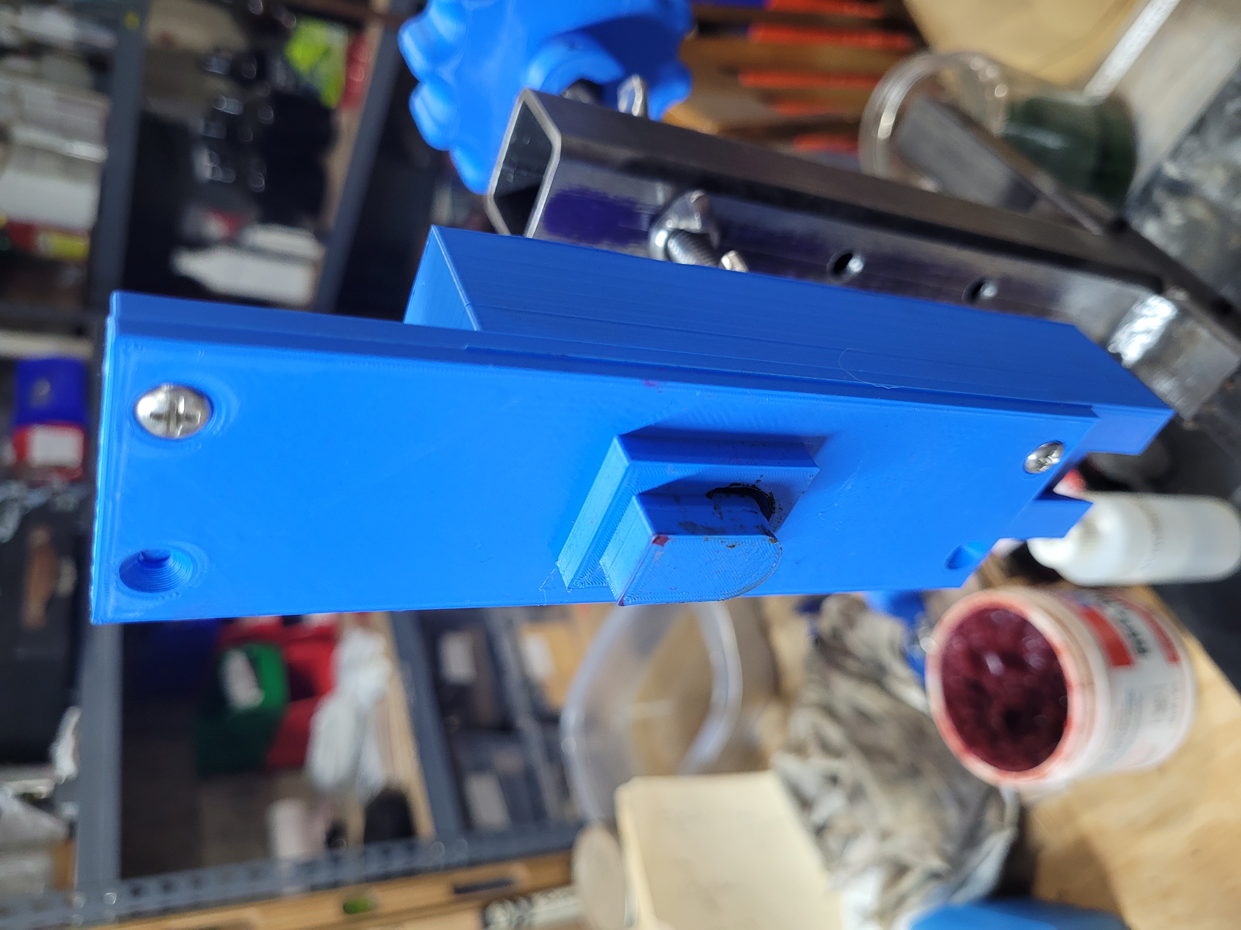

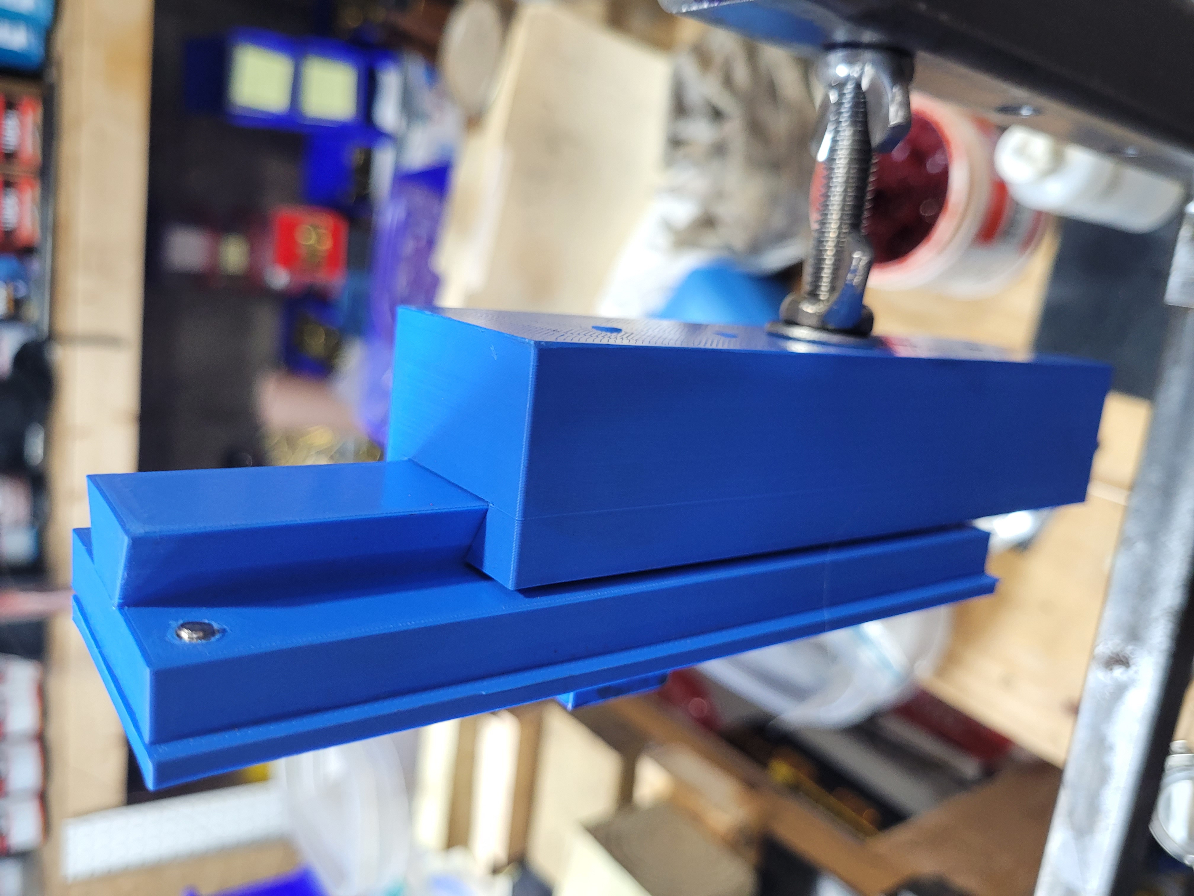

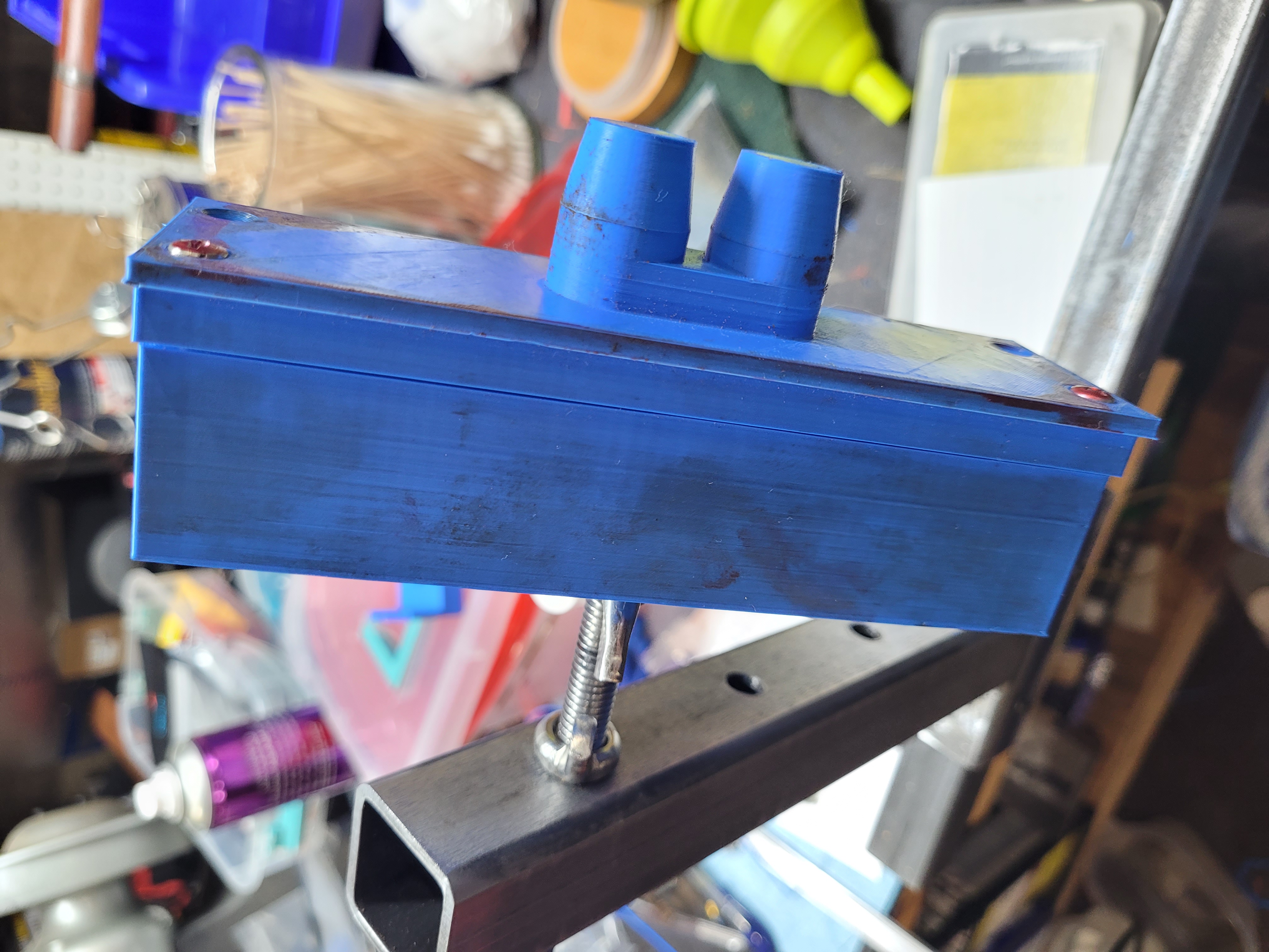

    My base (in the first set of pics) is a 1 in square steel tube - easy enough to get at the big box whatever length I need. I have a 6 foot piece for when I checkered a full-stocked long rifle a guy built. My ends are made of 1+1/8 square tube which, after cleaning up the inside weld, slides smooth and tight over the main beam. Tapped for a pair of set screws to lock it in place once set. Originally, I had steel brackets welded to these bases, then used wood to make the faces to attach stocks. The brackets had enough flex to make the whole thing sloppy...So I welded square tube to the base to make new uprights, and 3d-printed the faces. It's easy to contemplate and make ends to lock everything in place for checkering - the two commercial offerings basically use the same generic idea. But for finishing, sanding, scraping, etc. I wanted access both my hands along with some room at the end of the stock. I dare not show too many pictures, lest my very ugly stick welding skills become a focal point
    I did that side-by-side stock I posted about in my original setup, making an adapter that screwed into the buttplate screw holes. The problem is that unless the butt stays square to face of the cradle as you rotate, it all becomes sloppy and loose. That's when I made the dovetail for the front side end to easily dial in alignment. Easy enough to design in FreeCAD and print, which of course got my confidence up to do far more.
