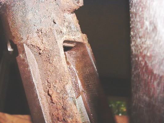

    Ed's pictures show what condition the rifles got into in Malaya. It was extremely harsh - with a capital H - on weaponry, kit and men. But once they went through the big Base Workshop system, they'd come out like new. The worst rifles were those blued with the pre-phosphate 'controlled corrosion' method of blueing. Once those rifles (and pistols, the little Enfields were the worst) got within 100 miles of the edge of the jungle or swampland, they'd start to what we called 'bleed' in that you'd start to see rust bubbles forming as if from nowhere. A bit like a Leyland car or MGB wing/fender bottoms. It was downhill then as nothing would stop it, not even the hot oil bath. But once they were call-in and stripped, beaded and phosphated, then they'd go on for a long time. Of course, 'a long time' is relative but every 3 or 4 years or so would be a reasonable wear time in those climates.
    I suppose those rifles that were sold off in the late 70's onwards from the Pacific rim nations will all be pretty dire now, not having the huge Base Workshop facilities that we had and were able to provide. We did all of the FMP and Singapore Police weaponry, the Fijian Army (quite good kit). The man running the programme for the Singapore police was a great bloke to us called Mr Soliano and very often brought in a crate of Tiger beer or whatever and treated us to a Chinese meal out in Robinsons one Christmas. Has anyone got a Singapore Police Bren marked SPF by the LB serial number. The woodwork got a bit of a battering in the jungle and in the lorries but the hot liseed bath made it as waterproof as it was ever going to get.
