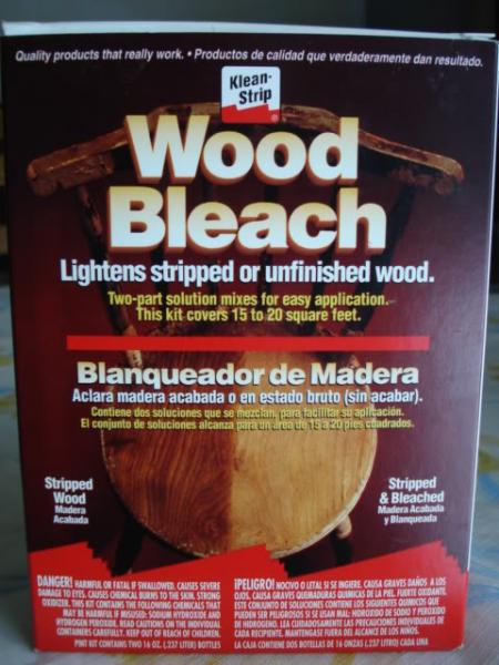

    Bill,
    I just stripped the old finish off a Type III CMPicon Rock Ola stock. You had to be superman to see the boxed RMC with CC below. After using a 2 part wood bleach solution the markings came out very nicely. You can now see them from any angle.
    I've have one more oil coat to put on it then I'll post some pictures.
    Cheers,
    Charlie-painter777
    Here's a RMC I Cut Hi-Wood Korean return I stripped and used the same wood bleach on....

    Try that wood bleach on a stripped stock. It won't harm any markings, it will really enhance them. Even if you color the wood it still naturally darkens in less than a year.
    When Stripping a stock with paint on it. You've got to use a HOT stripper.
    ZAR Paint and Varnish stripper is the best I've found, it's a semi-paste. After stripping, to get the last of the paint from the wood pores.....Soak another coat on the entire stock and wrap air tight with heavy plastic. Leave overnight, then rinse with a hard water spray from the hose using a stiff toothbrush to pull the last of the paint from the pores. That paint in the pores is loose after stripping but it takes spraying with the water to get it pulled out. Then towel dry and stand up straight so it won't warp. I usually clamp my stocks to a jig I made while their drying..... just in case.
    You'll be amazed at how much better markings can be seen.
