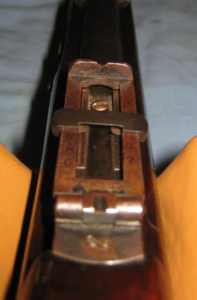

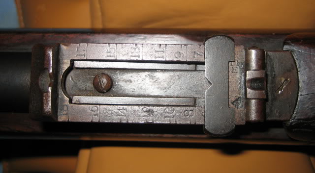

    To perhaps further illuminate, here are a couple of photos of the rear sight on my '96 MLE. Looks to me like I have an unaltered sight, yes?
    I'm guessing that means I'm in the hunt for a replacement rear sight.

    first, the original (Nov/Dec 1899 Boer War) field conversion of the MLE I rear sight, in which the sight notch was moved to the left. Second, the S A Army sight upgrade with a fine notch and windage adjustment.
