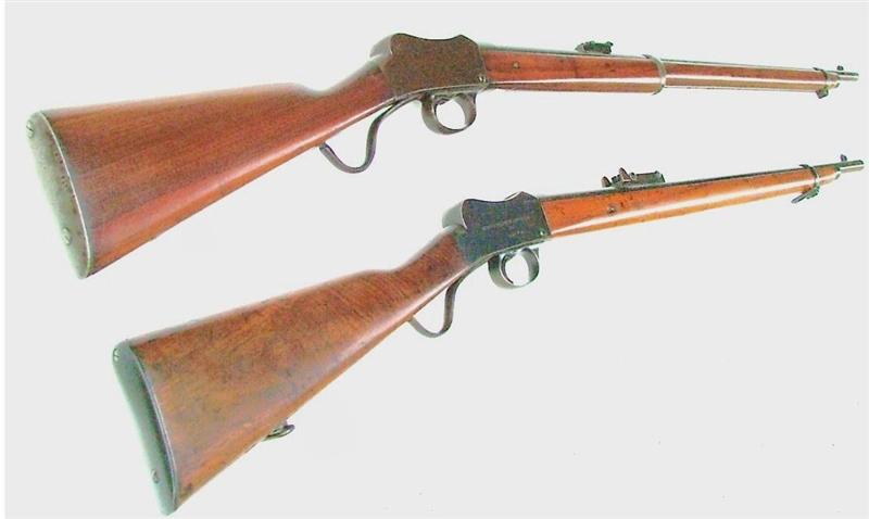

    These are Military trainers, They are nice, collectable, fun and great shooters.

    Pic. replaced.

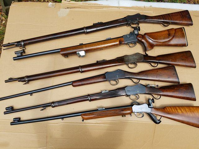

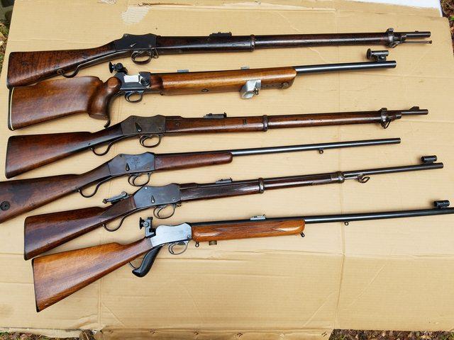

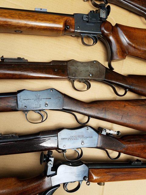

    Legacy Member FlightRN's Avatar
    Sep 2007
    05-30-2024 @ 09:08 PM
    South Carolina
    160
    06-01-2024
    12:58 PM
    Martini Henry .22 SMRC, Society Miniature Rifle Club Special, Bonehill conversions
    Good Day All,
    I was fortunate over the years and have found a few examples of .22 conversions. I especially appreciate the SMRC variations. A great associated history.
    Regards,
    Michael
