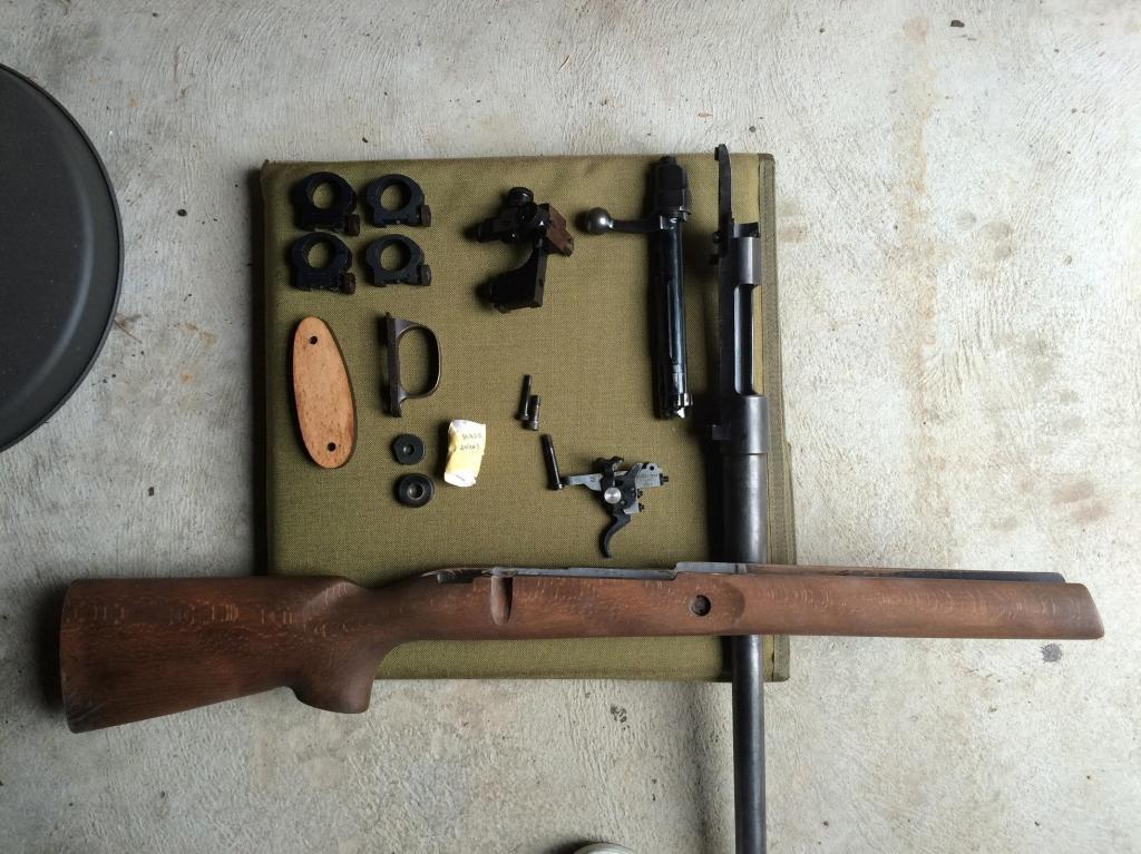

    I have posted elsewhere about this but have decided to start a thread about my current project.
    i am hoping to put together an accurate repro of the Parker Hale M82.
    i have started with a whole bunch of parts as shown below:
    In the Photo clockwise from top left:
    PH RALS 3 and RAHS 3 Rings (1" rings, correct are RALS4)
    PH 5E Rear Sight
    PH 1200 Bolt
    PH 1200 Action with cruddy barrel
    PH 1200TX stock , same shape as M82 without magazine inlet.
    PH 1200 Trigger
    PH Action screws (2 X hex head. 1X Slot)
    PH 1200TX Trigger Gaurd
    1 X Stock spacer
    Parts i need:
    Sling Swivel action Screws and rear sling swivel
    Mauser Hinged Floorplate Trigger Guard
    Mauser Mag spring and Follower
    PH Front Sight Tube and Base.
    PH RALS 4 Rings
    2 X Wood Stock Spacers
    1X Recoil Pad (olive)
    2X Stock Recoil pad screws short
    2X Stock Recoil pad screws long
    1x Handstop rail and Handstop with swivel
    1X PH 1200TX Barrel or similar barrel turned up
    PH Bases number BA 22 and BA 28 :
    so far i am pretty happy with what i have gathered. most of the parts i need are available it's just a funding problem at the moment.
    also things like the handstop rail i have found with the handstop but the shop wont ship to Aus so that will be an added cost of freight fowarding.
    The barrel is going to be the biggest cost and issue for me. right now i would be happy to just pull the current one off but i dont have a mauser action wrench.
    i will try keep this thread updated as i go along, if anyone has any hints or tips on the project that would also be appreciated.
    thanks
    Anthony
    ---------- Post added at 04:44 PM ---------- Previous post was at 04:44 PM ----------
    a quick mock up of what i have so far:
