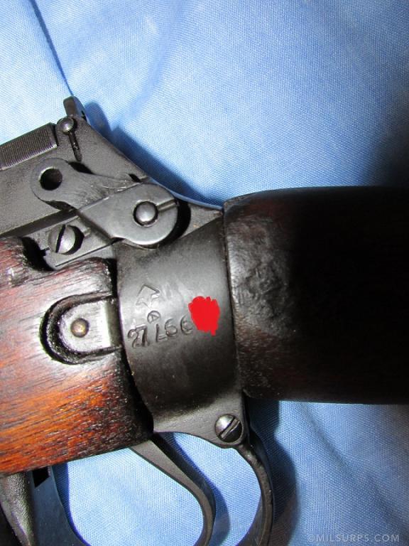

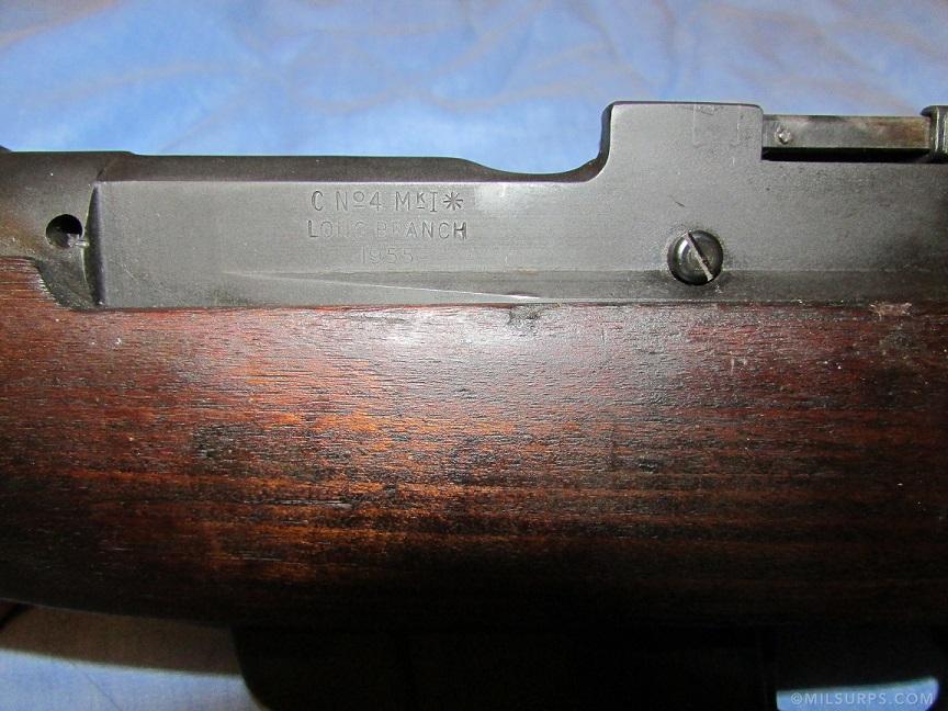

    1. The receiver is dated 1955, but the serial no is 27L66XX. Do you think this number is about right ? Or do you smell a rat ?

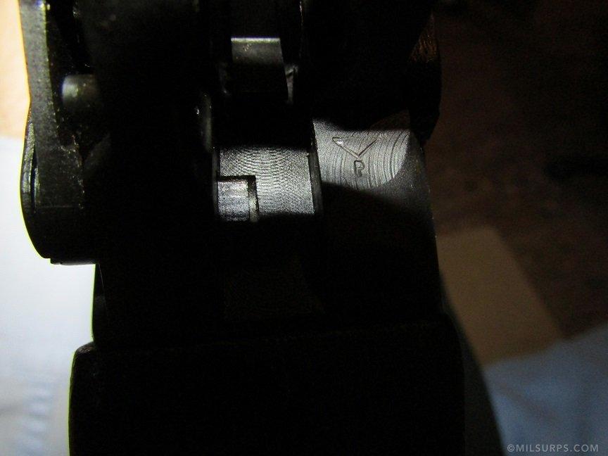

    2. At the back of the receiver on the right hand side...there is what looks like a broad-arrow P mark (see picture) ....or is this the Long Branch mark ?

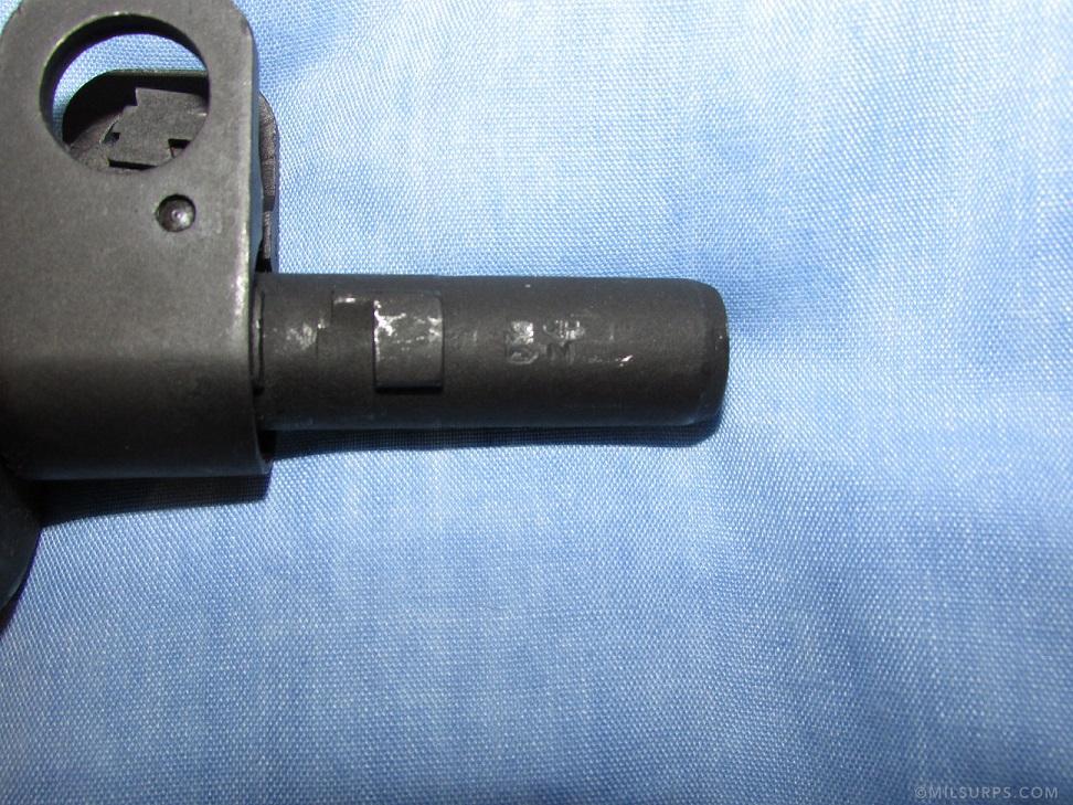

    3. The front sight post...and also the safety selector toggle switch...are stamped with a capital S...is this the Savage USAicon stamp ?

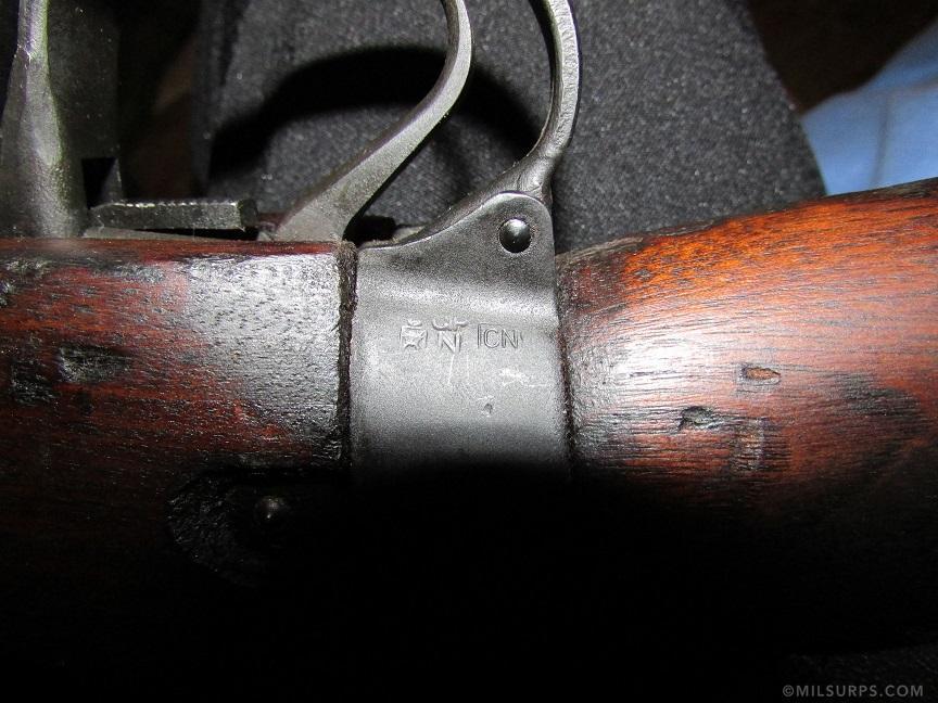

    4. There are two tiny stamps just above the trigger on the wrist/rear band....does anybody know what these are ? These might also be on the very end of the barrel...it’s hard to tell because they are tiny.

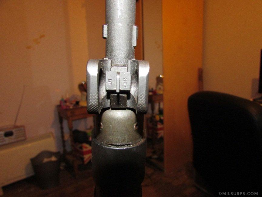

    5. The rear sight seems to be one of the MkIII flip up type ones....but I thought that these ladder/flip up sights were not fitted to Mk1 * (star) rifles as it was cheaper/faster to produce them with the smaller peep-hole type sights ?

    Nice rifle. I like the oddballs! I think it's a Canadian Arsenals Limited rebuild with a 1955 replacement receiver and Parkerized finish. It's numbered the same as the receiver that was replaced. More proof that replacement of receiver/bodies was carried out routinely in Canadaicon. I've seen several over the years including a couple I still have here in my own collection. The butt markings and proofs are Italianicon, correct? Many of these rifles were supplied to European countries post WWII and maintained until their release from stores in the past 20+ years.

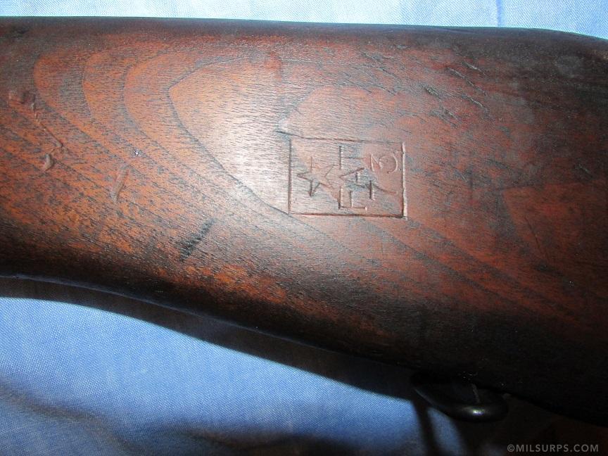

    It looks like one of the Ex-Italian Navy release arms. They recently released some thousands of both SMLE's & No4's. They are generally super rifles, yet sadly many of them that have found their way to the UKicon will end up being deactivated. The 'FAT 73' stamp on the butt is Italianicon, I believe. It is only a guess but I suspect the 73 is the date it was inspected/refurbed & stamped, & I think the T may indicate the Terni arsenal. But this is supposition from what little I know of their provenance. No doubt someone will chip in if they know more........
    I have bought quite a few SMLE's & a few No4's from this source over the last couple of years. I gather they are now nearly all exhausted.

    FAT =Fabrica Armi Terni

    You scored bigtime, you have a legit, 1955 Canadianicon Arsenals Limited (CAL) "replacement receiver".
    The "arrow over P" is a 1950s thru present Canadian Gov't proof marking, also seen on the left receiver side with the Canadian Arsenals Limited "CA" stamping. It is variously deemed to be a "rolled maple leaf", or a "webbed crowfoot"/"broad arrow".

    I had no idea that Long Branch was still in operation in 1955 (I thought their last guns were Korean War). When did operations cease?
    By coincidence, a pair of these from 1950 are for sale on Guns America:
    Pair of Lee-Enfield No 4 Mk I* Long Branch rifles for sale (987367300)
    Here's the description:
    2 consecutively numbered Lee-Enfield No. 4 Mk I* .303 Britishicon rifles. Manufactured by Canadianicon Arsenals Limited, the successor to Long Branch and with serial numbers 93L00x4 and 93L00x5. Many collectors consider the Long Branch (C.A.L) rifles of the 1950's the highest quality examples of the No 4 Mk I rifle, with 1950 dated Mk I*'s commanding special premiums.
    Both rifles are in excellent condition and show little evidence of use. Furniture is fine with minor marks in the wood. Fit and finish are excellent. Finish is nearly 100% with absolutely no rust. Breech both is matched to action assembly. The 5 groove bore is bright and shiny, excellent rifling. C Mk3 rear sights are on both rifles. Left side of the actions are marked "C No. 4 Mk I*, LONG BRANCH, 1950" All observable parts are "Canadian Arsenals Limited" marked. Small import mark "C.D.I Swan, VT" on underside of barrel muzzle.

    I think 1950 or 51 was about it for LB but there were unstamped receivers about.
