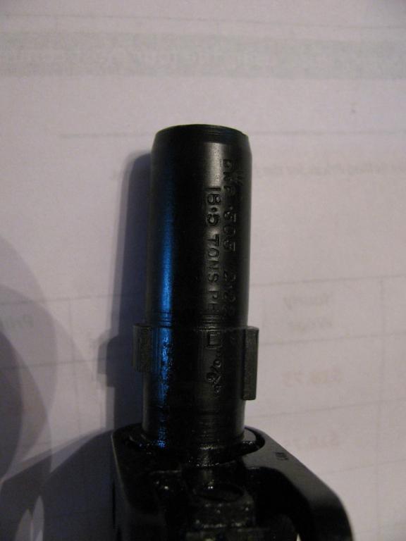

    I have an Enfield No4Mk2, for which I would like to find some information.
    When and where was it manufactured etc... ?
    The only markings on the action are No4Mk2 and the serial number: N1329
    (yes the ejector screw and the rear sight are missing, I removed them when I was looking for markings)
    The action, bolt and magazine have matching numbers.
    Here are pictures:
    I see an "F 56" stamp on the barrel shank, does this mean the barrel was produced in 1956, and the rifle came from the very late Fazakerley production?
    Thank you for your help.

    I hope someone will also chip in and agree that this was a last gasp of the industrial strike bound Fazakerley factory to become commercially viable by selling off new No4 Mk2 rifles to the commercial gun trade. The gun trade would allocate their own serial numbers. The F56 is the date of manufacture. The mark directly below the H20 mark, is the UKicon Military proof and below that is an arrow with the Fazakerley section examiners mark (05/FD?) - known at the factory as 'team leaders'.

    Thank you very much, finally I got a lead.
    This is probably as good an assumption as would be reasonable. The Mk2 serial numbers in 1949-54 began with PFXXXXX, then the 1954-56 models began with UF. Few were made in 56. So yours may be made up with the random parts that were left in the factory that weren't under contract. The serial number isn't common.

    Thank you for all the information.
    Do you have any idea, how many of those rifles were produced during this period?
    Does it mean this is a rare variant of a No4mk2?

    I'd guess that these were rifles made of "scraps and spares" that were left at the end of production at Fazakerley in '56. You can see it has a modified fore-end using a Mk1 fore-end adapted with a filler plug to a Mk2 trigger. If there are any production records on this "tail end of production" they aren't well recorded, although someone might have some recollection or records.
    As for rarity, yes you have a "rare" version. Whether it is "valuable" is a totally different matter. For example, when Long Branch ceased production in 1950, they continued to produce Dominion of Canadaicon Rifle Association versions from scraps and spares and limited production into the 1950s which were target rifles, and have thus have value today. Unless there is something unique and valued about your rare version, there may not be a market for your unusual gun. If there was a verifiable "provenance" or "back story," then it might have some value. Otherwise, don't think you just won the lottery. Suggest you hold on to the rifle until someone emerges from the nooks and crannies of Lee Enfield history that can give credence to your find, then it might accumulate additional value.
