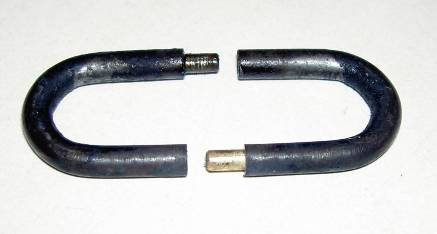

    If I remember correctly, Ordnance made available the steel sling loop from the rear of the return spring cap. They were a two part item, ready shaped to fit with a male and female end that joined together externally. Then the the other ends slipped in the opening of the return spring cap. The M&F parts were brazed together, made good and sent through the phosphate plant. We also used these replacement sling loops on the Navy Lanchesters that came through the workshop
    Lots of other casing bits that weren't usually available as spare parts were available to us including finger guards and foresight protectors. Great little guns - the Rolls Royce of SMG's.

    I came across one of those replacement sling loops when I was converting an endcap to a spigot type for the plastic butt. I wasn’t sure if the loop was a repair or a change in manufacturing. Now I know it was a repair.
