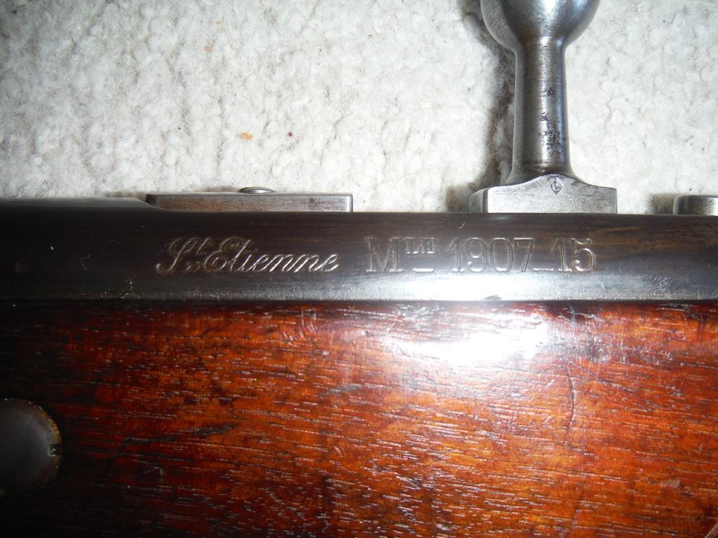

    I'll throw a picture or two of mine up. M1907/15 manufactured at St. Etienne in 1916. Metal is all matching except the bolt head, and the stock is mismatched (though it is a 1916 manufacture stock). It has received the Balle 'N' modification. Also pictured is some 8x50r Lebel I loaded with some surplus Balle 'N' bullets, those bullets are pretty much all shot up now. It also preforms excellently with the .323 diameter 198 fmj boattails PPU makes so that is what I will likely only be using in the future.
