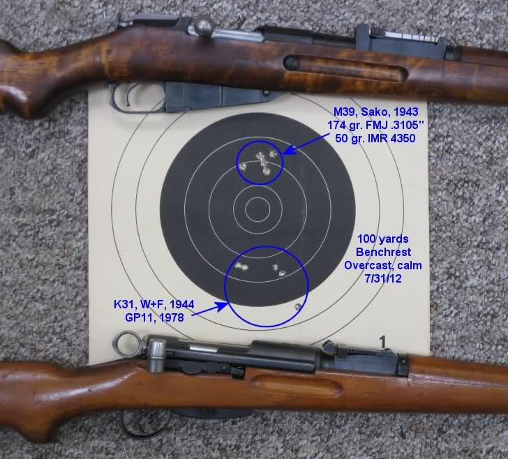

    Given some of the assertions in the previous post, I suspect Bruce and others might find this old article interesting -
    Attachment 75092Attachment 75093

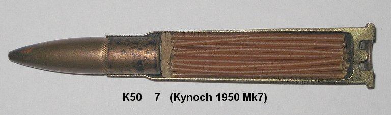

    Good point. Hence the way the ammo was manufactured.
    Especially interesting to get back in "intact", is the wad, which, as clearly shown, is about the right diameter to sit nicely a few mil. back from the shoulder.
    See pic.
    Has anyone stripped down any of the WW1 / WW2, US-made stuff loaded with granular powder, to look for a wad?
