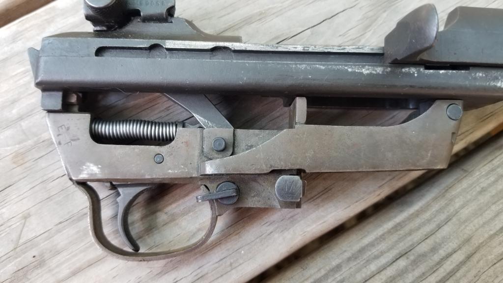

    What Trigger Housing Marking is This?
    Fab/Brazed Housing,
    Seller describes it as a E-P stamp.
    First letter sure looks like a E doesn't it?
    Charlie-Painter777

    Could it be a faint 'BE-B'?

    BE-B: IBM or Standard Products . B-EB: IBM
    I've seen this rumor before and it's pretty well been shot down by Brian. I mean how would have known there were going to be transferred housings and why would they mark them differently? It's just a situation where IBM's Endicott plant used two different dies.

    So, is it a lightly struck one of these? The spacing looks the same. - Bob

    I believe same style............ But as if the first B is completely missing from the stamp.
