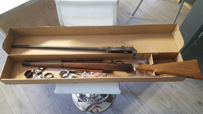

    As many have seen, I was fortunate enough to stumble on a No.4T barreled action and am almost ready to start the restoration.
    Big question is, once colimation of bracket is complete, would I be commiting cardinal sin by stamping the rifle serial on it?
    Sane question goes for scope serial on butt.
    I know the general idea is once I'm long gone or rifle is passed on it may be sold as a legit T sniper, but would it be so incorrect??
