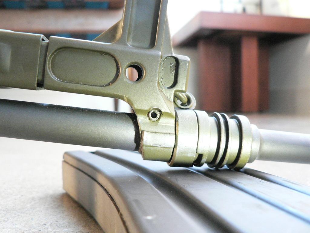

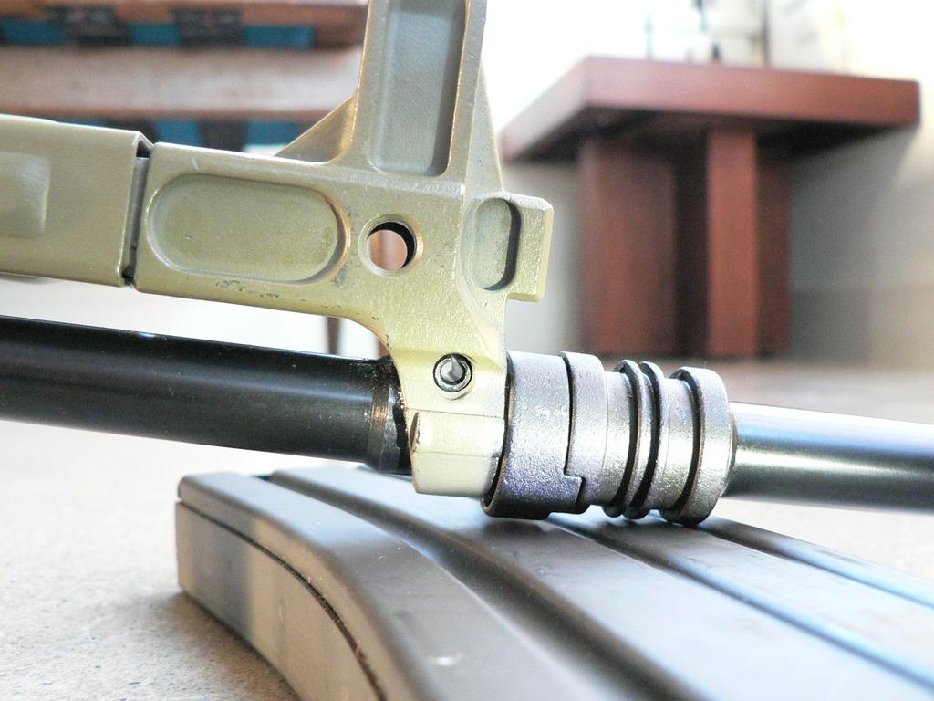

    We'll start with the 3 pronger flash hider thingees.
    This first picture has the HMG produced jobber in focus:
    It works fine and looks nice but it's nowhere near what an original looks like. It came loose the first time I was out at the range so I put it back on with blue Loctite and it hasn't come loose since.
    The one on the MCM rifle is an original:
    It's clearly different than the HMG offering and, because it's original, it's more neato!

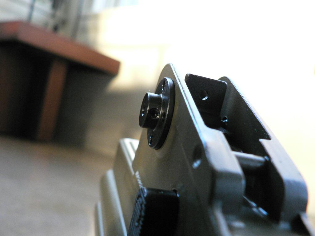

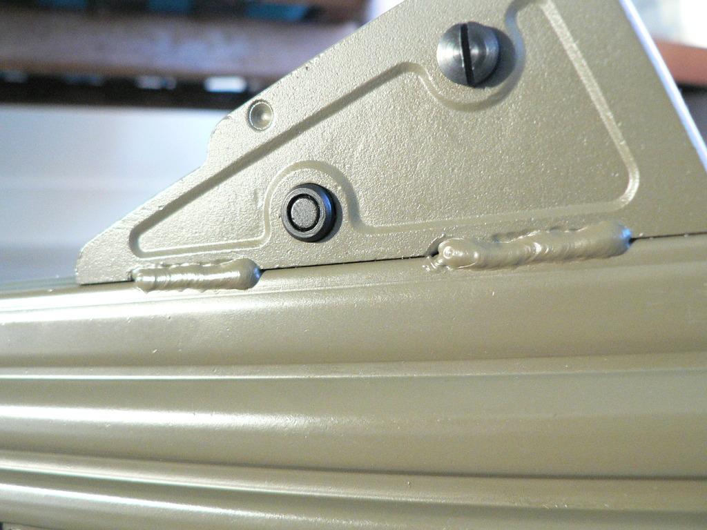

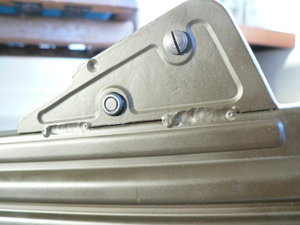

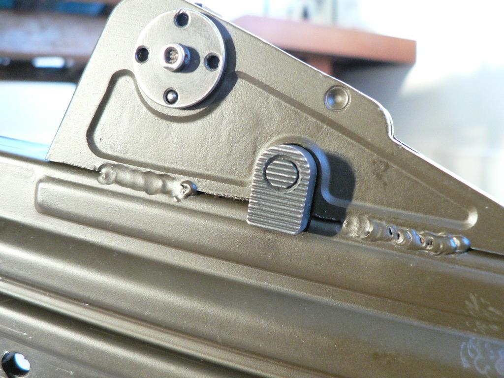

    Here we see the new made MCM front sight post on the left and an original on the right:
    Notice that they have made it thinner for more precise aiming. They have also modified the design so that the adjustment detent engages only along the bottom of the post instead of running up along the side. I haven't taken it apart but I assume there are more positions built into the post so that it can be dialed in more accurately. It's a nice feature.
    While we are looking at sights, here is an original rear sight aperture set to 200 meters:
    And the MCM aperture set to 200:
    Notice that it's larger. That's because MCM has reamed it out a bit to give you a better sight picture. It's a small thing but trust me, it's nicer with the slightly larger aperture. The 400 meter apertures are both as they left the factory. I wish MCM had painted in the "2" and "4" like it was originally but they did not. It's an easy fix though.

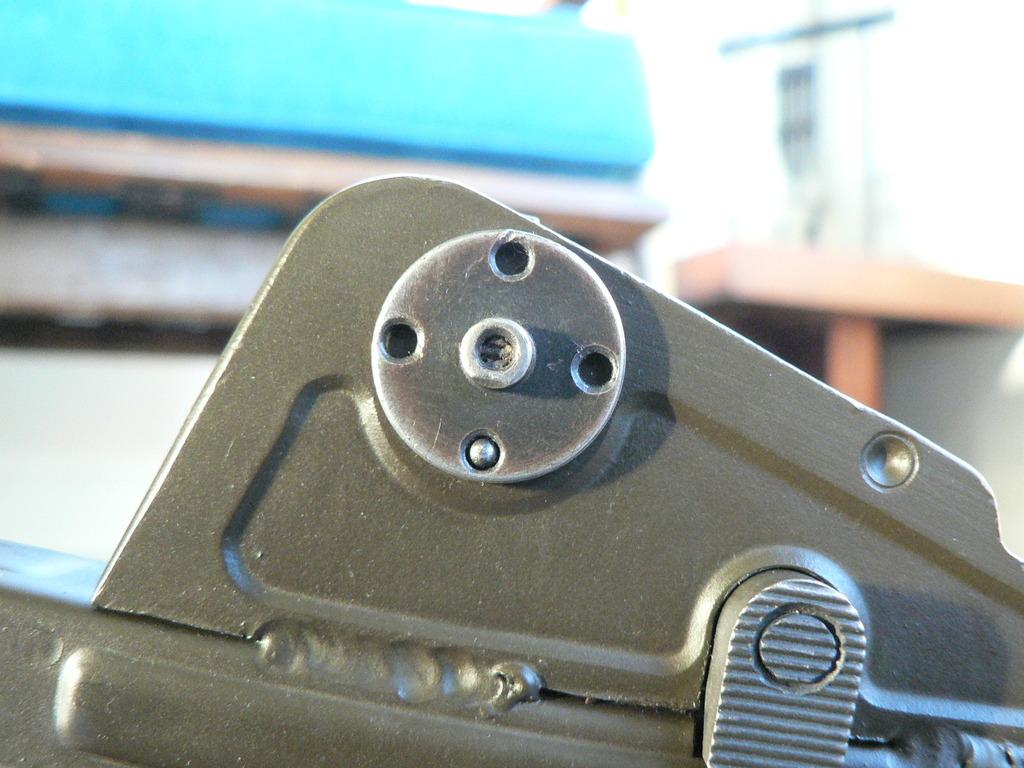

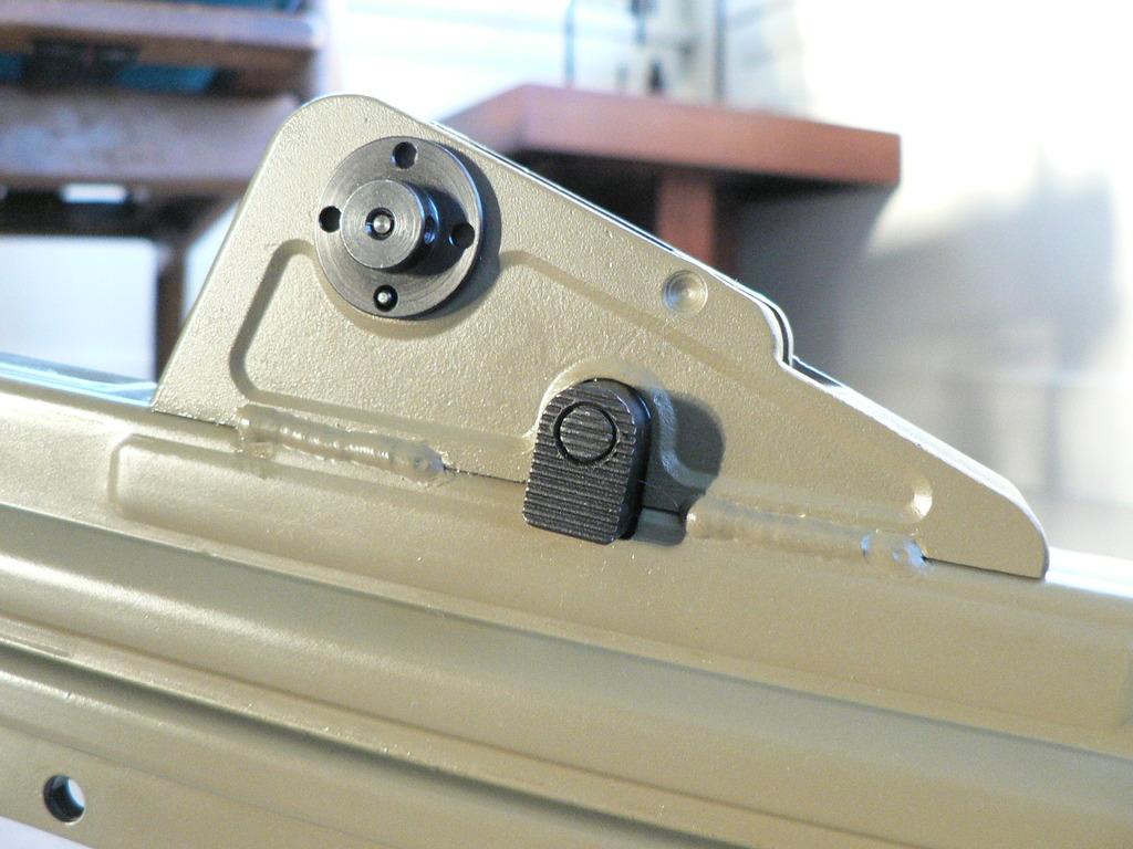

    An interesting difference between my HMG and the MCM is the fact that the MCM has retained the divot in the rear sight base allowing the mounting of a scope rail while HMG filled this space in.
    Now, it's entirely possible that HMG had nothing to do with this and the sight base on my HMG rifle may simply have never been cut for a scope rail to begin with. I simply do not know. Whatever the case, I can mount a scope on my MCM rifle with the proper scope mount but I will never be able to do so on my HMG. That's OK though as I really don't plan to mount a scope anyways.
    But I'm getting ahead of myself. I'm supposed to be starting at the front and working my way back. so let's get back to that plan, shall we?
    Here we see the cocking handles. The MCM, is at the top:
    Other than the fact that the MCM is either refinished in a darker phosphate or has a better darker original finish, notice that both plastic bits, while original, are different. The plastic on the HMG slightly wraps around the steel front part of the handle while the plastic on the MCM stops at the handle. One is not better than the other and it's an insignificant thing but it is a variation. Neat!
    Here, we see a comparison of the welds on the two rifles. To be specific, we are looking at the weld where the cocking handle meets the front of the receiver. The MCM is at the top:
    Notice that the HMG has a better weld here. Not only is the MCM weld aesthetically inferior, but it also shows an ugly void. I'm sure it's plenty strong but it is unsightly. In fact, it's the most unsightly weld on the entire rifle. While we are on the subject of welds, let me say that, in my opinion, the rifles are equal. In some places the HMG is better while in others the MCM is the winner. I'm not going to call out each and every detail but I am going to show the same areas on each rifle so that you can make up your own mind about who has done the better job. I will say that I think both exhibit sufficiently strong welds and I have no worries about failure on either rifle.
    Here is a shot of both rear sight bases from the oblique front with the MCM on the left:
