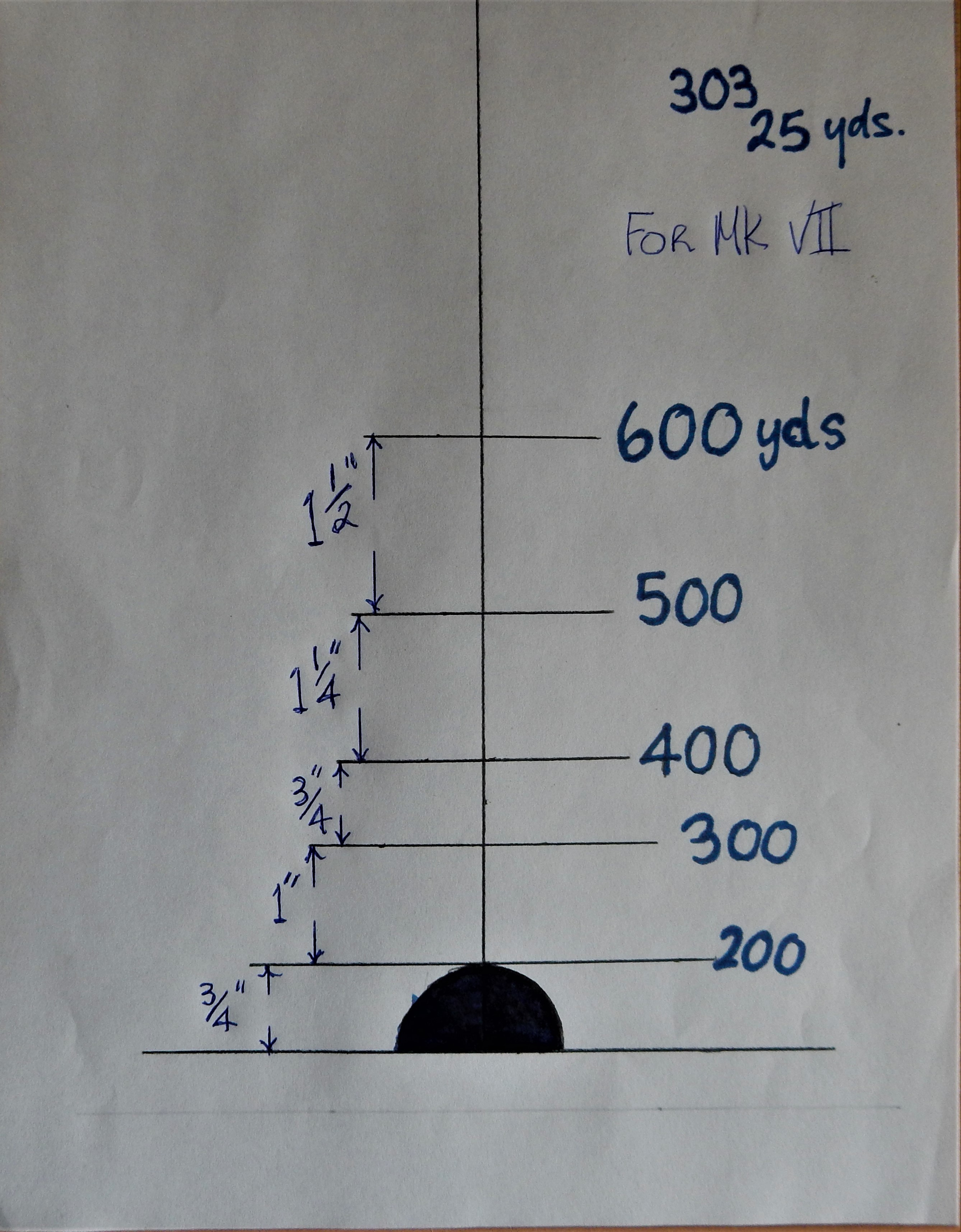

    At 25m/yds the POA should be at least the centre of the scope above the centre of the bore in height. If the scope is not in line with the barrel ( no hope )The way to check this is to fire a shot then wind the scope up 100 fire another and so on. This will show if the scope is parallel to the bore or the scope is not level in the rings. The bullet holes should rise in a vertical line with no bias. There are 25 m/yd zero targets with range hashes for the distances marked in the vertical plane.

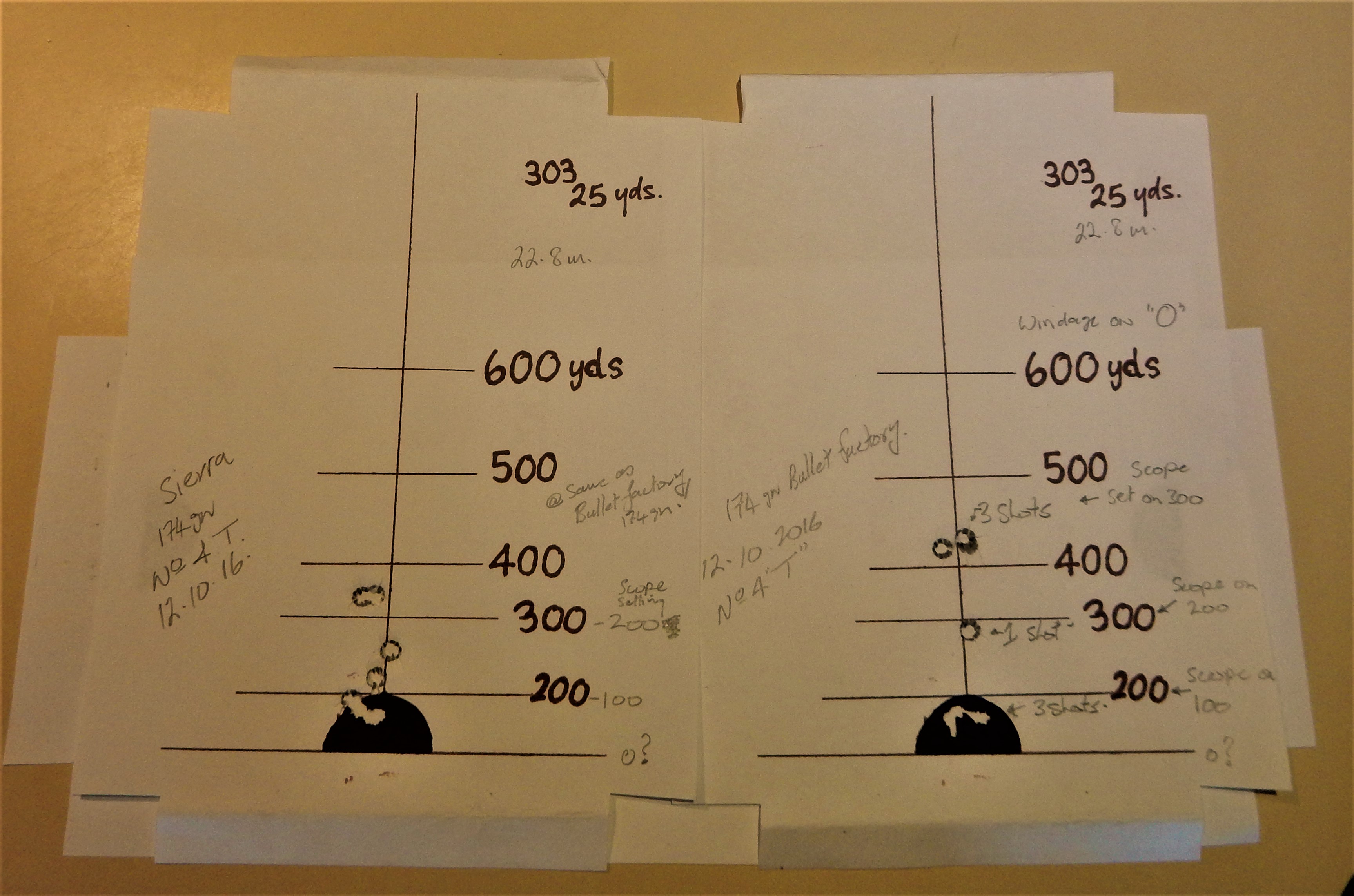

    Ok here is the correct sighting plate/target for the 303 MkVII to be set at 25 yds (22.8m) so I think the Privi fly pretty close to the MKVII but if your using SMK's it may be close but not perfect.
    See my targets the only real way to get the scope colminated to what you always going to feed it is get on a range at the distances your going to shoot and do a DOPE chart up for yourself its what I have had to do and many others here have had to do.
    Because nothing out there today fly's the same as Ball MKVII ammo and shooting that vintage stuff today will yield you spurious results P.O.F ammo is notoriously bad (Don't ask!) HXP Greek ammo if you can get it but again stuff is getting hard to find costs $'s and can be collectible.
    So more range time is no bad thing, go to it bloke and keep us all up dated.

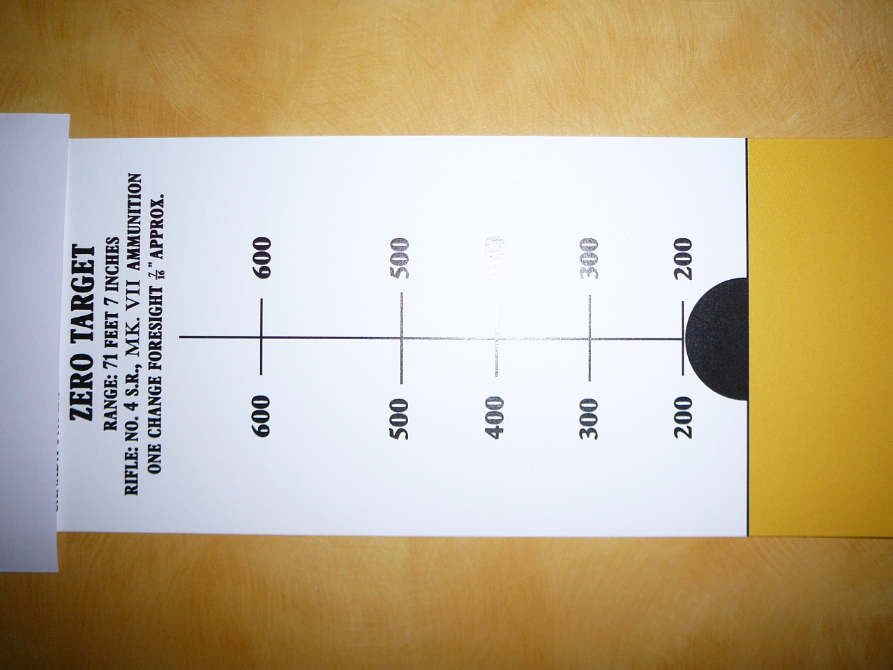

    I believe this is the target you are using..
