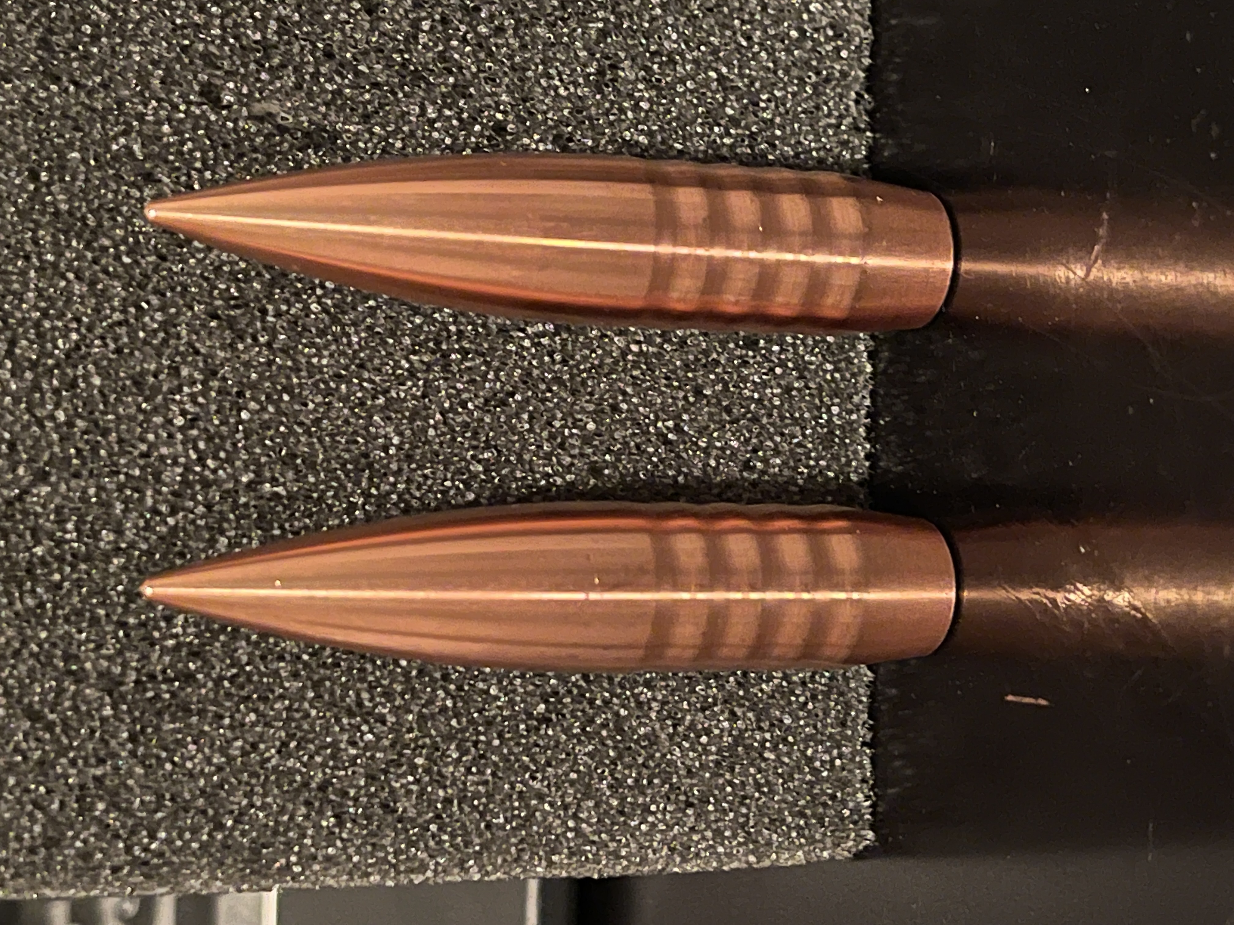

    Looking forward to seeing fresh ammo...How did you say you were going to make bullets? Turned copper solids?
    Legacy Member rescuerandy2's Avatar
    Jul 2012
    Yesterday @ 04:29 PM
    Miami, FL
    301
    05-25-2024
    01:49 AM
    Solid copper from Hammer bullets. I had to purchase 500! Randy
