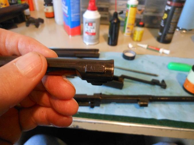

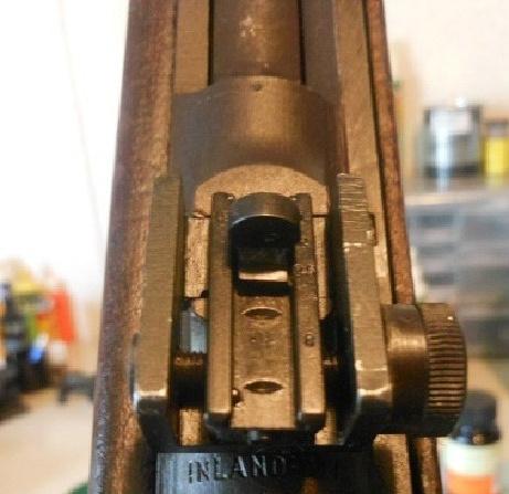

    I haven't learned enough to identify different types or series of parts, but here are the markings I found this morning, along with some more photos. The wood.....should I get the shellac type coating off & give it some oil? Or leave it as is? Not even considering stripping it, but denatured alcohol works wonders on crappy shellac finishes. Anyway, here are a few markings, then some photos. Also got 2 mags with it. An IA 15 rounder, and an A1 M2 marked 30 rounder.
    Handguard does have Q-RMC
    AI on bolt lug
    WMB on hammer
    EPB on safety
    Rear sight has a shield with an H in it
    Gas block has what looks like P-1
