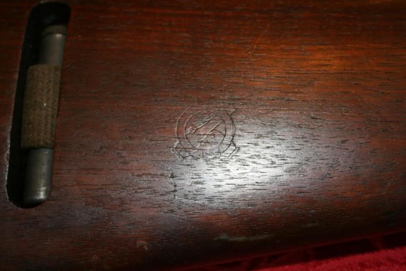

    I found this at a small local gun show this weekend.
    It is a nicer original mid 43 rifle.
    Sometime along the line the 300 yrd flip was modified.
    I have seen this on a few other original carbines.
    The story I have heard is it was easier for sighting at night.
    You can post here or pm me if anyone has any questions.
    Here are some pics and a link to the photobucket album.
    inland 522K pictures by usgicollector - Photobucket
    Dave

    Very nice, I can't quite tell, does the rear sight look like it has been moved to the left?.....Frank

    The rear sight is to the left, but the staking marks are right at the right side of the sight.

    Very nice and congratulations. I have a Rock-Ola that is believed all original and has the same modification to the rear sight as yours, except on the 150 yd. aperature. This mod creates wings on the rear sight that align with the wings on the front sight and give an uncluttered and centered picture of the front sight post, making for a very fast combat target acquisition. I would be very reluctant to replace as it's part of the carbine's history. After owning for a couple of years, the small letters B AA were found carved/written legibly next to the trigger housing, though difficult to photograph. Thanks for sharing your find. They are still out there.

    Which carbine are you talking about Bill?
    Mine or the rock ola? I found mine at a show that had about 20 tables.
    It was so dirty it looked like it sat since WWII.
    The grease on the slide was so dry it took over a second for the action to close from the bolt being locked back. I do remember the rockola being talked about before and itbwas the carbine I was talking about in mine original post when I said I had seen others like it. I also remember a few loose flip sights over the last few years being modified like that.
