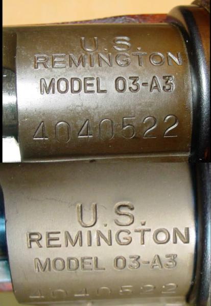

    I kind of think there's more than one reason for the 'green' tint, but it sure isn't worth arguing like that about it.
    Here's an example for the subject:
    This receiver had been in storage for a very long time.
    I cleaned it with denatured alcohol and much of the green wiped off. (?)

    I think that the DNA may have dried out the metal when it evaporated???? I am curious if it looks green again when you coat it with oil??? Do you recall if there was something on the cloth? If there was, that is the stuff that should be analyzed for content.
  14. #10
    (Deceased January 2016)
    Harlan (Deceased)'s Avatar
    01-04-2016 @ 04:42 PM
    Texas - USA
    66
    3,727
    Harlan
    05-05-2025
    07:44 AM
    Ed,
    No, the green tint didn't really return after it was oiled (To my eyes)
    and yes, there was residue on the cloth and Q-tips. I think this was just a build-up of old cosmolineicon. It was kind of like a varnish.
    The parked area below was covered with the same dark greenish color before cleaning and oiling.
    This is before cleaning the parked area -
  15. The Following 3 Members Say Thank You to Harlan (Deceased) For This Useful Post:
