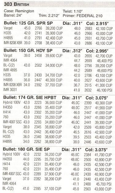

    Has anybody done some real accuracy testing of the 174-180gr bullets at the standard 2440fps+/- ? The IMR4007SSC looks interesting. I'm still using IMR4064, mostly because it works well enough out to 700yds or so.
    I'm stupid because I like to be able to just "dial the numbers" for distance. Too much trouble keeping "40'leven" range books organized....
    "American Classic", yeah, well, you know how them 'mericans are- taking credit for all the good stuff...
    jmoore, I'm in the same boat. I decided real early on to come up with a load that would keep true to the sights of my Lee Enfields out to 500 yards at least. I started with ADI 2208 (Varget) and looking at the listed muzzle velocities I settled on a starting load of 40gn behind Sierra Matchkings in (yep, you guessed it ) HXP cases- hoping to be close to 2440fps. I haven't checked the speed, but the load has proven true out to 700 yards, shooting same POI (but half the group size) as the HXP milsurp.
    A couple of others using thinner walled/ lighter based Remmington cases are using 41 or 42 gns and getting the same results, so case capacity is your main variable, I'd think.

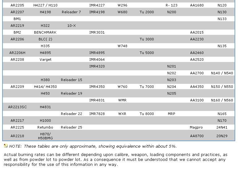

    Please correct me if I'm wrong but I was under the impression that Varget is what we call AR2206H?

    Quote Originally Posted by Lithy View Post
    Lithy
    Well old buddy, looks like you owe me a jar of vegemiteicon
    From YOUR Australianicon ADI website.
