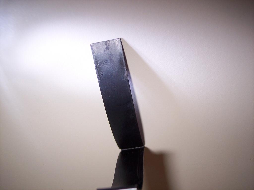

    Here's the spring that's in my Eddystone marked with an "E". Hope this helps.
    Imageshack - m1917eddystone148.jpg [/URL]

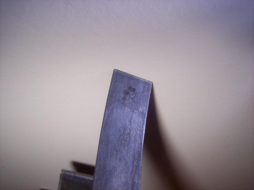

    Here's a Remington M1917 spring marked "R".
    Imageshack - spring006.jpg [/URL]
