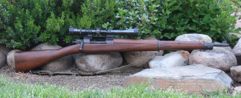

    1943 03A3 with 4 Groove Barrel.
    Got to the Range today to test a Pig Hunting load. I will be heading to
    Fort Hunter Liggett in 2 Weeks.
    Weather was near perfect, 84 Degrees and just alittle breeze.
    100yds. off sand bags
    I Love this Rifle

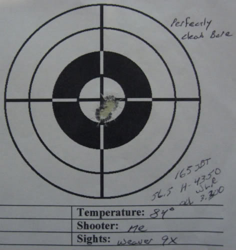

    This was the first 2 shots out of a Perfectly clean bore, Sierra 165SBT
    I was Shocked they were dead on

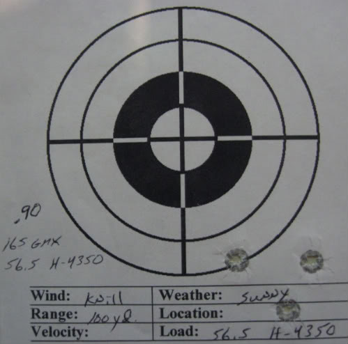

    This is Hornady 165 GMX all Copper bullet, which is required to hunt at Liggett.
    This is really good grouping for this bullet, I have not been able to get it to group
    very well in any rifle, so I will be trying Barns TTSX next.

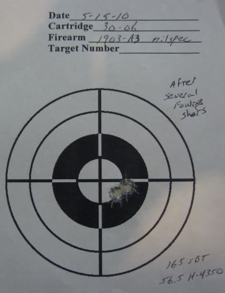

    This is the last 2 shots, again the Sierra 165SBT
    These last 2 shots were taken with a Hot Dirty Bore.
    15 rounds were fired between the first 2 and the last 2 rounds
    Again I was totally Shocked, still Dead on

    I looks as if the pigs are in for a 'bad weekend'

    Nice looking firearm. It is getting to be range time here too.

    Nice shooting Hylander! I'm waiting for a K3 to come in for a sporter I'm working on and I'll be headed to the range, too!
    Hey, isn't that one of those no D&T scope mounts?

    Yep it is an S&K no D&T
    Works great and you can return the rifle to original in about 15 minutes
    with no damage
