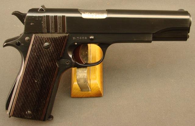

    B7908 Was this pistol made early enough to be Britishicon proofed from WW2?

    I think so. IIRC there were a number purchased by GB during WWII and were "B" prefix pistols. However, I'd have to check Clawson's commercial Govn't models book to be sure.

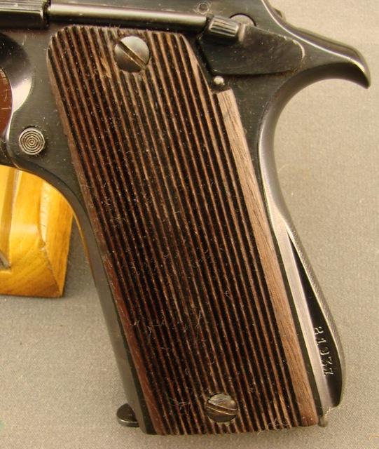

    This is SN 21937, why do some books show the Britishicon contract only up to 21000? One source says 22000

    The B.7908 is the Britishicon number. (located on the R/H side above the trigger.)
    The actual serial number of the pistol is 21937 which was located by HAFDASA on the L/H side lower rear of the grip - look at the "mainspring housing" bump. the last three digits are also on the bottom of the slide (I think) and on the barrel- either the whole S/N or the last three digits.
    There seem to have been either 8000 or 10000 pistols done for the British, so "B.7908" fits nicely! Probably 1940 or 1941, but check sources for dating, that's a SWAG.

    Official records list 8000 of the Ballester-Rigaud pistols were purchased from Argentinaicon. The pistols were shipped from Argentina to Canadaicon where they were inspected and then sent to the UKicon. No mention of proof, just inspection. Along with the pistols were 5,000 Mauser rifles purchased from Bolivia. I don't have the spec's on the rifles but can probably assume they were in 7.65 cal. as a large quantity of 7.65 ammo was also purchased.
