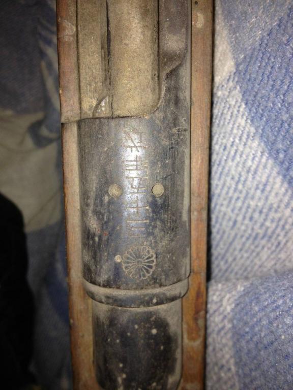

    Here are some photos of the Type 35.
    It isn't my rifle, it was posted on another forum by somebody I don't know and who isn't trying to sell it.
    I am just curious about it's value and about this model in general, as I don't think I've ever seen one before.

    02/45 last-ditch rifle using Type 35 action
    Sorry, but that is not an original Type 35. It is indeed a last-ditch "recycling" of a Type 35 barrelled action, known to collectors as an 02/45. The most obvious clue (apart from the generally scruffy look) is the front barrel band which is a late version of the Type 99 band, and not the slimmer and more elegantly shaped original band, which looked like that used for the Type 38.
    And the "original leather lace-up buttpad" may be original US, but is hardly of Japaneseicon origin.
    And the backsight is wrecked - the leaf has been torn away - you can see that the lugs for the axis pin have been snapped off.
    I guess that the 35 in green painted onto the front end of the stock was so that whoever assembled the rifles would know that it was supposed to be fitted with a Type 35 action and not some other type.
    Patrick

    Thanks Patrick,
    I didn't get the pictures until after I had posted first. The guy initially seemed to think it was a Czechicon made rifle, and some sort of sniper's special model... Then he thought it was an original Type 35... now we see that it is actually a 02/45.. I'll let him know
