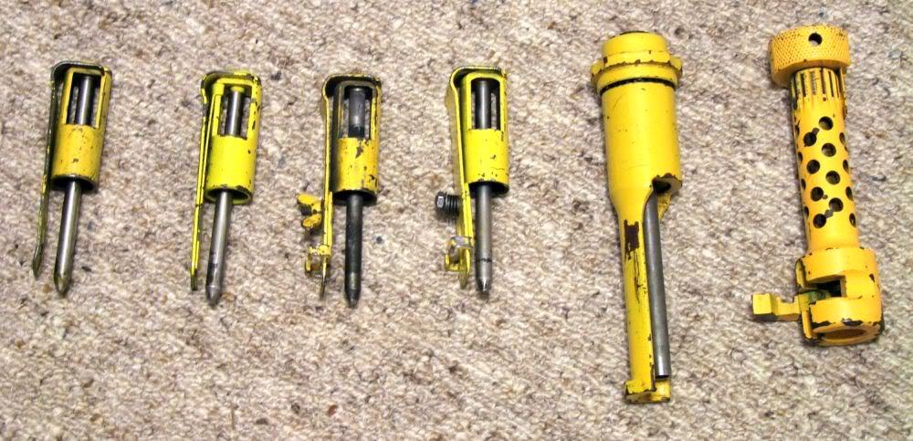

    Left to Right
    Canadianicon C1 BFA
    Canadian C1A1 BFA (also Britishicon L1A1 BFA)
    British L1A2 BFA
    British L1A2 (modified) BFA
    British L6A1 BFA
    Australianicon BFA

    Well I think I've might have found the answer to my question. From what I can see and read from the brochure it matches the L4A1 description above.
    Has anyone seen a BFA that looks like the bottom BFA in the first photo. (Right Hand BFA in the second photo)
    More importantly dose anyone have one for sale?
